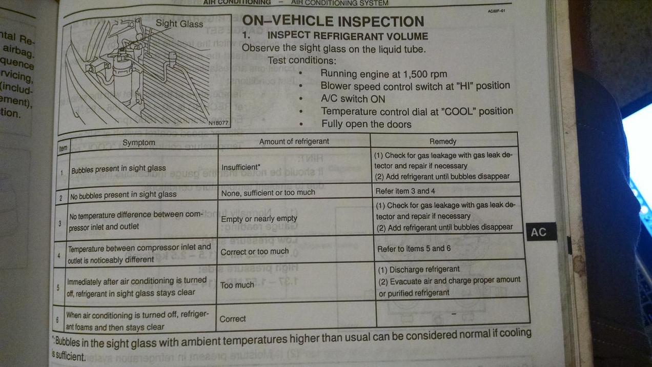

I used the gauge that came with the recharger, says it's full, also I see coolant blowing through the window. Just... air isn't really cool. Maybe just a little, same as before.
Those gauges that come with the refrigerant aren't very accurate. You might have overfilled it.
Here's a page from the FSM to help you diagnose the problem using the site glass on top of the Receiver/Dryer.

I figured the gauges would be a shot in the dark as mentioned above so I also used the sight method, the glass. Very few bubbles so I figured I'd be close. AKA have some cooling. But this page you posted above is helpful, in particular steps 4 - 6.
When the ac is on, and blowing air on the high fan setting, can you see bubbes/foam flowing through the glass window on the sight glass on the receiver dryer?
This is just a general way of finding out if the level is low and not an accurate way of measuring freon level.
Edit: I saw you already did this in the above post
