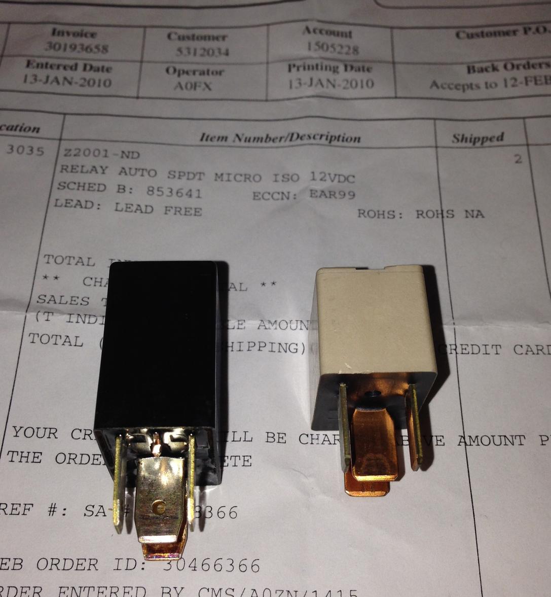

I Have a Digi-Key Z2001-ND replacement relay FS. I ordered as a spare in 01/2010 when I replaced the Mag Clutch Relay in my 04. Replacement was in my 04 when I traded it last month, over 4 years. Never an issue again.
$6 Shipped USPS First Class in padded envelope or $12 Shipped in USPS Small Flat-Rate Box. payment via Paypal.
I paid $8.27 in 2010, These go for over $9.50 ea before shipping and tax now.
Extra tab is already removed on this relay so it is plug and play when you get it. No fitment issues due to larger size in fuse/relay box. New relay is black old is white in pic.
Thanks for looking. PM Me.
