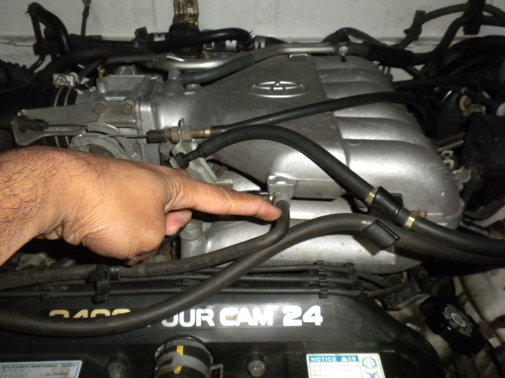

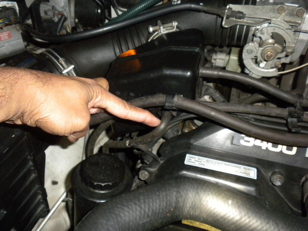

FINALLY getting the 97 back together after a head gasket swap and have everything done except for the radiator, hoses, belts and intake left to do.
However, looking at the P/S pump and the vacuum lines coming off the back of it I am a little confused as to exactly the routing they need to take. Anyone have pictures of theirs or a good post to reference?? thanks in advance!
There are two hoses
The top/short hose goes to the box (1st pic)
The bottom/long hose goes to the intake (2nd pic)
