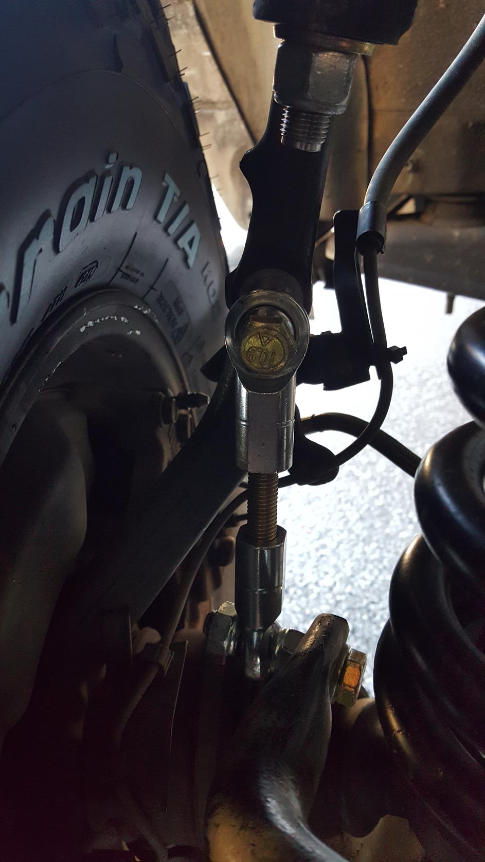

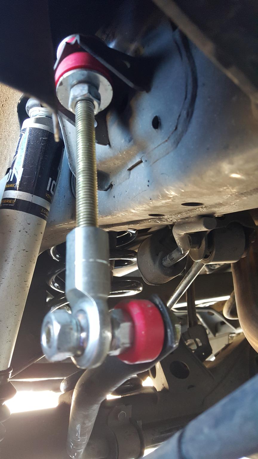

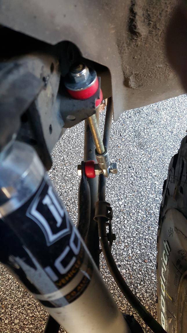

SO... i ordered the WabFab front and rear links. i know the guy has a bad rap, but he is right down the street from me. I modified the links, shortened the front link and went as long as i could on the rear and even added the rubber bushings to it. So far it works, but i am still in test mode. The factory links were too short (3 Inch rear springs) in the rear and too long in the front.
