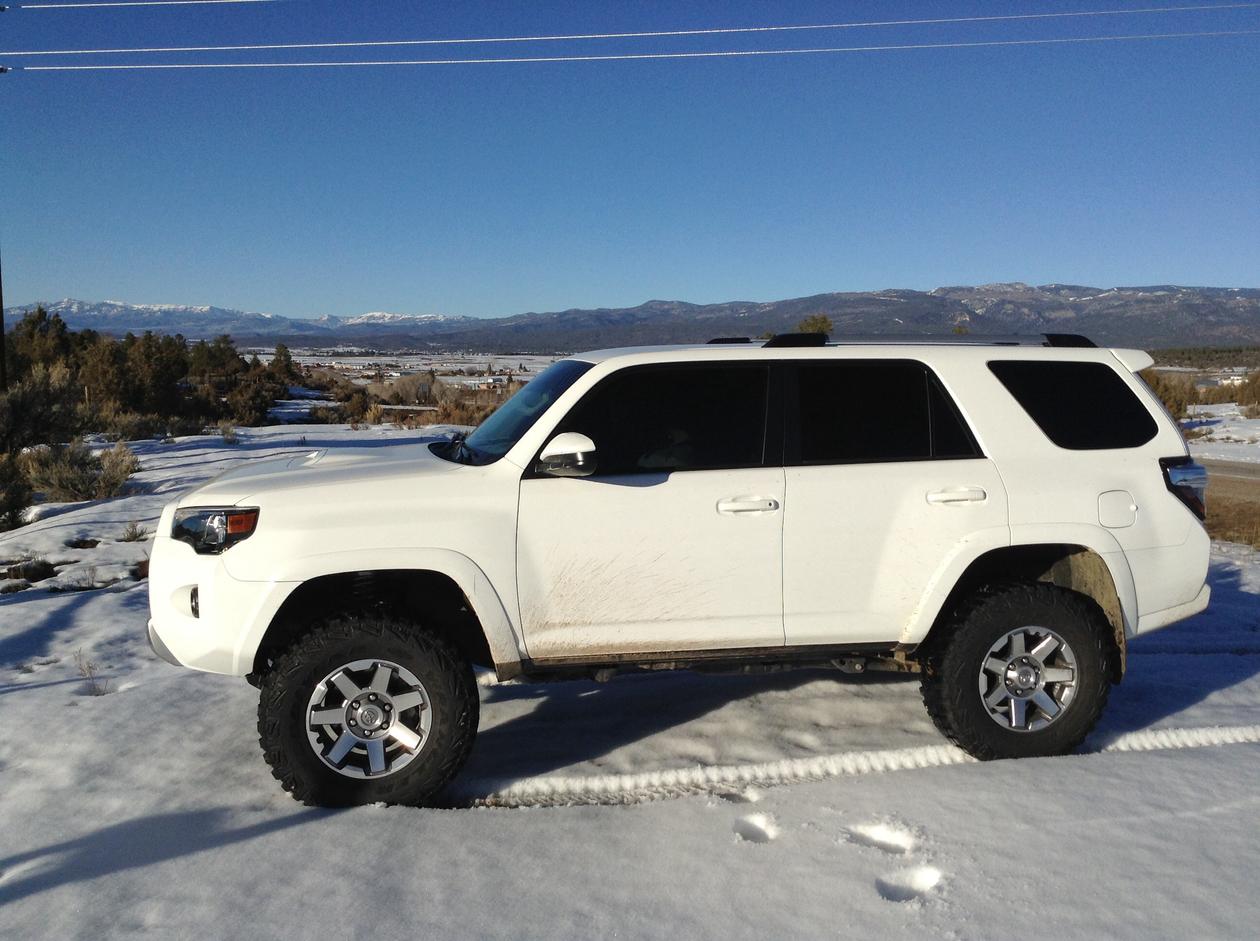

So I couldn't stand having it stock anymore and did the cheapy lift cause I had to run up to Colo again. I called toy tec and did the 5100's , their springs, tops etc and rear 5100's and 2" springs.
I re-did the exhaust while I was at it, added a dynomax 2into 1 muff and rerouted it , so it wouldn't get crushed under t-case and got rid of restrictive collector. Nothing new or rocket science.
I threw on lift real quick , did a alignment and headed north. 1200miles in 3days and I'm back home. Didn't have a chance to play in any snow, mostly cause there wasn't any :( did go play on my property a little playing with all the "trail" gadgets.

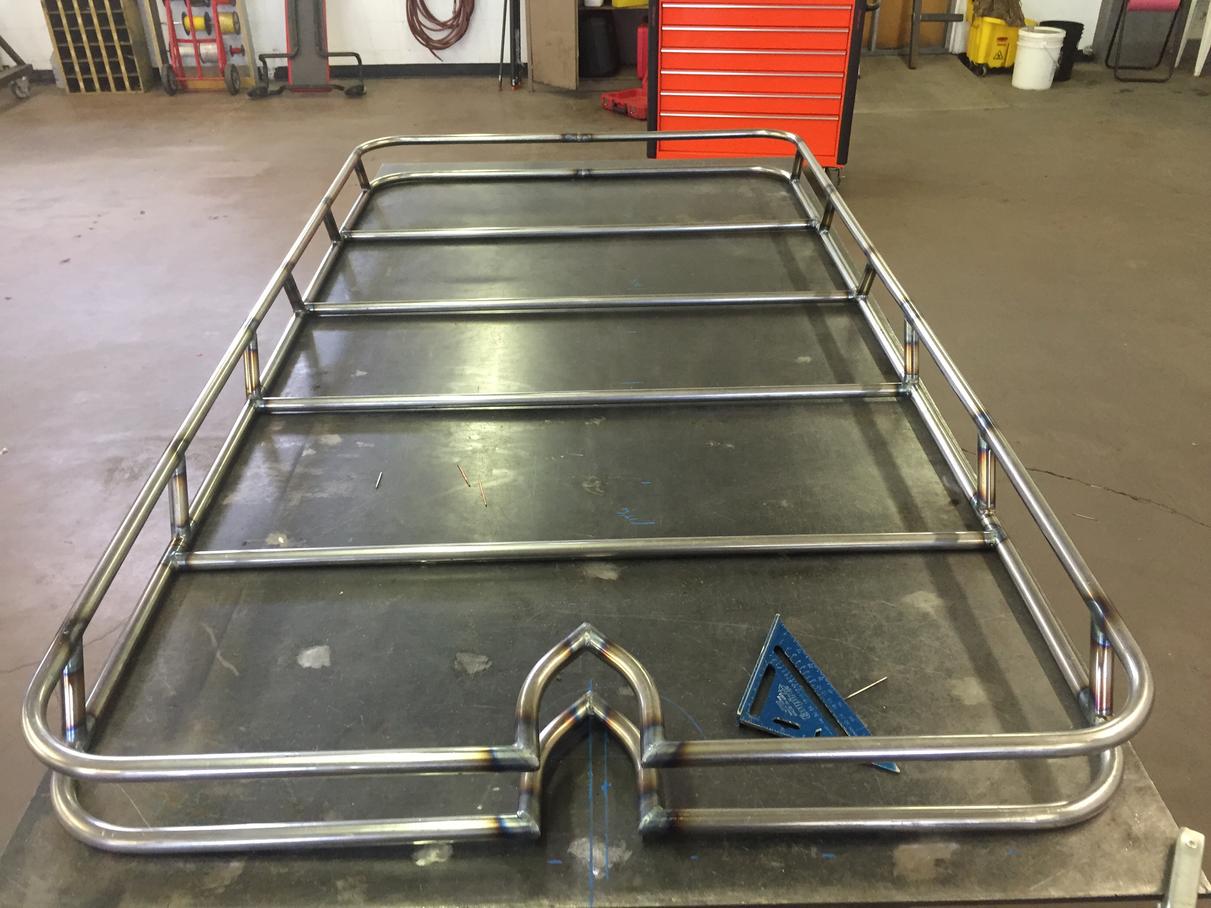

Figured I'd update this s little. Haven't done much due work and other projects but I am going on a week long trip in Colo soon. I figured with the whole famn damily and the dog I needed some more storage room. So I started a roof rack.
Bottom frame and cross bars are .095" X 1" and the rest is all .065 x 1". I couldn't come up with a better idea to get around the shark fin so I copied the Drabbits style rack. For the floor I used 16 gauge perforated steel plate only due to the fact that absolutely hate expanded steel. I dimple died a few sections to make the rack floor more rigid and stronger and it's amazing how much rigidity it adds with no added weight!! It is all tig welded except for a few spots on the floor.
