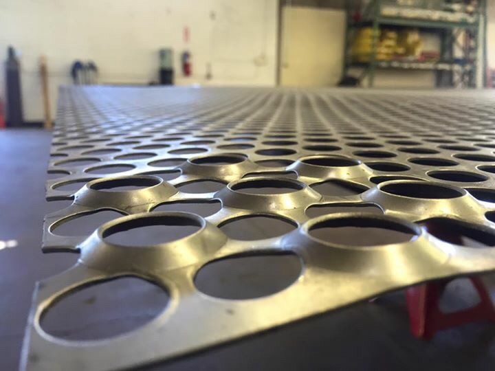

Floor pan

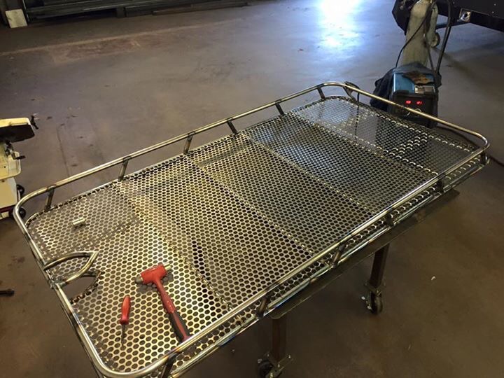

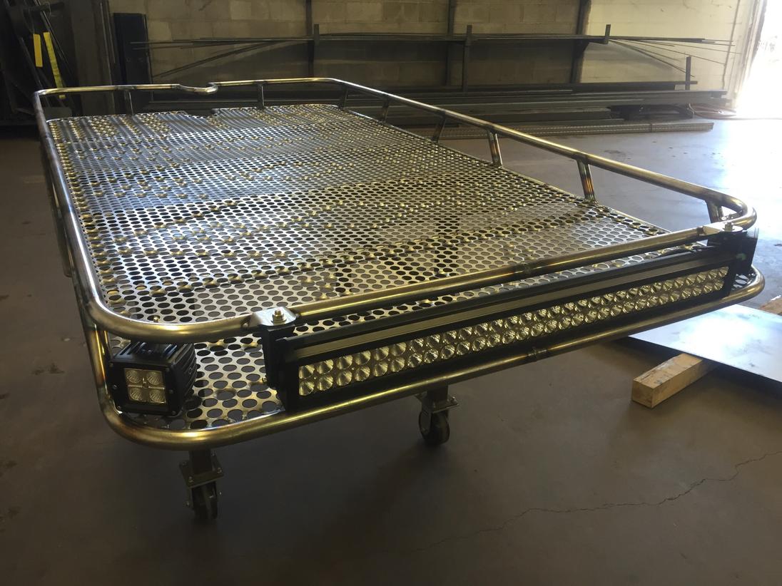

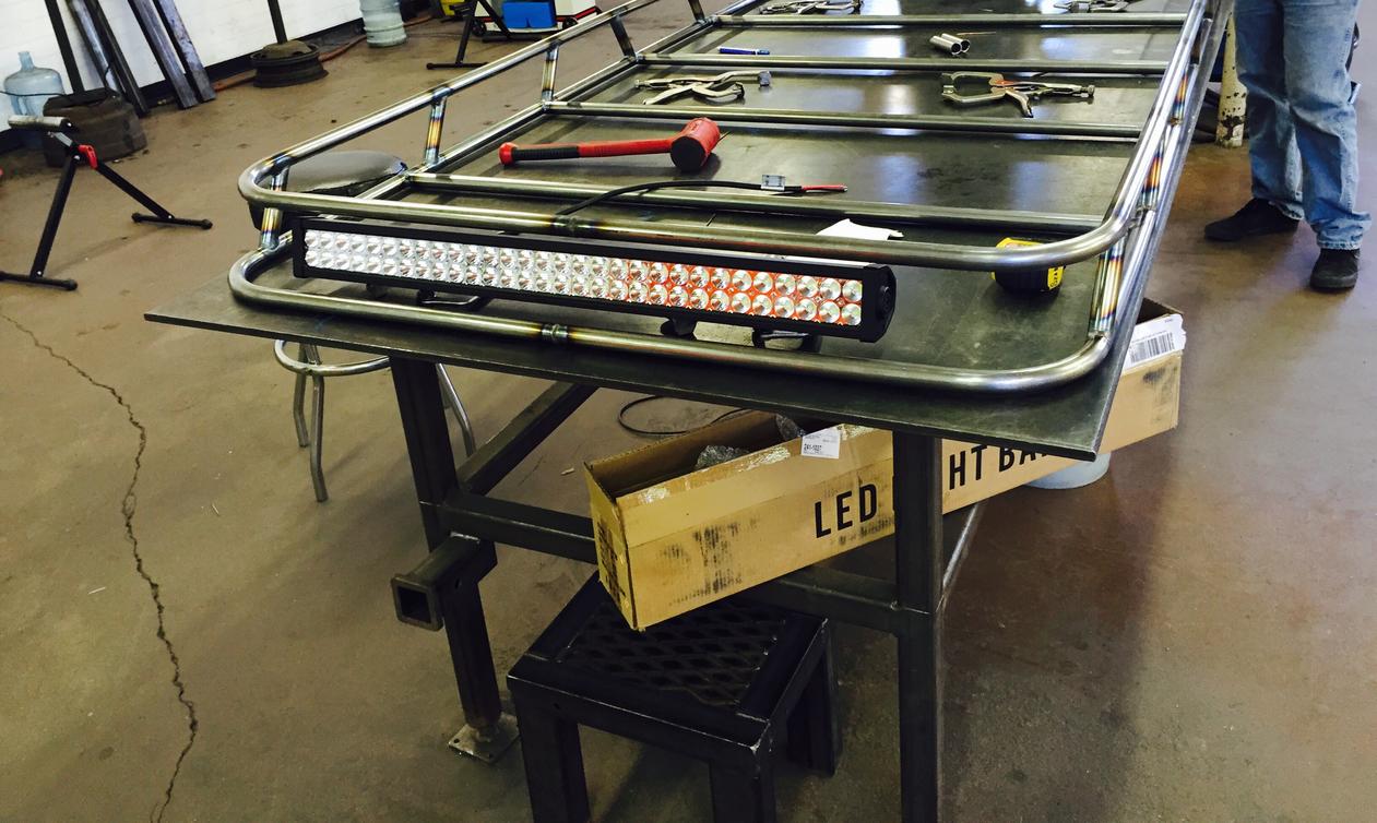

It will fit a 30" Rigid style light bar in front and two Rigid style dually's next to it, for more side angle.

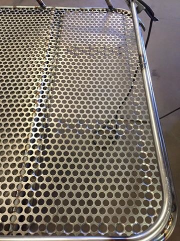

I only ran cross bars one way due to the fact that after the floor is dimpled I could stand on it (200lbs) and it barely moved 1/4"

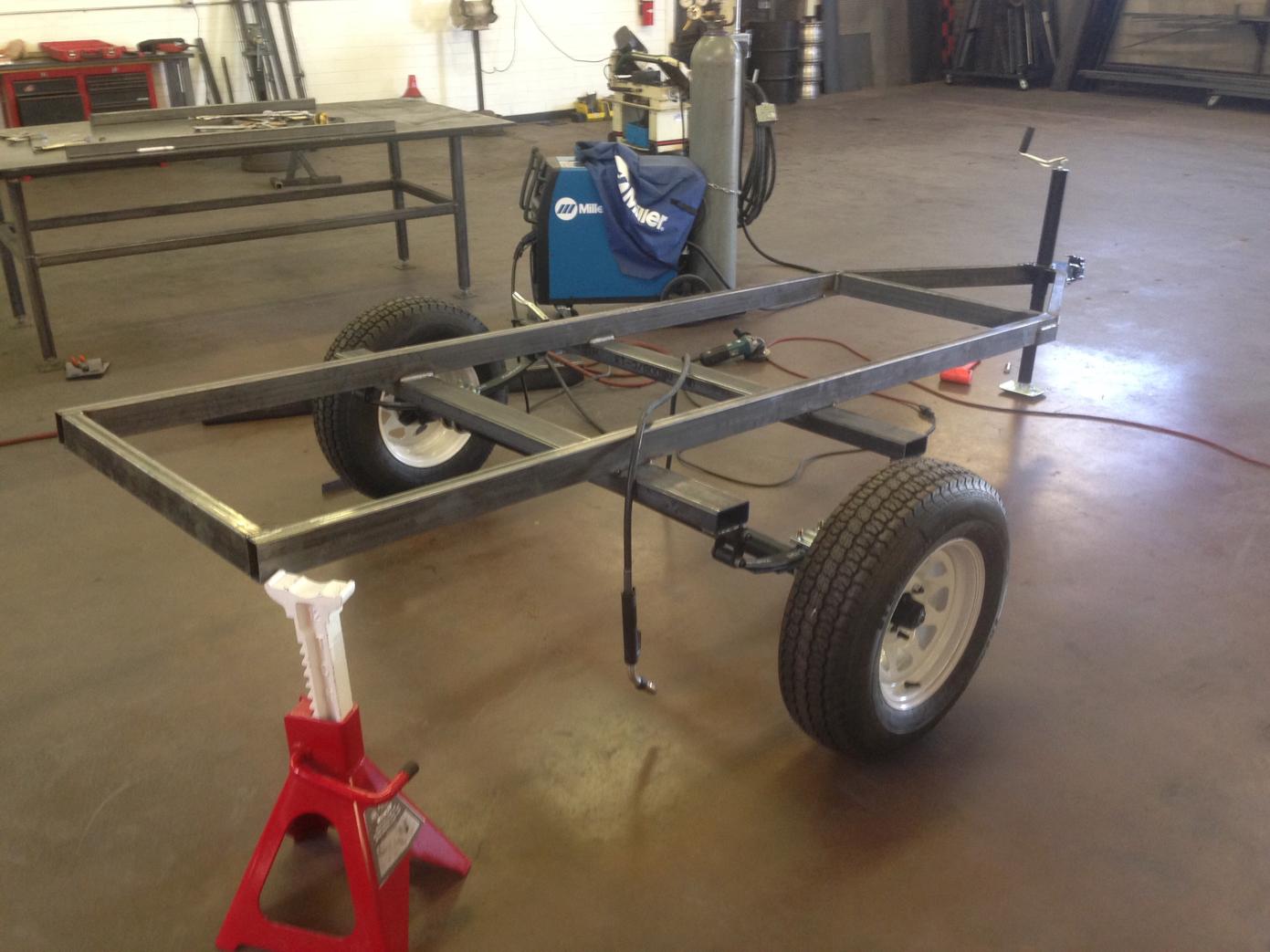

So I thought I'd show why I decided to sell roof rack, besides the fact that I don't think I'd use it much.
I built this..

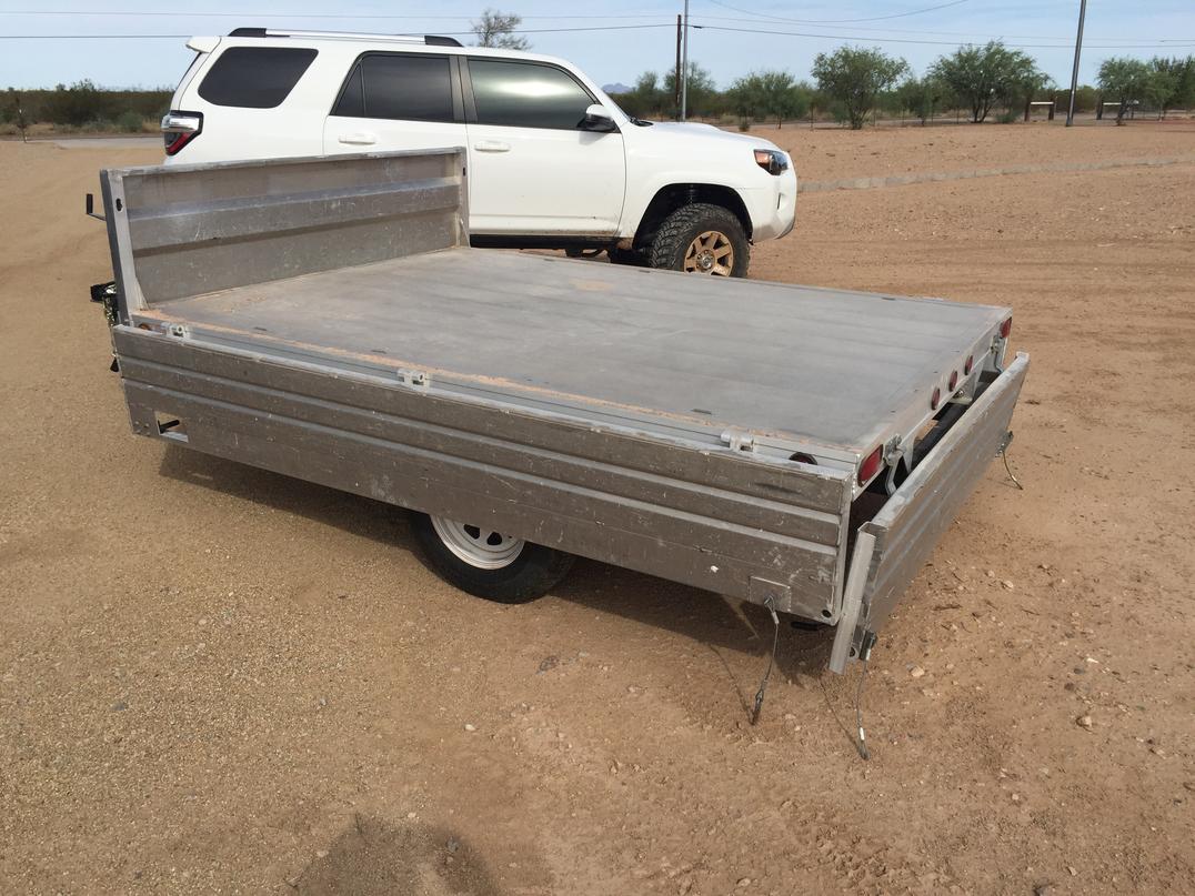

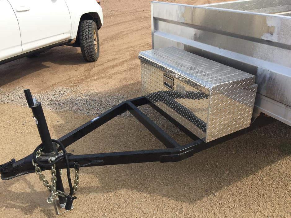

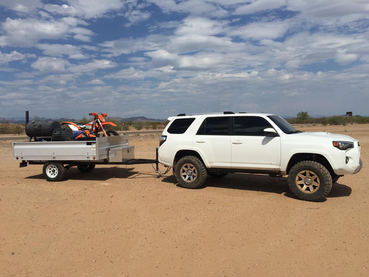

It's a 1.5" x 3" .120" rectangular tube frame. Went tons trailer supply place and got all new axel , springs, wheels and tires. The bed is off a HomeDepo rental truck. It's 8' feet wide, 9' long , and all the sides fold down. The whole thing weighs maybe 500lbs. The axel has brakes and a 7 pin controller but didn't put a controller in runner yet.
It towed very well, I'm really surprised how well it worked.
I may do a spring over, bigger tires and put a roof top tent mount on it:fro:
