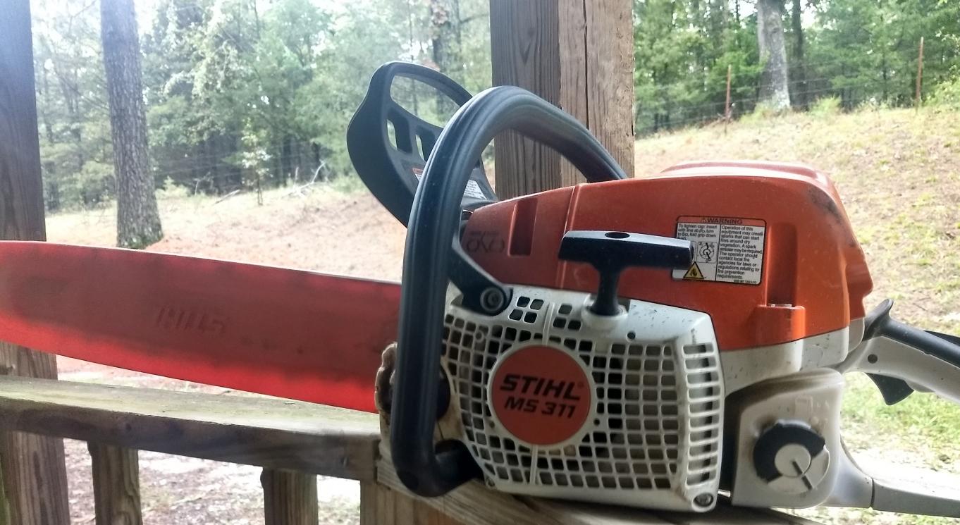

Looks like you got it pretty much covered. I live in the spectacular Ozarks national forest and spend half my life in my 4runner out there. We have over 3000 miles of ohv trail here! I only go solo for spiritual reasons and I'm an adrenaline junkie. I use a heavy duty come along instead of having a winch because I enjoy the feeling of getting stuck alone with just a come along and the rocks laying all around. I guess that's the adrenaline. But stacking rocks and the come along haven't failed me yet. Man eating mud pits are fun to get out of too hah. Also I never go into the forest without this!! You'll wanna add this to your list for sure. Trees are always falling out here and there too I'm sure. I actually enjoy helping to keep the trails clear also for other forest hermits. Enjoy the new toy!
