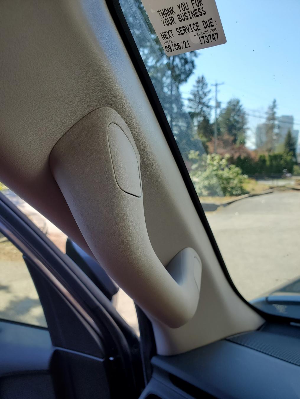

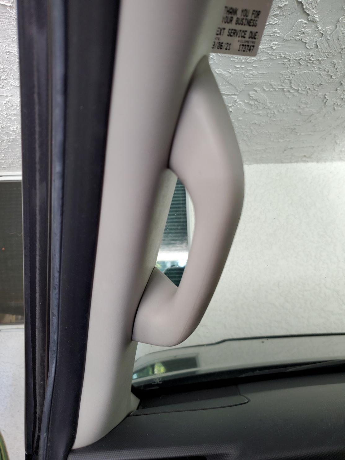

Here is the end result. Took about 1/2 hour.

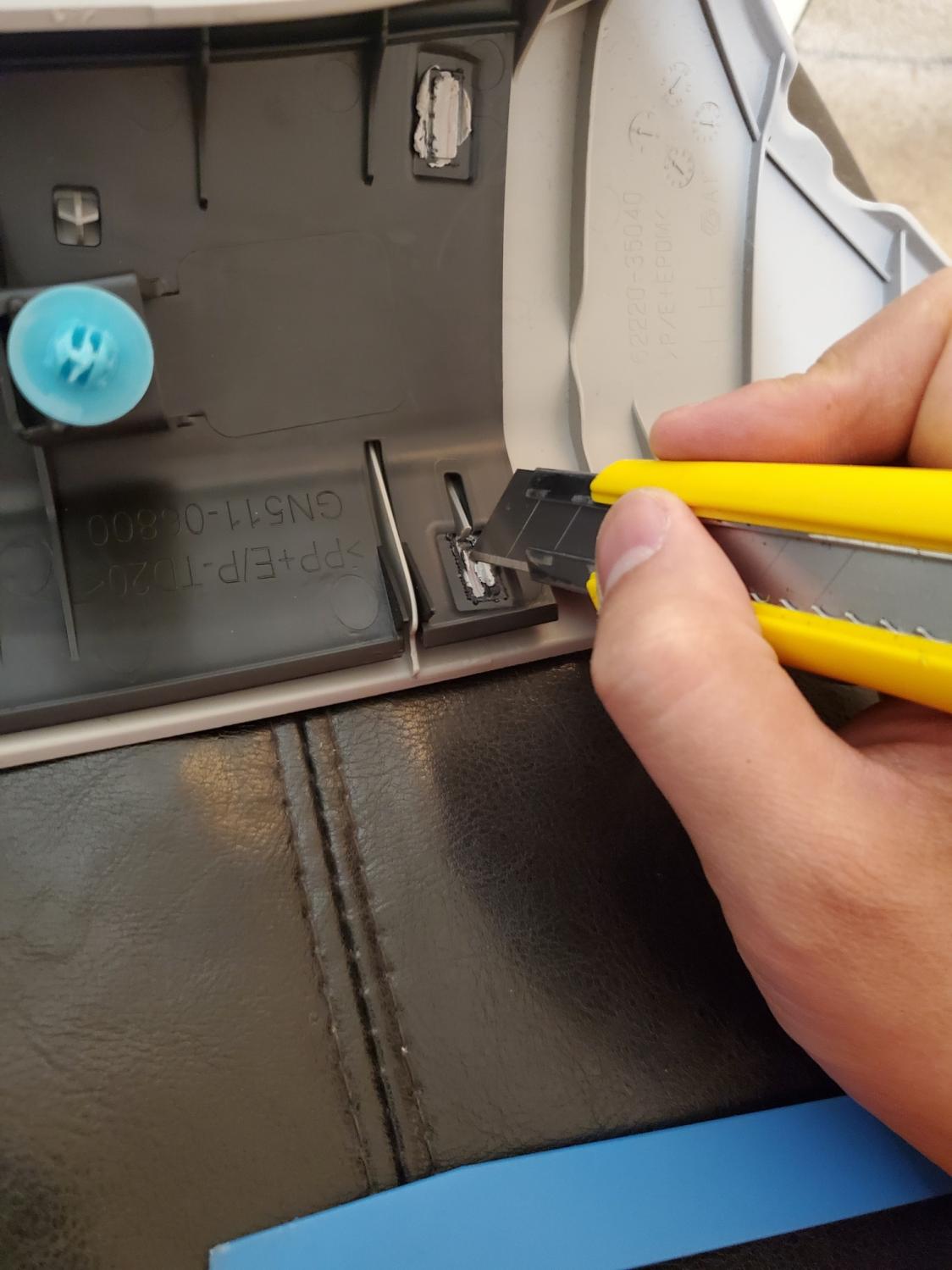

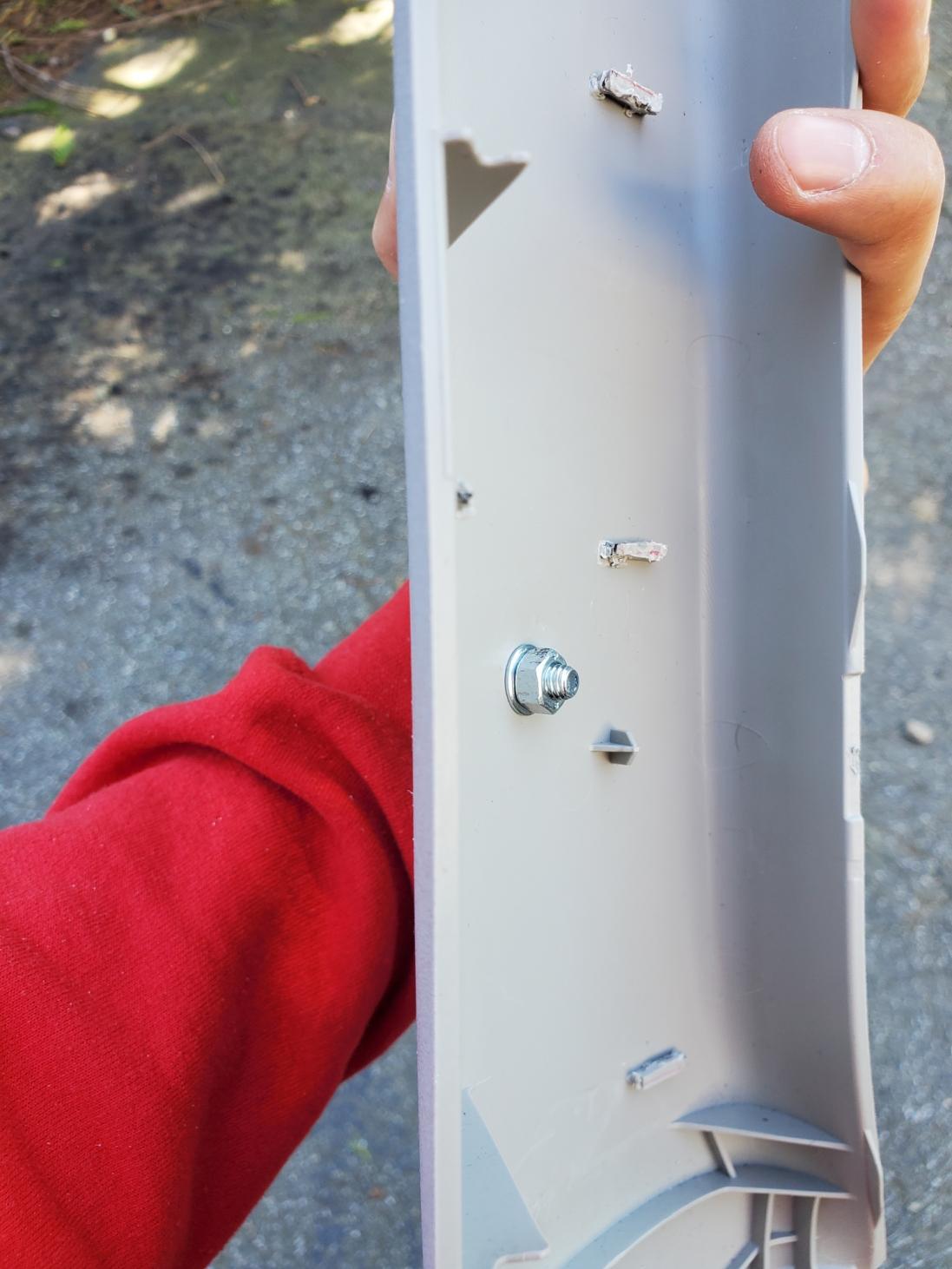

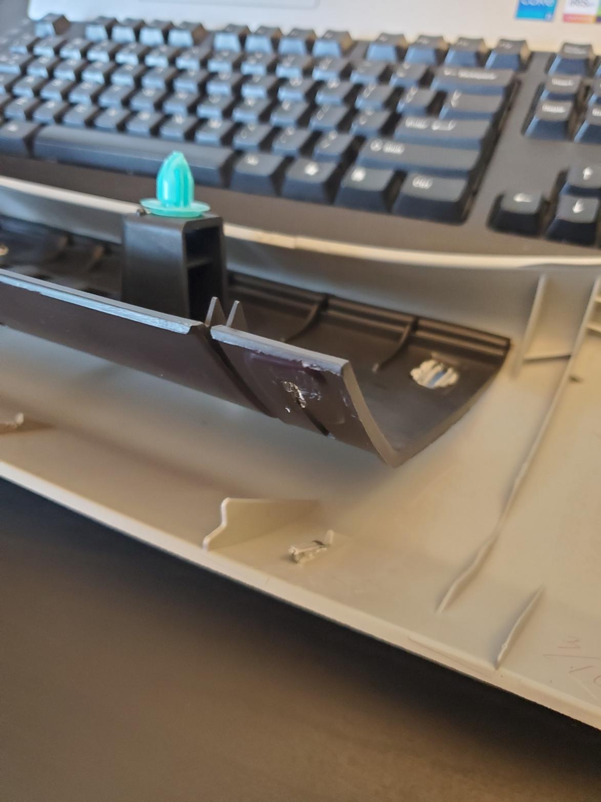

Remove A pillar trim. Note that you can remove inner black piece easily. Just make slits to the following welded spots.
trim square tabs and round tab on bottom hole. You can leave the round part on the top hole.

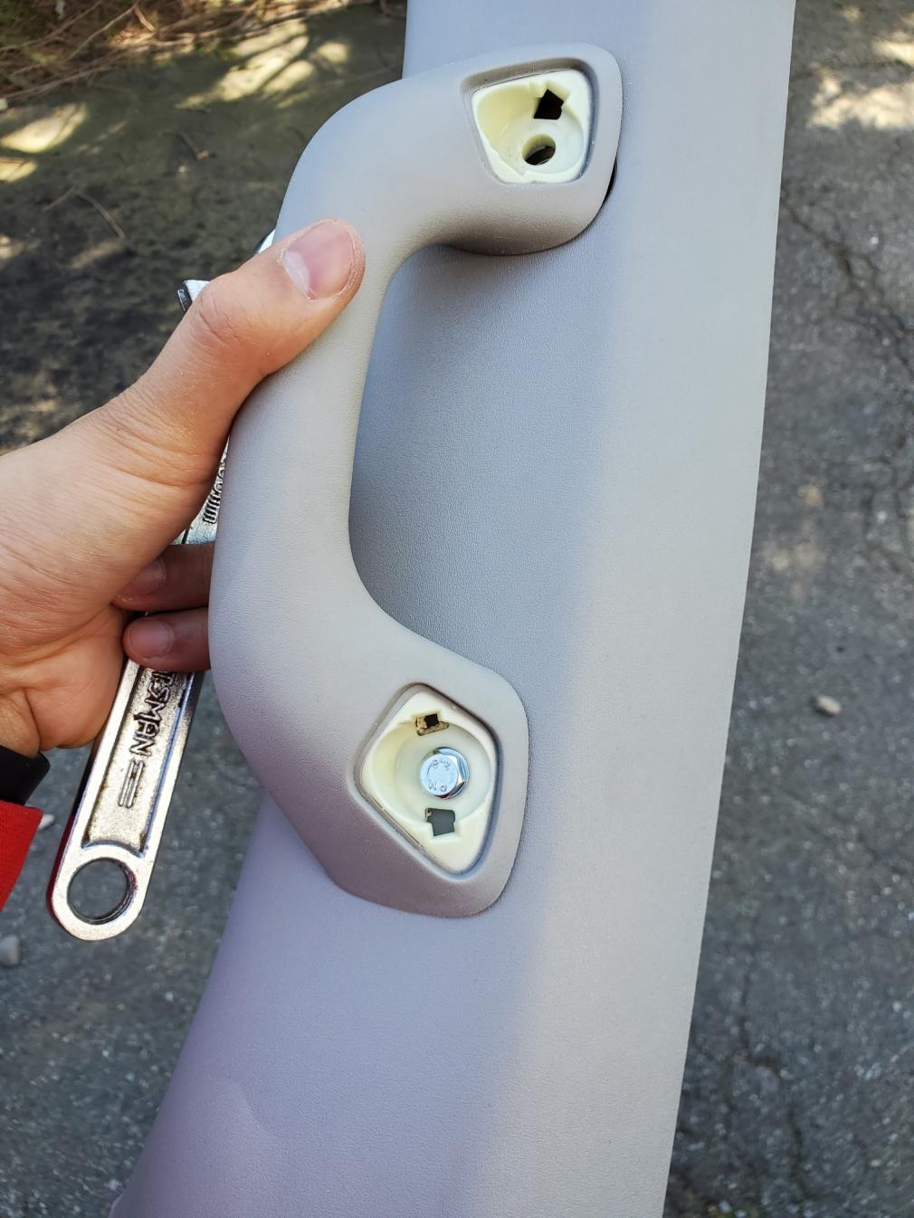

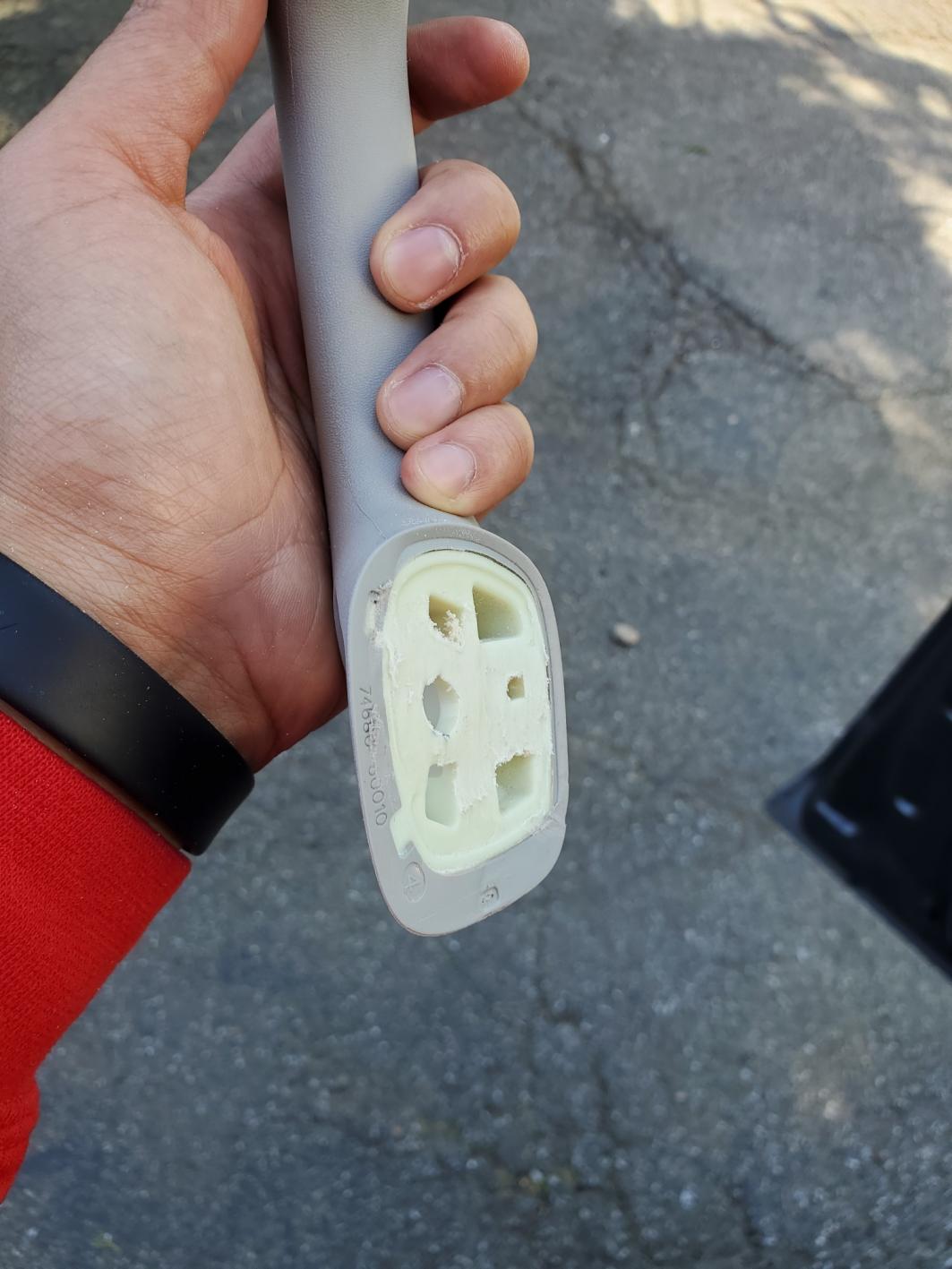

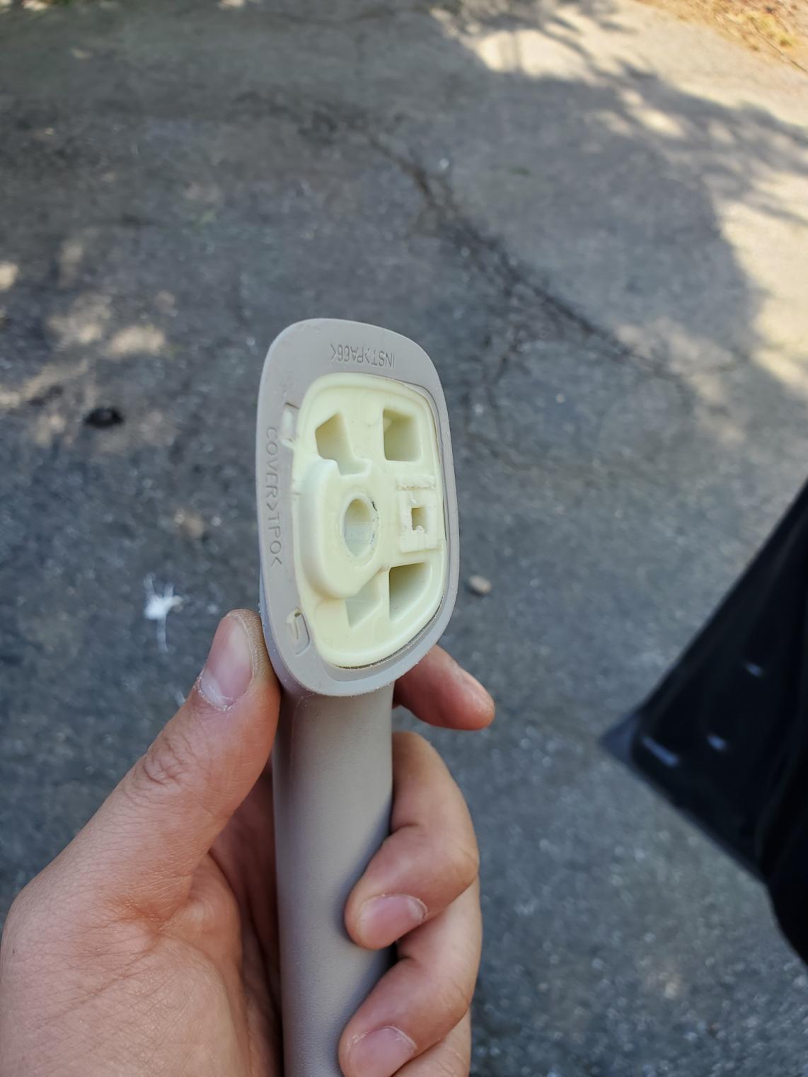

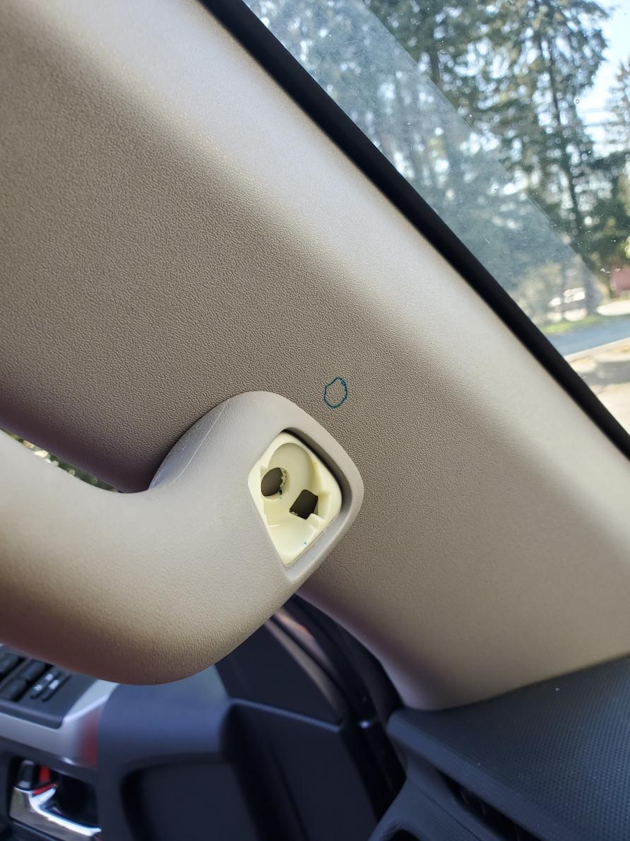

Test fit handle. Mark the hole for bottom.

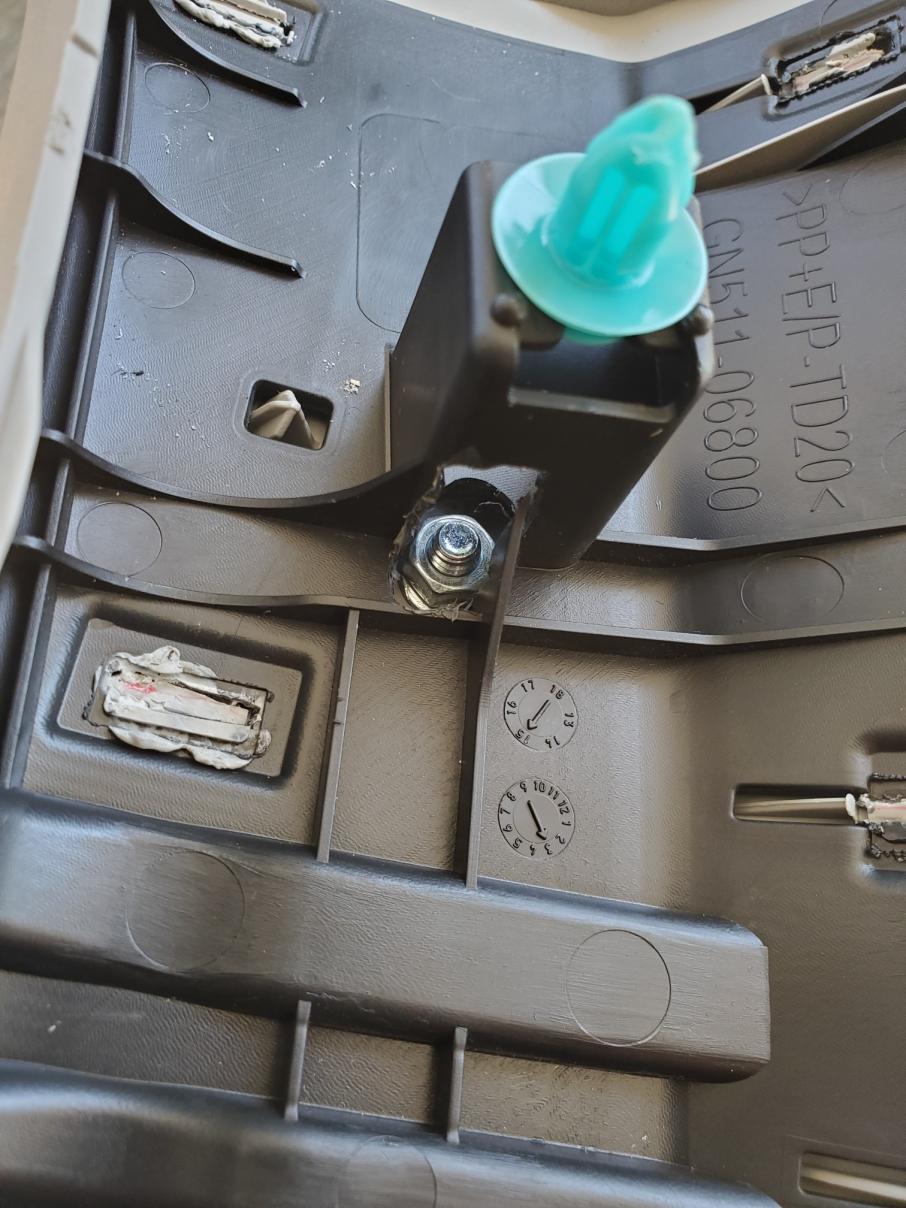

Connect bottom to the trim with extra bolt, washers, nut.
I was gonna leave as is but decided to re-attach black trim. Drilled a hole to fit the new bolt. You can attach the black piece with glue or whatever. I decided to leave as it seems to be snug just pressure fitted.
Use new longer bolt and washers for top hole. Add the covers and you are good to go! Enjoy your new driver's side grab handle1
