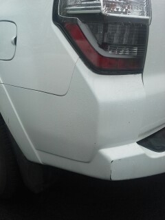

I had backed up to within a few inches of an old stump that was protruding from the hillside. I shifted to go forward, and just as I started forward the rear end of the 4Runner slid down the hill in the mud. It only slid about six inches but that was enough to go BANG! Into the stump. Now we get to the "Ding" part of the title. I got out, looked, and I now have a nice dent below the left tail light. I told Mrs. 1engineer that was my bad and now we have a bit of character added to the 4Runner! Anyway, we eventually made the turn-around, crawled back up the hill and made the other turn. The road got much better after that and we went on and had a fine dinner. We took the interstate back home that night and had a great time that day doing what we love: Getting off the beaten path.

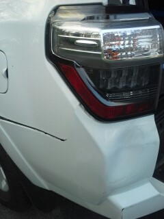

The next morning I went out and surveyed the damage. I loosened the lower bumper cover bolts, pulled the tail light, removed the plastic bumper spacer there and pushed the dent back out. I then re inserted the bumper cover edge (the part that makes the long seam behind the rear wheel) into the channel, reinstalled the tail light and hey! We get to the "Fix" part of the title! The stump had rubbed some of the paint off the bumper cover when it slid across it and will require some minor paint work.
All in all we had a great day and accumulated a battle scar along the way. Thanks for reading and here are before and after pics in the driveway. One note: When I slid into the stump it hit with enough force that it moved the tail light a bit during impact. The tail light moved and then returned to it's original position. When I pulled it to fix the dent in the bumper cover I noticed a bare spot in the paint under the tail light from rubbing. Touch up and all is well.

Very impressed with what you were able to do to clean the dent up (would never know it was there from the after picture except for the small paint scratch below.

Good story. Good fix. Luckily you didn't tear or crack the plastic panel.
