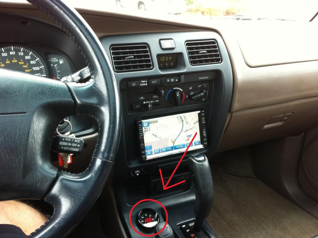

Have any more details and/or pictures on how you mounted this gauge? I am thinking of mounting a trans temp gauge there but not sure I have the room underneath.
The AEM uego is by no means a shallow gauge. If you put it directly in the middle (Left to Right) you will be fine. Mine is a little to the right and is hitting one of the relay things under it, on the left side of the relay, making for a VERY tight fit. Right in the center would be MUCH better. Hope that helps man!
Nice ride and nice to see some dyno #'s. I am running the 2.2 pulley but the 6 318 injector kit from URD is still in the garage. been debating on selling it and getting the 7th inj kit from URD.
Do you run an AF gauge? You must be running stupid lean. I like the oem look of the 6 injectors, but Urd recommends the 7th injector for us with the 99+. I am going to upgrade to the 2.2 very soon. I like how they look :-P
Jsmarine, check out my build (page 6) and 4-Ripcord's too (page ?).. We both sunk an autometer trans temp gauge in that spot. We both had to move some things around underneath the trim to get the gauge to fit.
