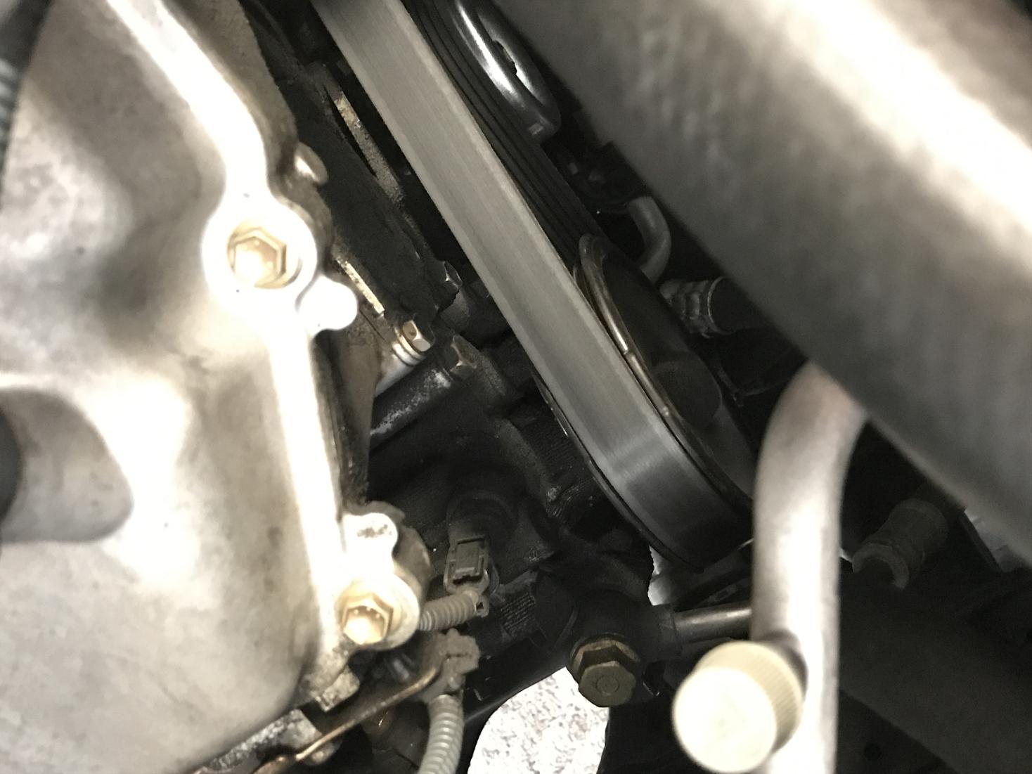

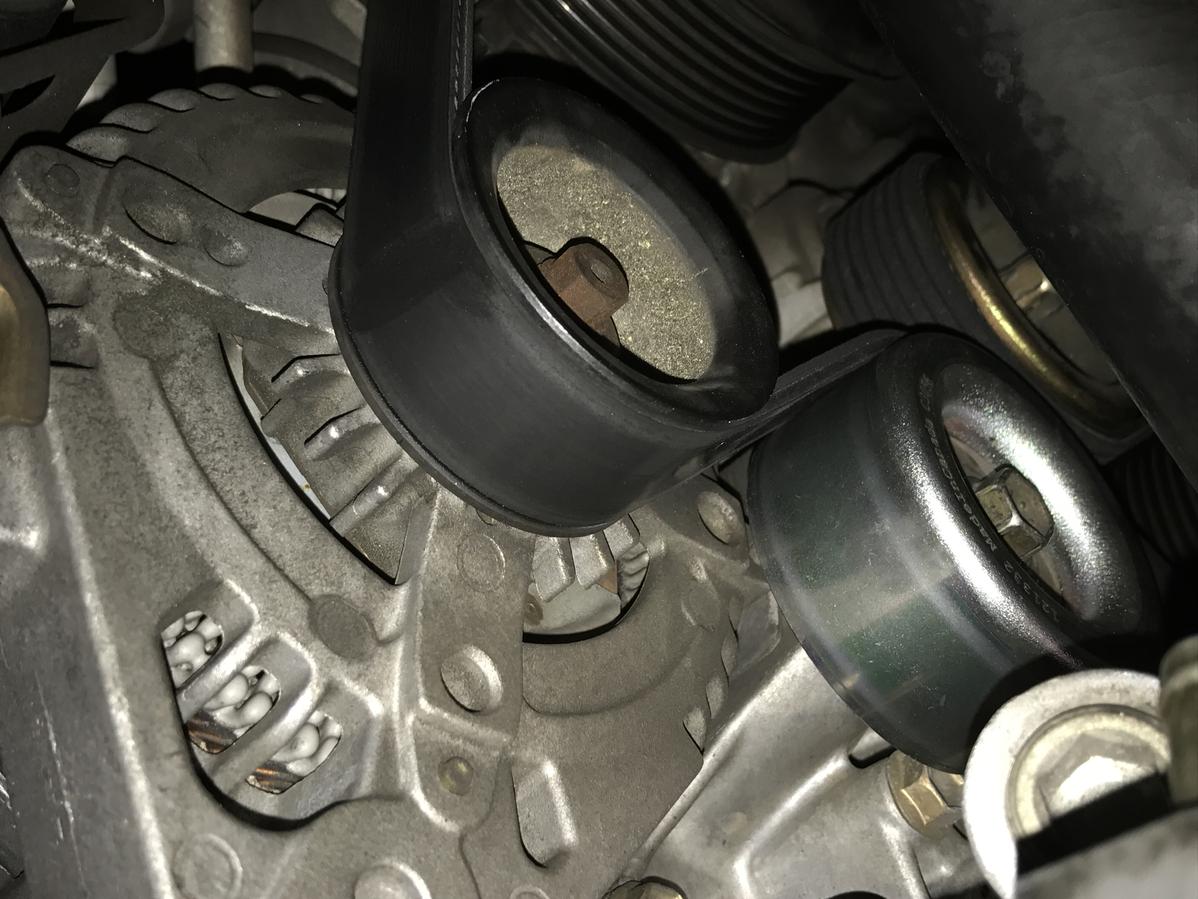

After reading your post, I decided to change my pulleys as well. I posted this in another thread but thought you might be able to help also.
This was my first time ever changing something like this and I noticed these wear patterns on the new belt. Is this normal?
If you look on the edges there is some sort of wear. I checked the route 3 times and I drove the car for a good 10-15 min with the AC on. There's also some type of wear on the new pulley. Not sure if this is normal as well. No weird pulley noise.
This may be something completey unrelated or something I've never noticed, but when I accelerate now I hear a clicking noise. No click at idle besides the normal v6 click.
145k on the ODO
145k on the ODO
just look like the belt is not on one of the pulleys perfectly, i say the one next to the compressor, just pull it towards you a little bit. but it shouldnt hurt anything.
Thanks for the reply. I checked everything and it seems to be seated over the pulley ok. I'm going to keep an eye on it.
it looks ok, i wouldnt worry too much about it, usually you check the groves of the belt and determine if its good or not.
