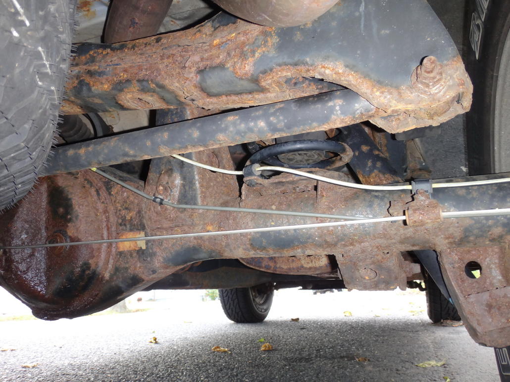

Wow. I feel like I just got punched in the gut. My baby, my 1997 4Runner SR5, has just been read her last rites. But I've done some research around this forum and around the internet, and I'm not giving up on her yet.
I take care of my 4Runner, as she's taken care of me. Regular oil changes, keep her clean, well lubricated, etc. But living near the ocean coupled with the fact that I don't know anything about cars has apparently lead to rust. I'm used to the cosmetic stuff - the rear bumper rusting out, little spots here and there, but I had no idea the undercarriage was as rusted as it it. I've attached some photos here, but to see ALL of them you can do that HERE.
She has 128,000mi on her and she's been purring like a kitten since I got her back in 2000. I got her with 33k miles on her, off a lease, and I've been the only owner since then. She has been the most reliable thing in my life, and if there's any way I can salvage her, I feel like she has SO much more life left in her. Another 100k miles, easy. But this rusted undercarriage has me worried.

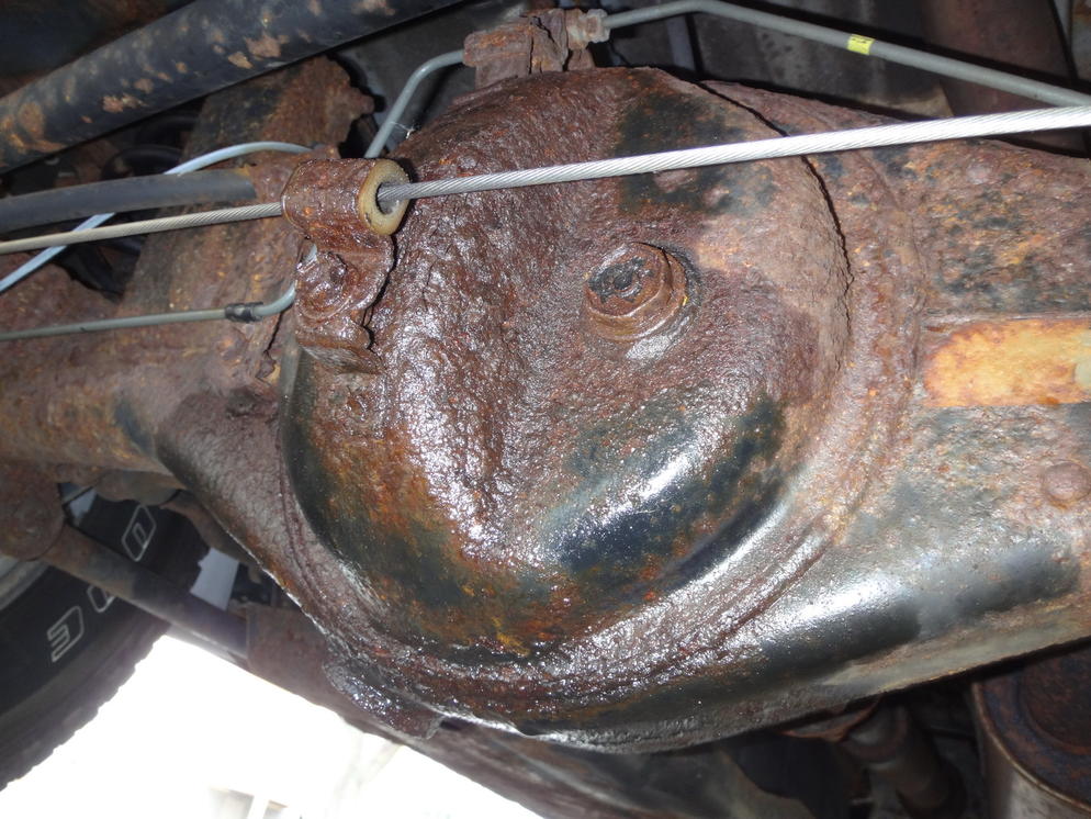

I noticed a humming noice when I accelerated, which would lessen if you let off the gas. I took it to Jiffy Lube to get the oil change and get the transmission fluid changed, and asked them if they knew what was causing the noise. They said that my rear differential was full of holes, and was "bone dry". They topped it off, but said it would just leak again and I need a new rear differential.
I took her to the Toyota dealer to have them assess it, and it came back BAD. This is their rundown:
"VEHICLE HAS VERY BAD LEAK AT REAR DIFF. ROUGH EST OF 2715.00 PLUS TAX TO REPLACE. COMPLETE UNDER CARRIAGE IS RUSTED. ALSO HAS RUSTED POWER STEERING RACK AND COOLANT LINE. BELT NOISE UPON START UP IS FROM PULLIES. THEY ARE RUSTED ALSO. WOULD NEED TO REPLACE TENSIONER, DRIVE BELT, POWER STEERING PUMP, ECT"
Obviously not good news. The thing is, I don't know anything about cars. I've read in here that if the rust isn't bad enough, to just get wire brushes and do this or that and apply this sealant etc. But I don't know how to do any of that, and I'm smart enough to know that I'm not competent enough to handle it. I've seen pictures of some of these 4Runners with the axles on the ground, and I can barely change a winshield wiper.
I just need to know what you guys think, as the experts. What would you do, given my situation. First, is it salvageable? Can I save her? Or do I need to sell her for parts (gasp)? I really don't know what to do. Obviously the ideal situation would be if this is fixable, to have someone who knows what they're doing clean the rust off and go from there. But I don't know - do I need a new rear diff?
I can take more pictures if you let me know where to point the camera. If any of YOU think you can handle the job, I'm located in NJ at the shore (by the beach, which prob leads to the accelerated rusting). All these words come down to this final one, guys:
HELP!
Kevin ([email protected] to email suggestions)

if that is the extent of it, looks very salvageable - I've seen a Whole lot worse pics on here!, lotta work but can be done. Do some searches on here, the northern guys know the process and chems to use on it. Luck!

Also your leaky diff looks like its coming from the fill plug (cant totally tell through pictures)and not due to the rust. Clean all the fluid off and see what gets wet first. If its the plug take it out and replace the crush washer/gasket, costs like 3 bucks.

Oh yeah that looks familiar. Take a peek and poke at the area right next to the muffler. I just had that area fixed on mine. Also have the leaking differential, which I've temporarily fixed with JB Weld and some POR 15. My pulleys were also rusted, so when I did the timing belt and water pump, I took them off and sandblasted them and painted them. I get under the truck when I can and pick an area and go to town with an air needler (can remember the name of that thing right now) and a wire wheel. Have also bought a couple of used pieces from members on here, (cross members)and just recently found an entire axle with very little rust I'm going to refurbish and put in next spring. It's an ongoing process I plan on getting on top of because I LOVE this damn truck!

For the rear axle leak.
It seems it is leaking from the top. Remove the e-brake cable bracket and remove the rust completely. Drain axle oil. Using a wire brush mounted to a drill, clean the the area. Find holes and plug those with JB weld. This should plug the holes in the diff.

3rd gens all have this common issue on the rear diff housing. I live in the Northeast and had the same issues. The correct way to fix might be beyond your comfort level, but here is a bandaid. Drain our rear diff clean it with a wire brush or something. Then clean area with parts/ brake cleaner. Then JB weld the surface. I did this and it lasted for about 2 years. It would be better fix if you removed the housing and cleaned no the inside and out and apply JB weld from the inside. Buy the outside application works well. This fix lasted about 2 years for me then I got more rust around the are I did not apply JB weld. That's when I found this permanent fix. You just need to find a shop to weld it on for you (not the dealership)

Yeah, Chill will is on the right track, that is by far the cheapest way to permanently fix it. If I had to go back, that's what I'd do instead of spending way more for an entire rear end.

As for that level of rust, that's pretty bad, but it isn't fatal yet. You definitely need to check your frame rails to make sure they haven't rusted all the way through. If they have, then you have more stuff you need to repair before driving it again and the fix is going to cost even more.

This is what it looks like and is a permanent fix.
I thought about doing this but I read some where on here that the housing hits or comes extremely close to the panhard bar. Also, do you have to fabricate new little brackets for the Ebrake cable and the brake line or just cut the old rusty one off ( my ebrake one is gone) and weld them onto the new cover?
