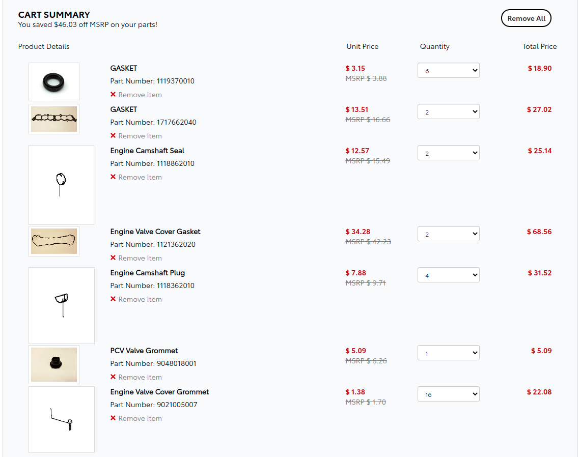

Found an older guide that had all the part numbers listed. I've seen suggestions to make sure all parts are OEM. After pricing everything out the total comes to about $220 (mostly coming from the gaskets themselves ($35 each). Does this seem like a good plan or are non-oem parts fine? Just bought the truck with 205k miles on it and theres a small leak that is getting all over my steering column and bell housing.
Also I can't do more than change oil and brakes on my vehicles so I received a quote from a local mechanic at $300 just for the labor. Does this seem right?

This checks out from my list back in 2019. Nice work! The only thing I'd add would be FIPG gasket maker. I bought OEM, but another gasket maker would probably be fine, too.
1. Valve cover gaskets - Part #11213-62020 - 2 Total
2. Spark Plug Tube gaskets - Part #11193-16010 - 6 Total
3. Intake Plenum Gaskets - Part #17176-62040 - 2 Total
4. Washer Seals - Part #90210-05007 - 16 Total
5. Camshaft Plugs - Part #11188-62010 - 2 Total - order
6. Halfmoon Plugs - Part #11183-62010 - 4 Total - order
7. PCV Valve Grommet - Part #90480-18001 - 1 Total - order
8. Toyota FIPG seal packing - Part #00295-00103 - 1 Tube​
Edit: $300 seems pretty fair for labor for this job. Took me a weekend doing it my first time, taking my precious time.

Great! Yeah I would definitely destroy my vehicle if I attempted this. I'm sure I would break or lose something or not be able to put it back together. I would attempt it with someone that knew what they were doing, but that's not an option unfortunately.
This is great timing as I was just going to order parts so I can do this job as well, thanks for compiling the list. I'm going to go with OEM since they lasted 20 years (so sticking with OEM on this one).
I will say that's a fair price.
