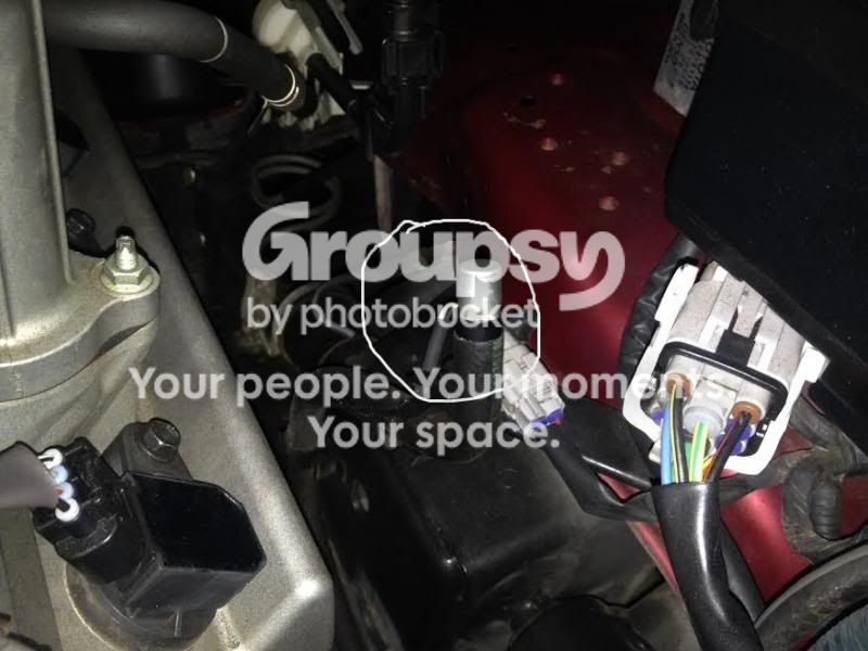

3. There is a capped hose in the engine bay. Is this truck funky, or is that a Toyota cap for a feature the SR5 doesn't have? driver's side fenderwell area, across from 2nd spark plug on that side. I just sold a Tundra with the same(ish) motor, don't remember that....see pic:

3. Yes that is normal. It is the cap for the differential breather line.

Center diff for me wont work unless in drive, moving or not. Preferably moving a little. The hose is fine, i have one but it definitely looks funky. Thought the same thing.
ok, 2 out of 3 issues solved there (kinda!)..thanks!
