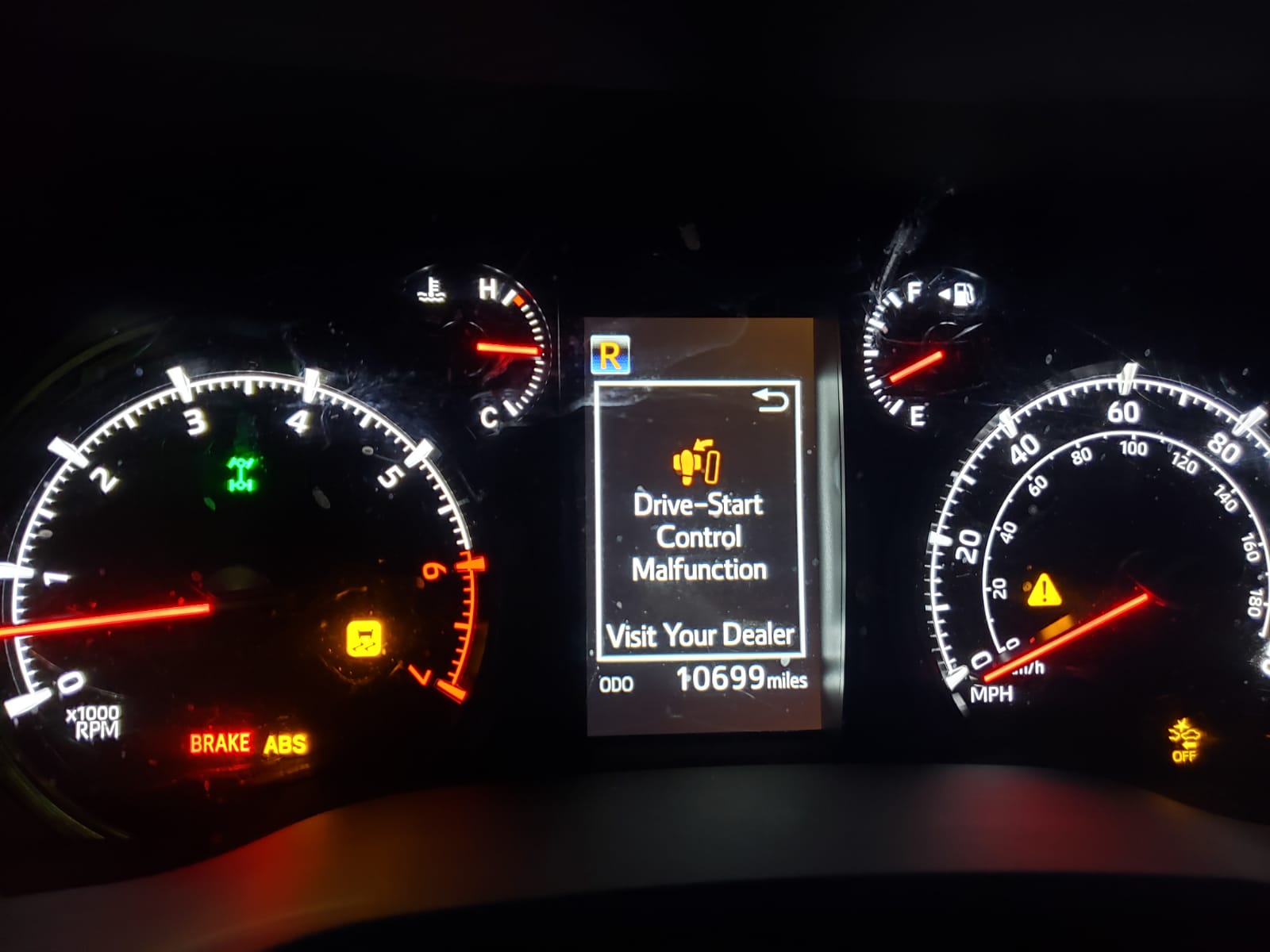

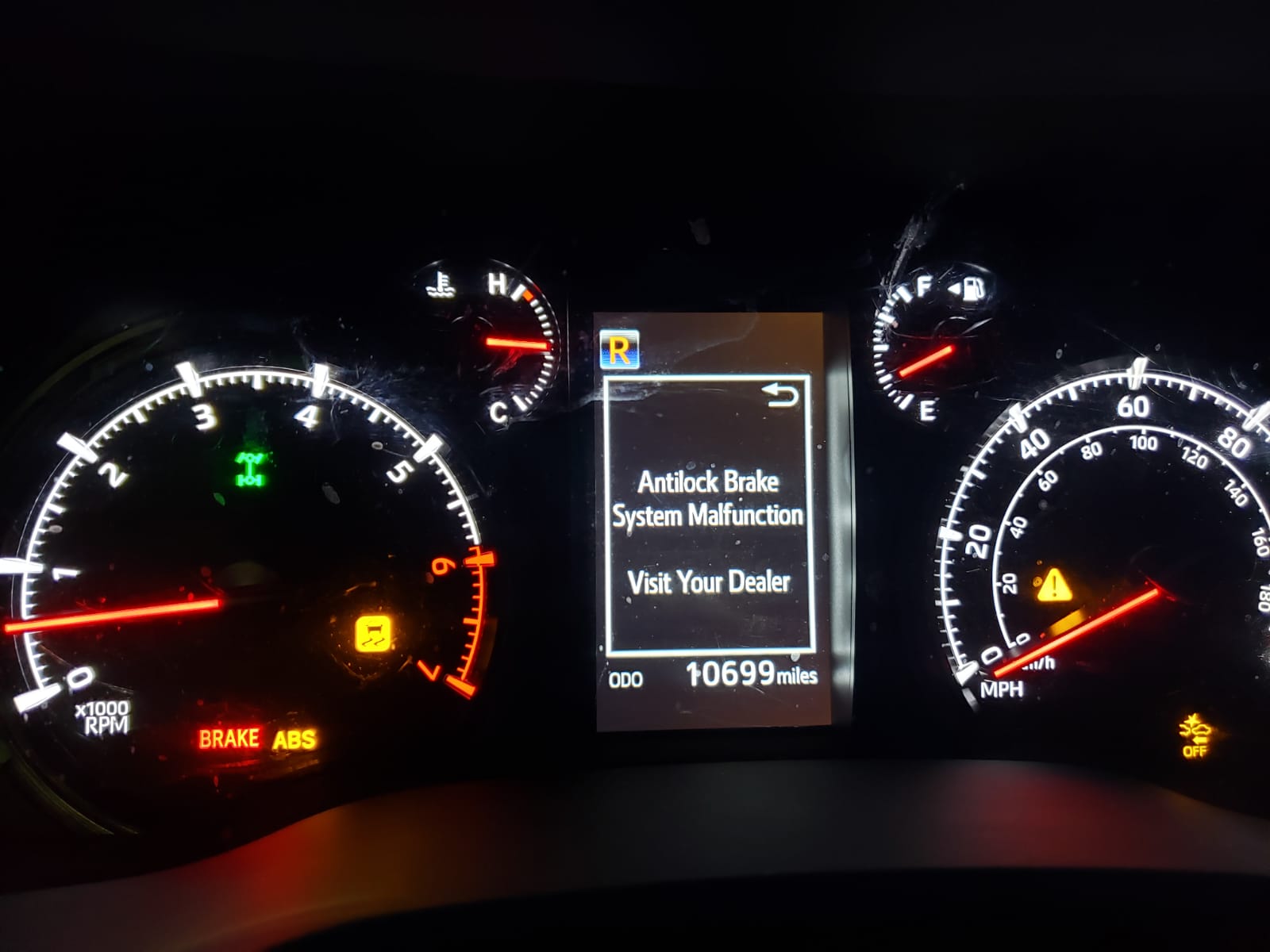

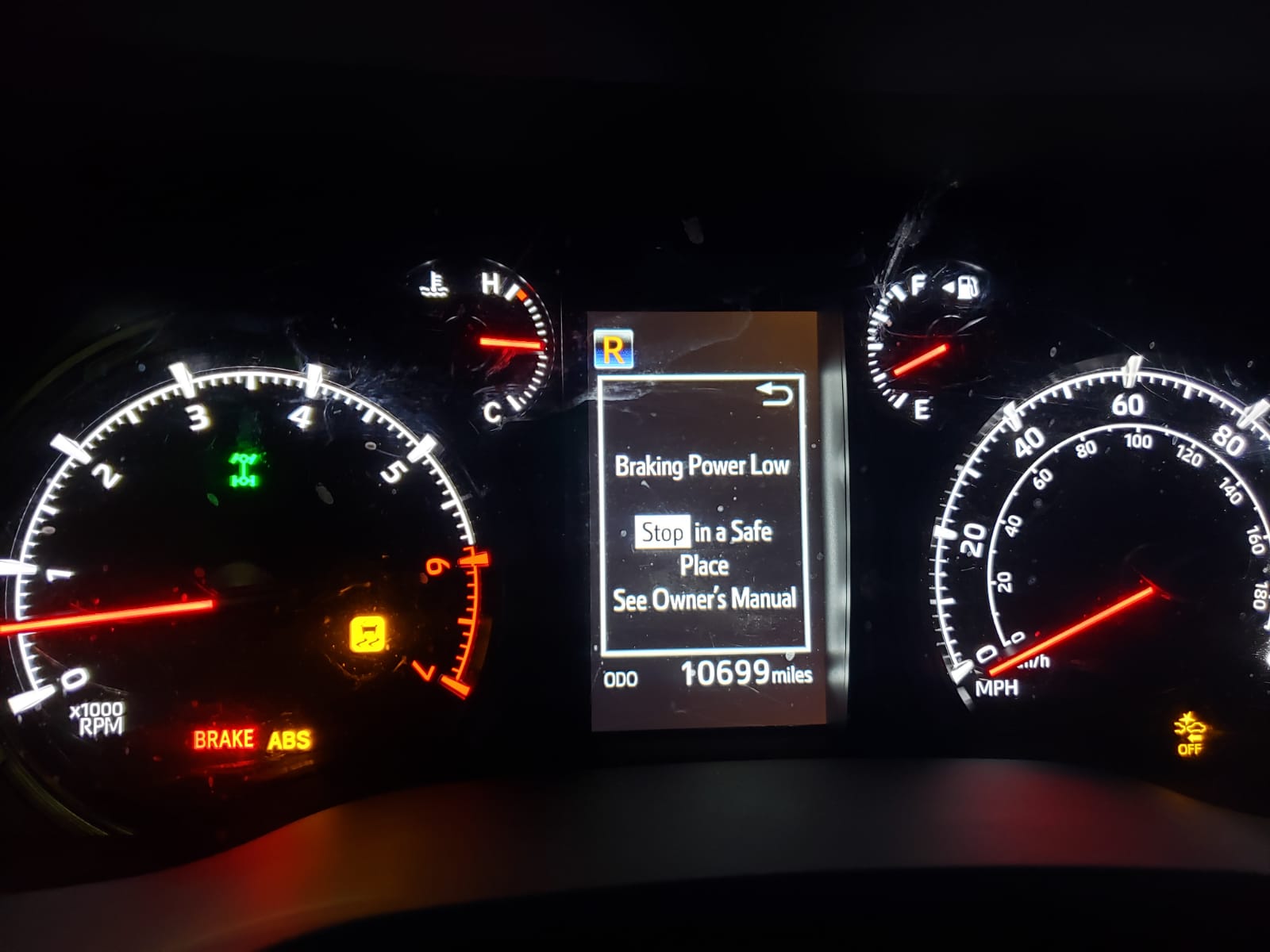

This just happened now. On my 2020 SR5 4x4 with 11k miles.
Display says anti lock system malfunction visit dealer. braking power low,drive start control failure visit dealer.
Will take it in Monday when the dealers open. Has this happened to anyone before? I drove the car this afternoon and moved it from the drievsy to the street. Wife got in to drive it, and called me saying all these warnings are lit up. So random. She’s driving it now and says it’s driving fine, not sure if it’s because it’s brutally cold here so sensors are just acting up. It’s been between 0 and like 10 degrees all day and the car sits out.

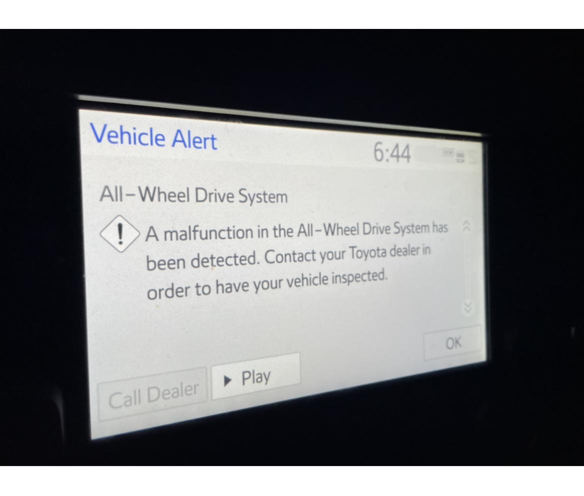

Tried to switch it from 4wd to 2wd and back to see if it was anything related to that and now it says 4wd malfunction!
