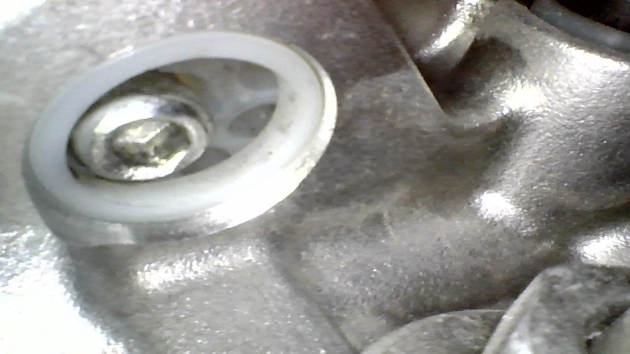

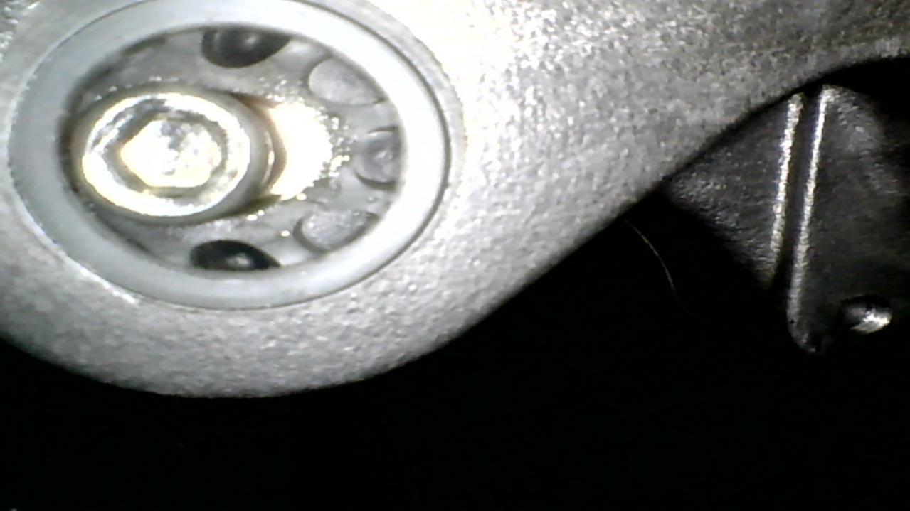

On 3/23, my wife picked up the truck and immediately heard and felt (through the brake pedal) a light clunk/knock when using the brakes. She's not a car person, but even she knew this wasn't right. I told her to take it back immediately and tell them to figure out what's happening. The tech takes a look and says that he can feel/hear the knock but then proceeds to tell my wife this a normal sound in 4Runners and it is the result of the brake pump assembly working and there's nothing they can do about it.
I get home from work and take a look. The knocking sound definitely wasn't there before. I then reach down and grab the top of the pump assembly and wiggle it. "Knock knock knock". So I get my scope out and inspect. The audible clunk/knock is being caused by metal to metal contact of the pump assembly body mounting points contacting the hex bolt mounting pins to the master cylinder. There is rubber bushing between the pin and mounting point, but the tech somehow knocked the pump assembly out of alignment when messing with the brake lines to the point that the pump assembly had shifted slighting, thus the bushings were fully stretched and the pins were hitting the pump mounting points (see attached pictures). The first picture is the front mounting point and the second is the rear mounting point. Yes, Mr. Tech man, it is the pump assembly, but it was your work that caused the issue and it is not a normal sound. A little adjustment of the brake line and the sound disappeared. I diagnosed this issue in 5 freaking minutes and fixed it in 1 minute once I figured out what I needed to do.
This morning my wife let the service advisor know that I fixed the issue and he has asked for pictures. They're not touching the truck again.
