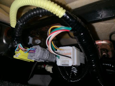

My wife's 4runner is 2 years old, under warranty.
We got a warning on the dashboard about the ABS system malfunction and took it into the local dealer.
Apparently a wiring into the wiring harness near the rear driver side wheel/ break caliper split.
They felt that this was due to a stick or rock or normal debris from driving ending up in the undercarriage damaging the wiring
Theres no other damage to the vehicle what so ever.
They refused to cover this under warranty and stated that even though this was normal wear and tear this is due to normal hazards of driving.
Do you all generally agree with this that Toyota shouldn't cover this or has anyone had dealers cover this type of problem under warranty?
For normal people this would be a $0 fix of splicing wires together. At a dealership it was outrageous.
You can see the blue wire separated in the middle harness below

Sounds like a lazy dealership manager with a weak argument (rock or stick??)
Call 800 331-4331 Toyota customer support in Plano TX. Long as the vehicle is stock I can pretty much put my job on the line that they will cover it
I just had a customer with a 2010 highlander his rear diff went bad they threw in $2500 good will money towards the repair since he buys only Toyota and services them here as well.
Something outside the vehicle broke that wire, and I imagine that maybe a light came on right when it happened?. I personally don’t think manufacturers should be held accountable for road hazards that break things. I’m guessing the warranty is pretty clear on what’s covered.
If it really is a $0 fix to splice it back together, I’d go ahead and do that if I were you. The dealer may be obligated to go further if they do the repairs - splicing/repairing that ABS wire may present a future liability for them, in which case they’ll probably quote you for replacing the harness or something similar. I wouldn’t sweat going after a free repair if it were me.

Was the electrical tape around the wire chewed up like that when you took it in or did the dealership do that? If it was chewed up when you took it in, something hit it and split it. Looks like a fairly clean cut though, which is odd. Would have had to be a pretty sharp rock or stick and I'm not seeing any other damage around it. Wires don't typically get cut, they typically get yanked out of the connectors and if that's the one that I think it is, it's tucked up high enough on the frame that you're going to have to try really hard to make it split right there.
edit: that close to the plug you'd expect a lot more damage/scrapes/scratches on nearby components if it was indeed a rock or a stick. That almost looks intentionally cut.
Its all very confusing to me. I believe the electrical tape/ wrap was cut back by the dealership

Solder the wires back together and call it a day. It's simple enough. You could try to fight the dealership, but the reality of it is that this still almost looks like vandalism to me. The cut is too clean, and honestly I've dragged my rig over enough rocks, sticks, bushes, twigs, whatever and never torn an abs wire. I did however easily pull all 4 wires out of the connector working on my suspension. So the wire should have pulled out, before looking like a clean cut. Something sharp did that.
Yea I appreciate that. The problem is that I requested a picture of the repair needed and to speak to the manager. In the interim, they fixed the problem against my wishes and I was left with a bill of $330 For a repair that would be very simple to do myself. I’m not happy for a few reasons
Well if they fixed without permission tell um to pound sand.
Unless you signed something when you dropped it off read the fine print.
