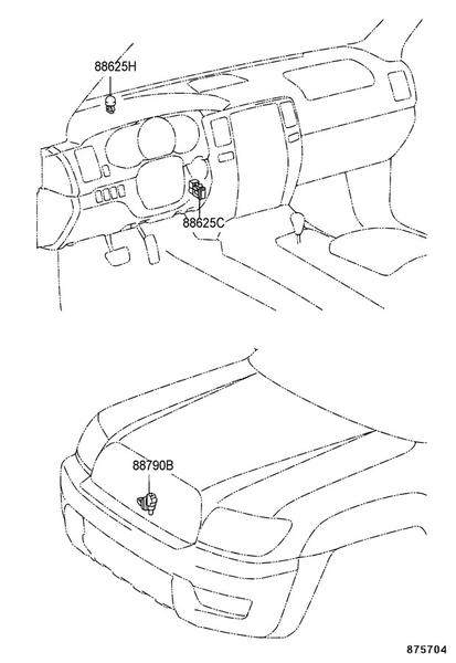

If you A/C is kicking on and off, and it has been doing this for a while, I do not think that your compressor is going out. Granted, this could be a number of issues. It wouldn't be a bad idea to check your in cabin "thermistor" (read temp. sensor) which is a tiny black "vent" looking doohicky, just to the lower right of your steering column. It can get clogged with dust and crap. If it has gone bad, it's only a $25.00 part. It is part# 88625C in this diagram:
Good luck!

From what I've read that sensor is only in action when you have it on auto, the air is always on the LO setting so don't think thats being utilized but I'll check it anyways
