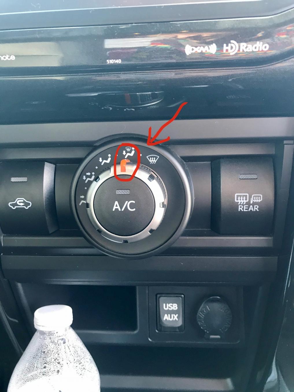

Does anyone know how to fix the fluorescent orange light that's on the AC knob which shows your selection? Do you think it would it be a fuse, bulb, or bad connection? The other two knobs work when the lights are on, but this one went out recently.

I'll check mine this evening but I don't think anything lights up on that panel other than A/C in the middle of the knob.
I remember looking at those AJT design climate control knobs and those lights do come out so I'm sure you can get replacements.

Looks like the light is behind the knob assembly and the orange piece draws in light from a lamp in the whole AC button assembly piece. It take two seconds and almost no tools to pop it out of the center console. Just unplug it from the harness and take a look at the back.
Lights up for sure, all icons and A/C inside and that orange notch. I wasn't paying attention to those until you brought this up.

I have the same problem with the orange indicator light on the AC light being out. Because this post shows up in any Google search related to this I figured I'd share what I've learned.
This style of AC controller isn't that common, 2016 +/- a year or two.
I removed and fully disassembled this assembly yesterday. There is no bulb, it is a led soldered to a circuit board. This lines up with another thread talking about upgrading to leds and that this is a soldered led. While I might be able to solder a new led in, this is outside of my DIY skill set. Also it was in a tricky location recessed being the AC button.
Going through Toyota parts this assembly is only sold as a unit, no parts within it. It sells for about $600. Searching ebay I find the assemblies from junked 4Runners are going for $125. I appreciate the ebayers including the picture of 4he crashes 4Runnwr in the listing.
So yeah I'm spending $125 to repair the little orange indicator light.
I post this in the hopes that someone can tell me how wrong I am and someone else is pointed to an cheaper solution.
I have the same problem with the orange indicator light on the AC knob being out. Because this post shows up in any Google search related to this I wanted to share what I've learned.
This style of AC control unit isn't that common, 2016 +/- a year or two.
I removed and fully disassembled this assembly yesterday. There is no bulb, it is an LED soldered to a circuit board. This lines up with another thread talking about upgrading to LEDs and that this is a soldered LES. I might be able to figure out soldering a new LED in, but I haven't been able to find any information on this. Also it was in a tricky location recessed behind the AC button.
Going through Toyota parts this assembly is only sold as a unit, no parts within it. It sells for about $600. Searching ebay I find the assemblies from junked 4Runners are going for $125. I appreciate the ebayers including the picture of the wrecked 4Runner in the listing.
I post this in the hopes that someone can tell me how wrong I am and someone else is pointed to a cheaper solution.
