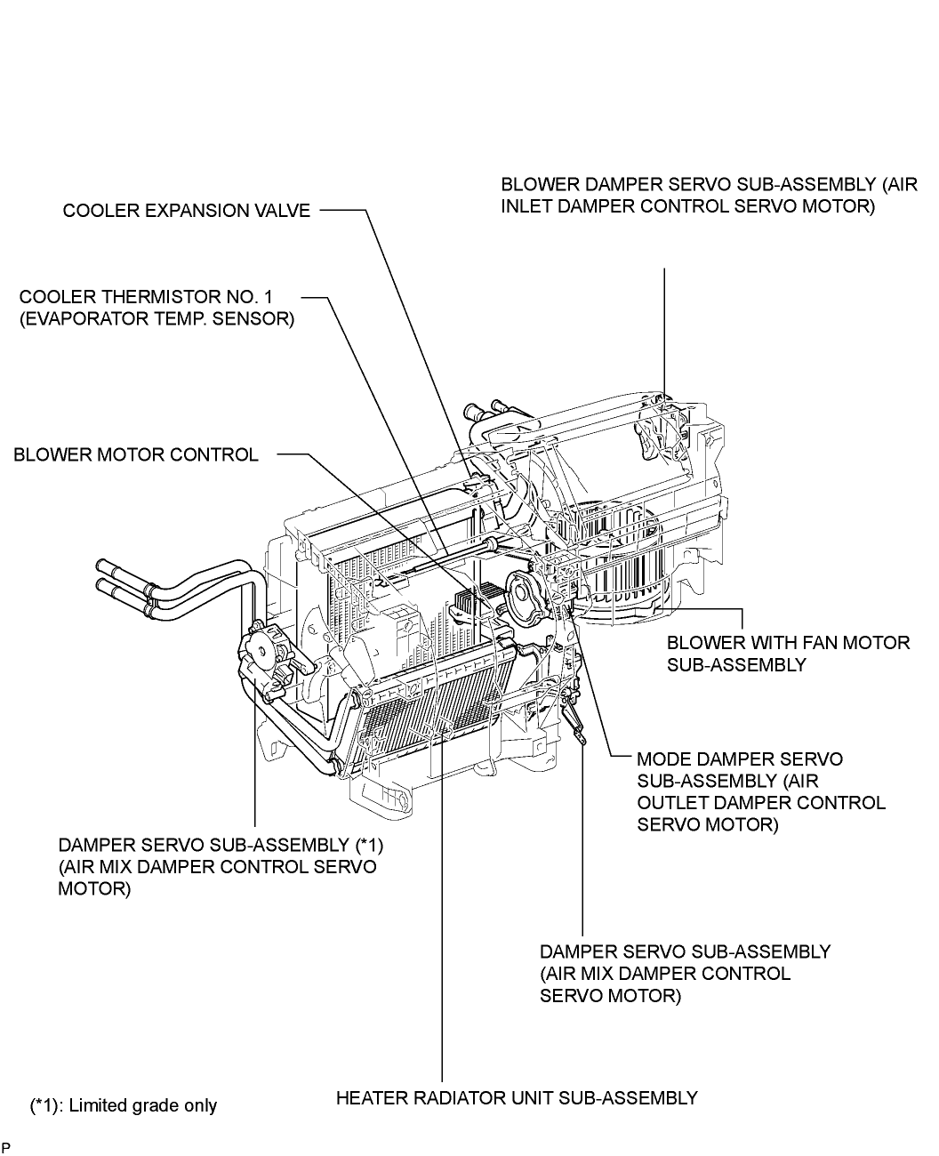

What are they saying needs repaired or replaced? To remove/replace the heater core which is just about the worst thing you can do behind the dash is 6 hours labor. I'm using this as a comparison.
Take a look at this so when you ask him you will have an idea.
  • 4R A:C.gif
