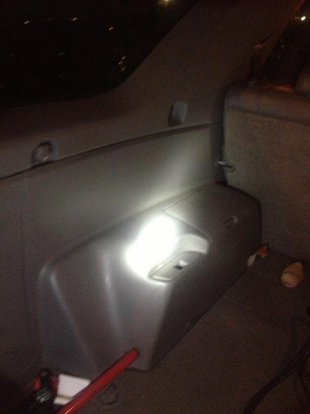

I have the AC 115 option in the center console, but it rarely works with my devices. I decided I wanted to wire up an inverter somewhere else in my truck. I was thinking the trunk. I was going to get a small one, maybe a cup shaped one (Amazon.com: PowerLine PowerCup 200/400 Watt Mobile Inverter with USB Power Port 90309: MP3 Players & Accessories) and cut some paneling and make it look factory. I was going to power it from the 12 V truck DC socket or the brake lights by installing another cigarette plug and leaving the inverter plugged into it (so if i ever want to move it, I won't have any issues and I can keep the rear 12v DC free)
This is where I was thinking of putting it: See attached picture, the bright spot next to the pocket in the wheel well. Or even in the pocket. Or whatever you guys suggest.
Any ideas welcome?

I have it posted right there where your light is. I used heavy duty velcro to mount it there. I'll take a photo tomorrow and upload it.
This is what I have.
images
Not sure how factory a fake coffee cup would look cut into the back trim there. I would get something like above and mount it where that flip up door is
I was just thinking of the coffee cup since I was going to cut into the paneling and try and mount it flush and the coffee cup has a flat surface. Has anyone every cut into that little flip up door? I want to know if there would be space to mount it inside there. I figure

I also have that AC 115V option on my limited and it doesn't always work like i'd like. I know the panel that you're talking about (on the drivers side) comes out pretty easily. just take off the bottom trip piece where your hatch is, and then remove the cargo net hooks/clips and it just pops off. beware there is a bolt/screw inside the cubby on both sides that will also have to come off.

Oh yea, the light in the pix is from a switch I added so I would not need the key to power the rear plug. Added as a mod of frustration - 3 different times I left the key after using the rear plug and killed the battery.
