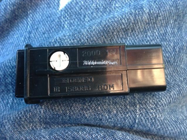

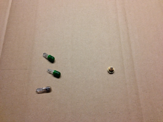

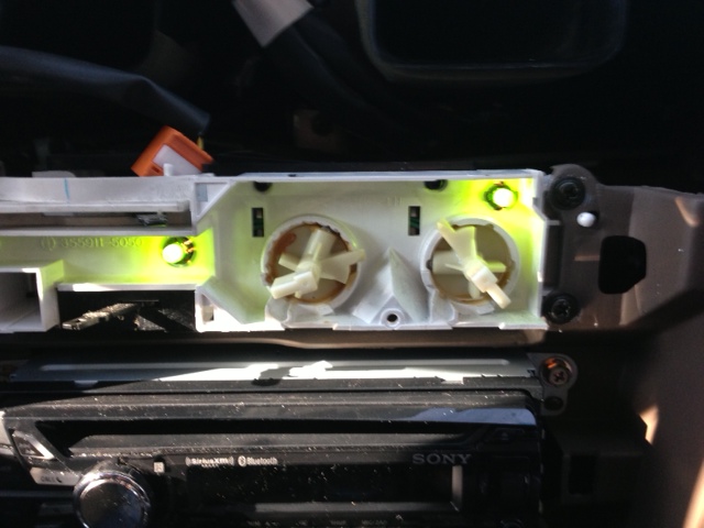

I final got around to replacing the burnt out bulbs for my 2000 non-auto AC controls. It was pretty easy; remove the emergency brake cover, shift cover and dash radio panel. Removing the last panel requires unplugging several connections. Carefully remove AC knobs and pop AC dash cover off. When you remove the front cover the AC button will also pop out. No need to remove unit, I used long noise pliers and pulled to 2 bulbs out. ( 90010-05152). I also replaced the twist in AC button bulb (88607-16010). I did not replace the cig lighter bulb, it was like $11, the ashtray is the same bulb as the control panel without the green condoms.
