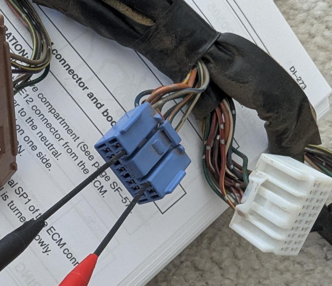

I'm still chasing a p0500. I thought it was the cluster. It's not. I started poking around testing resistance in the wiring and I'm seeing roughly 3 MΩs when testing the resistance between the pins of the different connectors that plug into the combination meter, against the wire that send speed signal to the ECU. I thought I would see infinite resistance, but I'm wondering if I have a short in the harness. I see 0.2 Ω when testing the grounds with the negative battery terminal. So at least the grounds are good.

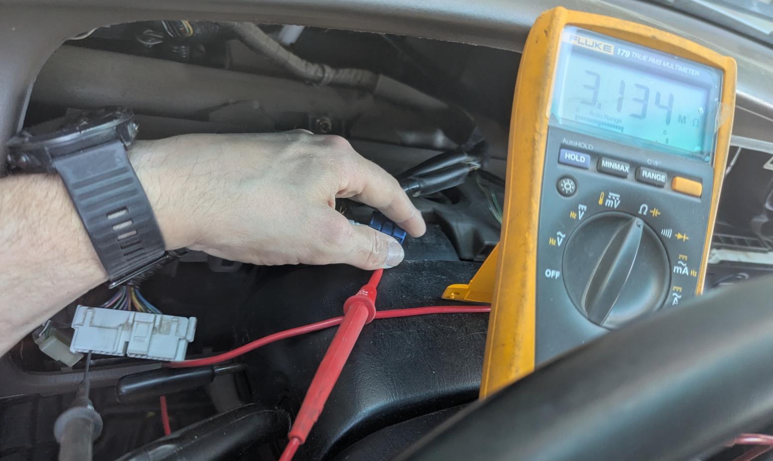

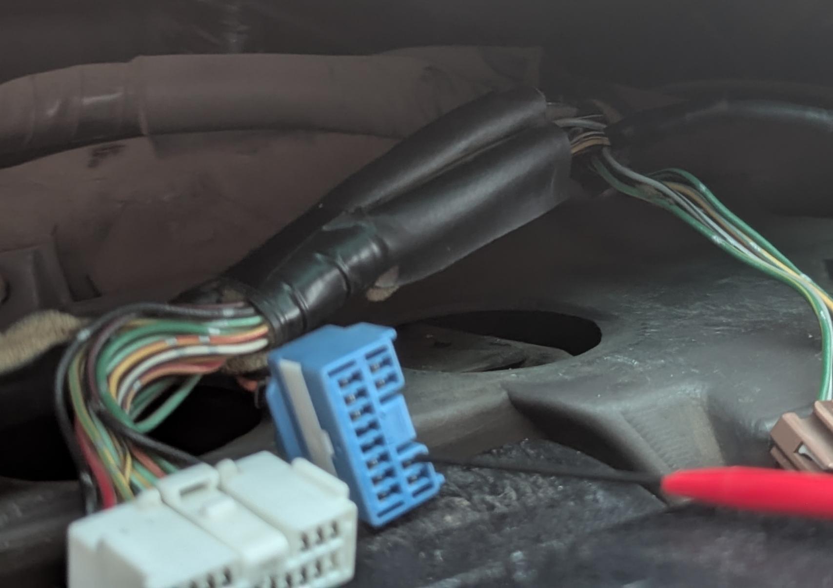

Full transparency. I'm trying to learn how to diagnose electrical problems. I have tested end to end, the orange/green wire that carries the vehicle speed signal to the ECU and recorded 0.6Ω. I tested that same wire to ground and recorded 3.034 MΩ. So then I started testing against other pins in other connectors, and for the most part am getting 3.0ish MΩ. I thought I would see 0L infinite resistance, but I'm not. So now I'll trying to find anything in the FSM to give me guidance. I did see there is a junction block between the cluster and the ECU. So I'm looking for that as well.

3Mohms is basically an open circuit (unless you are doing certain high-precision scientific activities...). The resistance between your two hands (try it!) is under 1Mohm most of the time (varies with conditions).
To put it in perspective, the continuity tester built-in to most multimeters is looking for less than 20-60ohms, in most cases.
Also, without specialized test equipment, anything below about 1.5ohms should be considered a dead short (with a good meter like you have - maybe 2 ohms for cheaper ones).
In the pic you seem to be holding the probe point with your finger(s). Don't touch the metal tip of the probe with anything. Besides affecting your reading it can also be a safety hazard, not where your testing now but anytime you're taking a reading on anything ; safety first.
My multimeter is very old. Your Fluke just has a setting for ohms and will give you the actual readout. My old meter has settings for R X 1, 10, 1K and 10K. For resistance I almost always just use R X 10 unless I'm checking components like resisters. Wire has resistance, poor/old/corroded connections have resistance, lots of things have resistance and it can change with the humidity in the air. Charlie is right to ignore the low resistance numbers.
I'm not understanding if you're trying to check the wire in the bundles themselves or to what they're connected to. I think the P0500 is the speed sensor and I've not had that issue; sorry. Have you taken a reading on the sensors? My experience with other things has been rare to have a wiring harness problem. The only one I ever encountered was on an outboard motor with a molded connector; dead short. You know a dead short because the fuse is blown or the wire insulator has melted (and the fuse is blown).

Nothing like a little zap to feel young again. LOL I appreciate the concern. Those lead extensions are insulated up to the very tip.
At this point, I've checked wheel sensors and they seem to be good. I'm getting signal to the combination meter as evidenced by the speedo and tac functioning, with no ABS lights. I did swap out the cluster because I had found two burned resistors on the circuit board that mounts to the back. That didn't fix it. The odds that I replaced a bad cluster with a bad cluster isn't zero, but I'm checking everything downstream. That's why I'm testing the integrity of the harness. Unfortunately, I don't own an oscilloscope, so I can't properly test signal to the ECU. I may buy one. $$$$ I've seen evidence that this code can be due to a failing alternator, so I'm about to go test that. If that's the cause, I'll be relieved, but I'll also throw the alternator into space.
