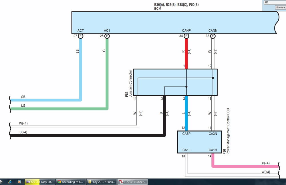

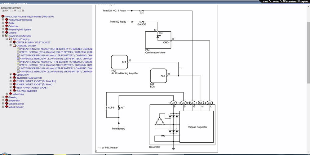

I have voltage gauges for both my AGM batteries in my truck that I've monitored for almost 5 years and I've never seen it charge over 14.0V and that was usually only briefly on start up if the battery was really low. Usually the alternator is putting out 13.0 or 13.1V with in 10 minutes of start up and 13.2-13.3V at night with the lights on.
The reason for this is our trucks and many modern vehicles have Power Management ECU's to take the load off the alternator and thus conserve energy and thus mpgs. It's on a Canbus tied into the main ECU as well as others and may,and I say may likely be the reason for the possible troubles with the one guy who used a high output alternator.I've learned to stay away from the factory wiring and wire all my own circuits with separate fuse boxes and relays.
I've learned to manage my batteries with a pair of isolators,one being the Cole Hersee 200A Smart relay and the other a switched 200A relay. I learned to still top them off with a proper AGM charger every couple of months because as I had one Odyssey go bad. Mostly that was because I was using my 20 year old Diehard charger on it that was not meant for charging AGM's and it plates sulfated til one went bad. I bought a Diehard Platinum 31M and havn't had problems since getting a new charger.Next up for me is a solar charger for the roof made for dual AGM's as my truck doesn't get driven much anymore like it used to and does sit outside most days.

[MENTION=8206]harper7[/MENTION] this kind of concludes that without the proper external battery management (an external charger that one would need to hook up to the car), using a single Odyssey 31M-PC2150 or Diehard Platinum 31M is NOT the ultimate solution for our trucks when we want to run a fridge or so always ON accessories. :(
I was hoping that it is the solution, but further research yields unfavorable answer (sucks that I have an Odyssey 31M-PC2150 in transit already).
This may also be the reason why many 4Runner(or automobile) owner ran into problems with these batteries (otherwise should be very good and should have an ultra long life).
