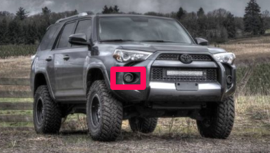

My tires/rims/lift kit is in the works... Thanks guys all for your suggestions. Will go easy with 3 inches, that's enough for now for Hawai'i Island. Also found the amazing 'nox lux black emblems' which I'm super excited about!
One last question, I can't seem to find the answer online anywhere.....
What is your advice for getting purple fog lights? I've seen the Baja Fog Pocket kits in yellow only. I've only seen a vinyl purple film, but I think that'll be too ghetto looking.
Mahalos!
