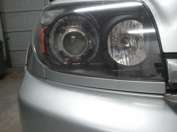

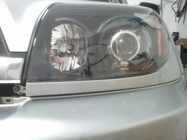

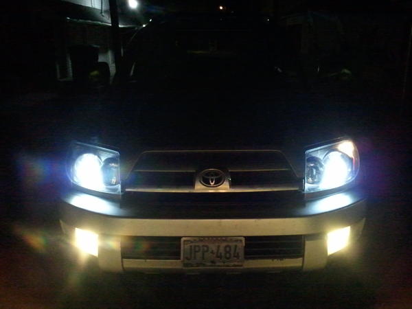

Finally got the my reflector cut to hold the Acura TL projector! I haven't finished closing up my headlamps but the projectors are glued and straight! Photos were taken on my phone so not the greatest quality. I really like how the fog lights fill in right below the low beams.

Low beam and fog lights:
Still need to wire the high beam and cover the projectors with a shroud. Thinking of using an acrylic sheet vacuum formed over the projectors since nothing stock covers it fully, and then paint the acrylic black.

It's a real joy to be back behind Bi-Xenon headlights!

I haven't molded shrouds yet to cover everything. We all know it's not finished yet, but it doesn't look that bad without them. Don't flame me, I'll get to them.
If you plan on tackling this project on your own, BEWARE!
The projectors will fit, but it is tight! I ended up trimming the black bezel so the solenoid would fit and could be adjusted with the stock screws. I saw pictures of CookieRoe's from Lightwerkz, and it looks like they trimmed the back part.
I made a jig to help mount the projectors on the reflector for a straight cut off, but ended up not using it because the fit had to be perfect for the headlamp to seal. Instead, I mounted the headlamp assembly back and reflector on the 4Runner and with the headlights turned on, used JB Quick Weld to mount them straight - working fast before everything heats up!
A lot of headaches and frustration, but the output is remarkable!
