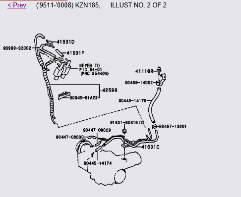

Well it works fine direct on mine.
Uses a single vac line that "T's" to both VSVs and just runs to the manifold, and a vac line to each port on the ADD actuator.
Maybe it was a diesel thing as they ran a vac pump.
I'd be tempted to plumb it in like that and see how it goes.. its easily reversable and if there are no obvious ill effacts, it just eliminates another point of failure.

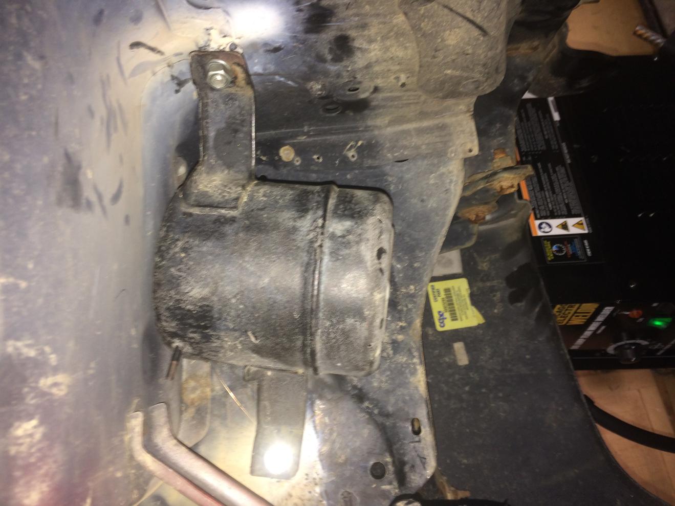

Finally got around to fixing mine this weekend. I ended up just welding two bolts in essentially the same location, just tucked further up into the wheel well. We'll see if it works out. Can't get my phone to load a picture though....
the original bolting location was to the lower backside of the white spot, just out of the camera shot
