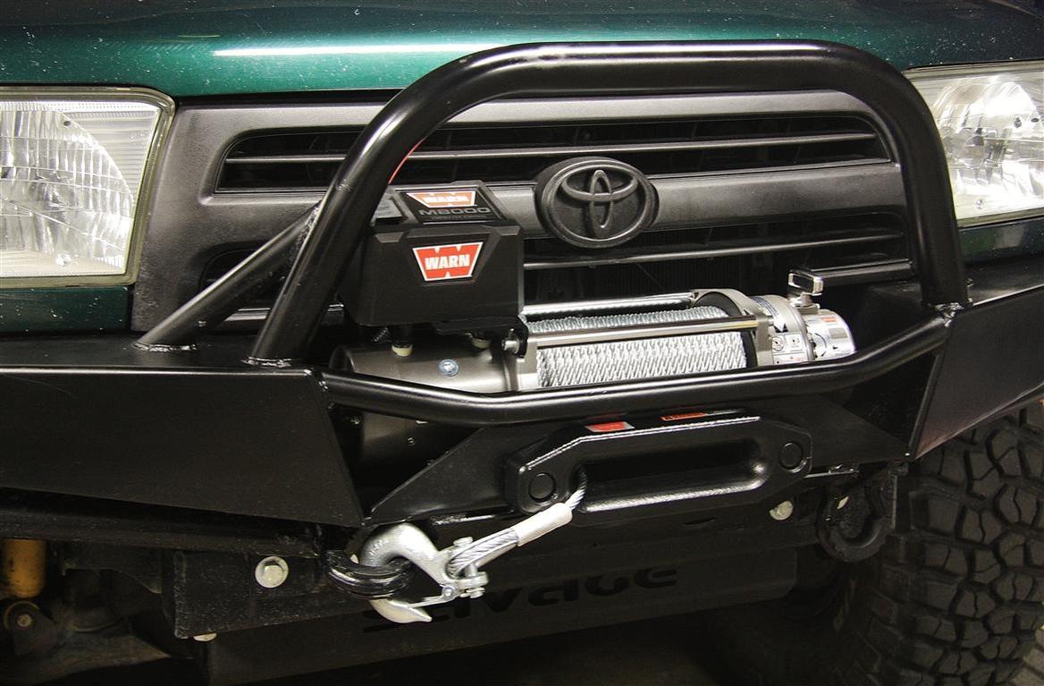

Finally got the winch installed last night. I love the snug, clean fit and feels solid as a rock.

was it easy to install with bumper on car?
4th gens will require clocking the disengagement knob to clear the grill. Otherwise its simple.
One thing I will will mention. We just installed the Superwinch LP8500 on a 4th gen on Friday. What looks like a removable solenoid box, isn't. We also had to clock it back 90* to clear the grill.
But, a legit remote solenoid winch will be easy to install. Just open the hood and you have all the room in the world to work.
I will work on getting some install instructions for the 4th gen guys up by Monday. Its a fairly labor intensive install to get the stock bumper off. But, once off, we will show you where to trim and move back A/C lines.
I was pretty easy on my 3rd Gen. Once you open the hood and pop the grille off there's pretty good access. I bought the extra bracket that allows the control box to be mounted at an angle so it clears a vast majority of the grille. I only had to remove the bottom rung on the left sde whitch was super easy to cut off with a hacksaw blade.
Can you elaborate on the bracket and clearance? Any photos?
Here is the bracket I used and a few pics.
Just clears the grille guard on the left side
The winch clears the front bumper plate by no more than 1/8" when bolted down but gives a clean, fitted look.
You can see here that the control box will not lay flat without hitting the grille, but a little bit of angle is just enough to clear it.

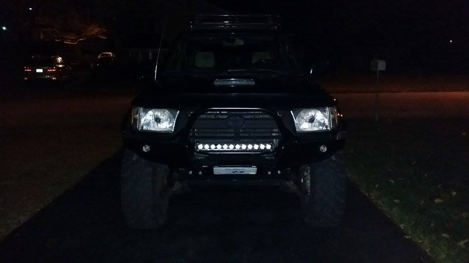

Test fitted the bumper before paint. Certainly looks bad ass and is really beefy. I'm glad I purchased this one over others, I just didn't like the delay. All in all, that's the only complaint. It sure is a great, quality piece no doubt.
