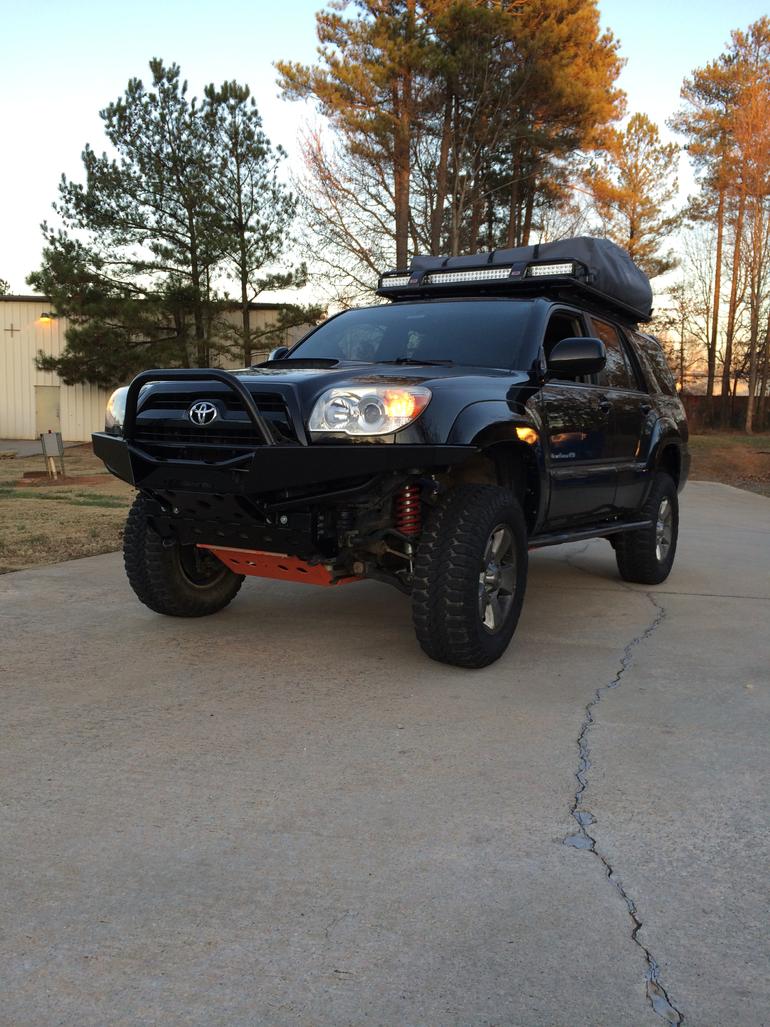

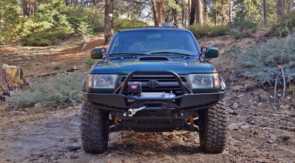

Here's mine with the winch finally installed. I've been wheelin' out in the forest about 4 days a week right now since work is slow this time of year. Having sooo much fun with my Runner and still can't get over how killer it looks with the AOR in the front.
I hope everyone enjoys their new bumpers as much as I do and thanks again to NYC for putting this all together.
GVL (Tim)

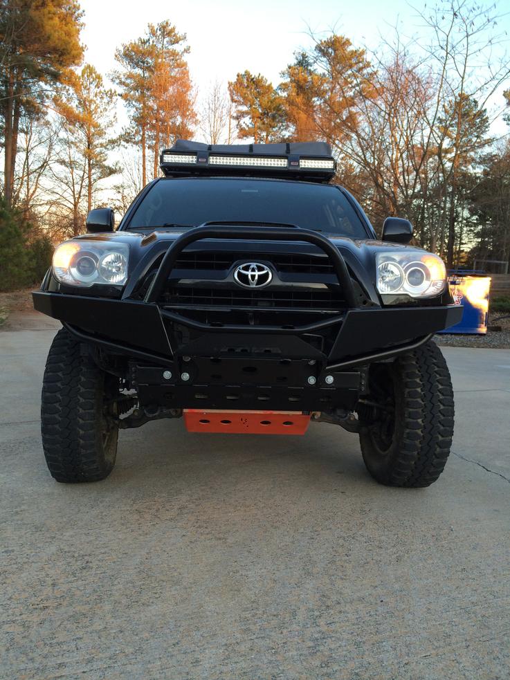

Alrighty!!! So its on and I am super super happy with the outcome. Scott tell your guys they did a excellent job and I and very very happy. Winch and light bar and 33's coming soon!!!! Thanks
