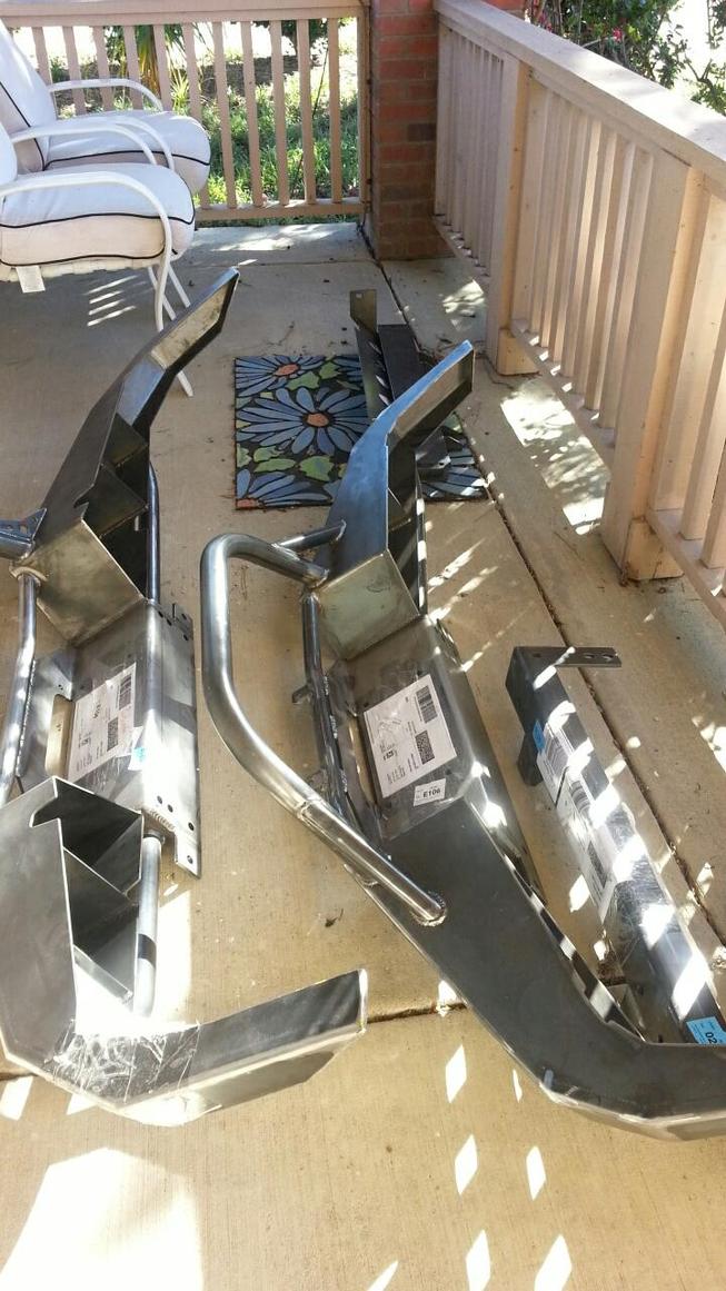

Woohoo! Thanks scotty [MENTION=17736]AddictedOffroad[/MENTION]! They'll be on by the 5th! Merry Christmas to me!

Very nice :thumb3: So Technically your having 3 Christmases Today, Thursday and the day you put them on cause it's gonna be like Christmas all over again:bluejump:
Were there ever any instructions for installing on a 3rd gen? Yeah I am just now getting around to installing mine lol
Basically loosely bolt on the crossmember and then the bumper. Tighten everything up, while aligning the bumper to fit the body lines. Once everything is nice and tight, drill the hole for the bolt that goes through the frame rail. When you're all done, get someone to weld the crossmember to the frame if you can. I'm waiting till i have enough scrap to pickup some sliders and have it all done at the same time.
