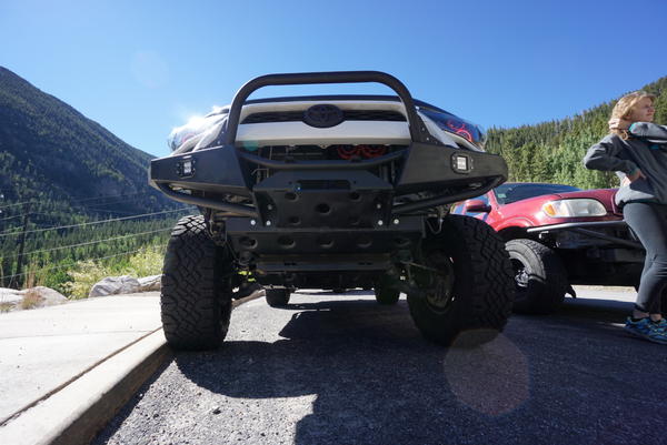

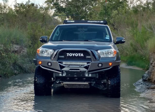

how bright are the turn signals/DRLs compared to the stock ones?
They are on in this pic
No sure. I would say they are not as bright overall...
The stock ones were regular bulbs and put out a lot of light... These are LEDs and the light is way more focused with less lumens
One big downside with LEDs as blinkers is you have the choice of using DRLs or having a normal blink on the turn signals. The blinker circuit will fast blink unless it sees enough load. To simulate the load of a regular bulb.. you can wire in a resistor in parallel. But the resistor will burn out if it has to run all the time as the DRLs. I can't think of another easy solution.

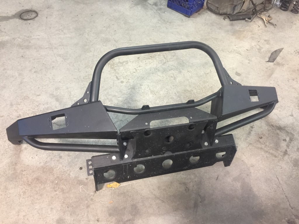

If anyone is interested in the original 2014+ prototype bumper, we have it for sale for $800. It will include the LED Fogs lights, mounting crossmember, etc. Its been painted textured black.

Why is this one discounted?
Sent from my SAMSUNG-SM-G890A using Tapatalk
It was the original prototype and was run for a few weeks. So, there will be some light scratches, chipped paint, and a slightly different mounting crossmember. Its also a hair shorter in length than the production model will be.
It will still function 100% just like the original version though, but its a "used" bumper.
