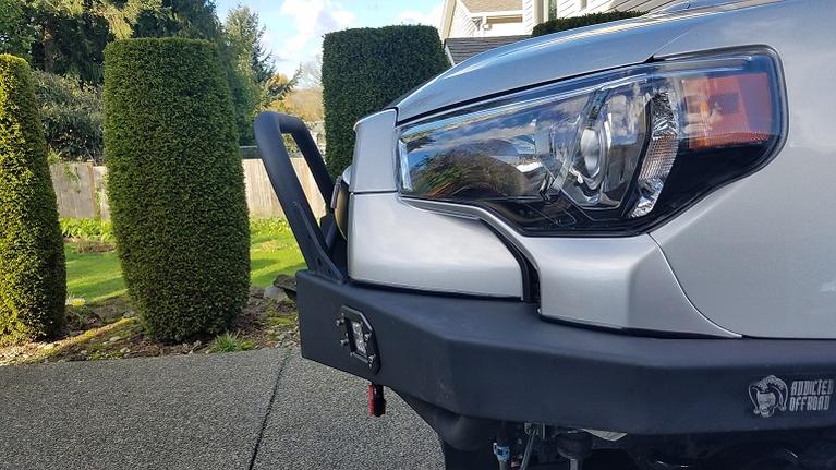

I will give one warning about this bumper that should be obvious.. But the corners out near the fenders are not that strong. They really don't need to be since they are up so high.. and you are probably going to take out a fender anyway if you make contact in that area... but it is flexible there and not going to hold up if you hit something out on the tip of that wing.. The rest of it is super stout, but those corners are not near as strong as something like a shockworks.... It's fine as long as your contact is close to where the tubes are... The very tips of the wings is all I would be concerned about.
Yea I thought it was just me. I leaned on the wing doing something and it flexed a bit...
But you shouldn't ever end up hitting it though.

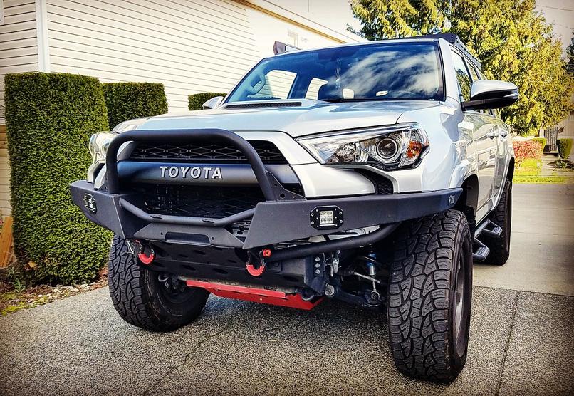

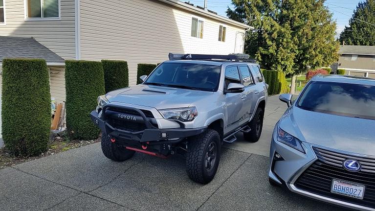

Best looking 5th gen bumper. It goes so well with the '14+ models' sharp angles.
[MENTION=117117]Seattle206[/MENTION] looks good. Having the lower mesh makes it look more complet. Btw, do you have a dead straight front view without the headlights on and a top front down view? Thx.

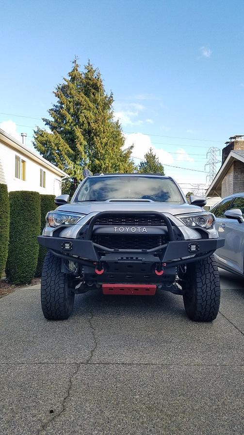

Here is a front view shot. I'll try to get a top down shot later by the time I get off work it'll be dark out.

Update on my Addicted Offroad bumper. Not sure if your guy are experiencing this since I purchased the original prototype '14+ bumper. When it was installed the fitment was very tight. No gap in between the fender/bumper. Looks very clean that way.
The left side wing was making excessive contact with my fender when going over speed bumps or bumpy roads. At first I thought it was my suspension clunking but after I re-torqued all the suspension bolts the noise was still there.
After taking my rig to some offroad trails I noticed that the bumpers finish has rubbed off from contacting my fenders. Took off the bumper, used a plasma cutter and reamer to elongate up the mounting holes. I should've made the holes a little smaller but I able to adjust the bumper to give me a 1/2" gap. I can make it fit tighter if I wanted. This is the lowest the bumper can go and I have to use 1/2-13x1.5 Allen bolts to tighten the top two holes. Used additional grade 8 washers on the other 4 mounting bolts for extra grab. Now, no noise and a bit of gap for those flexing situations.

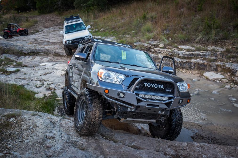

Some pics of my rig and the AO bumper in action(before the modifications)
You can see the edge of the fender where the bumper was rubbing against it.
Humm. I don't seem to have any noise or rubbing... And I wheel and flex my truck all the time. I have about 1/4 max of clearance between fender and the bumper. First time out I did have the fender liner makeing noise... but quickly resolved that..
