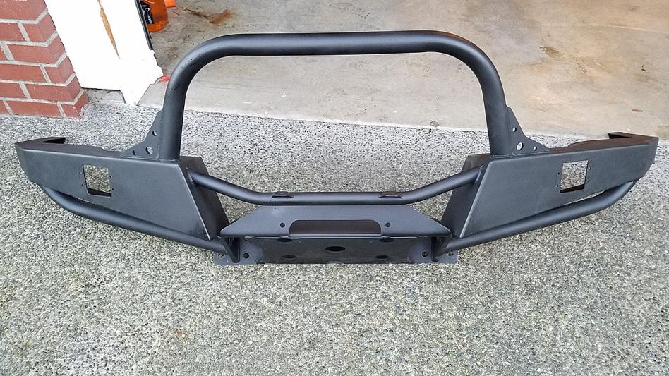

Addicted Offroad's new 5th gen 4runner bumper!

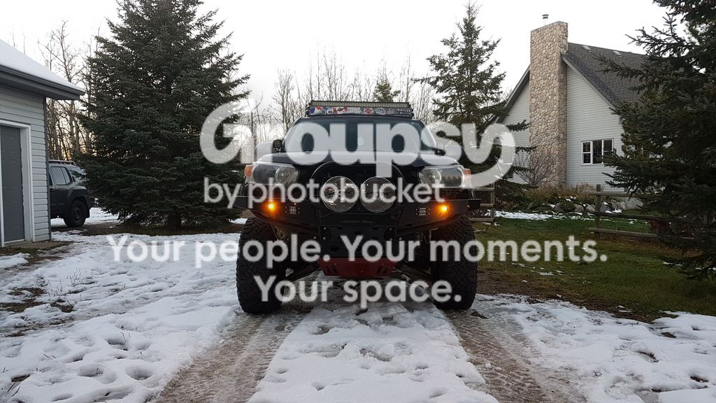

Got a chance to clean up the runner and forgot to post in here. Here is the factor55 fairlead and prolink installed with some red shackles. Loving the look so far and can't wait to test it out in the winter. Will have some action shots after this the wheeling trip this weekend.
[MENTION=115024]ManhstuhT4R[/MENTION], mos def the meanest looking 5th gen on this forum.
I did get my Addicted bumper today.

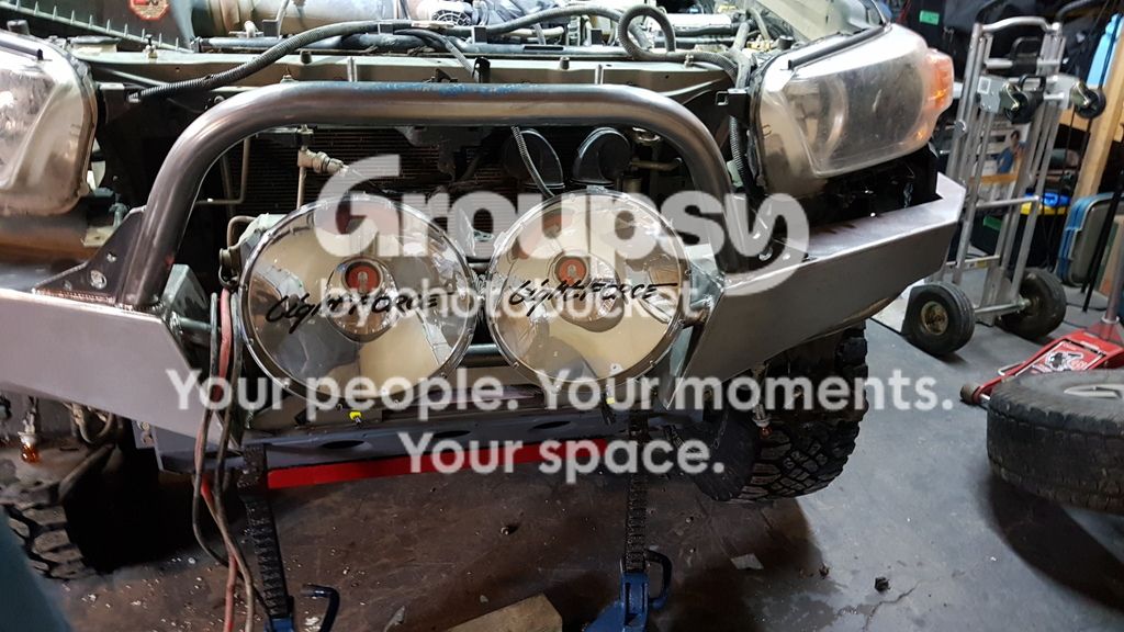

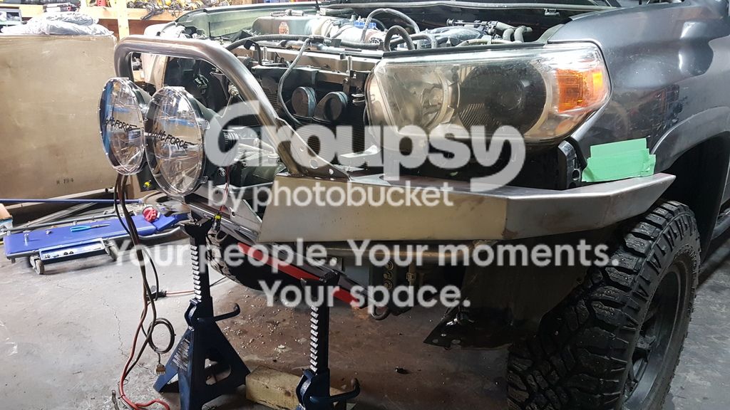

Plan to pull the trigger by the end of the week on this! those who have them mounted up already/ [MENTION=17736]AddictedOffroad[/MENTION] would a set of Lightforce 240's fit the light bar mounting location?
I would guess that they would. Depends mainly on the bracket on the lights. Also might block access to the spool lever on your winch depending on its configuration. There seems to be plenty of room though.
Light itself is 9.5". Housing is wider from the specs I see. So, they are likely wider than 10".
This was the spec I saw when I looked them up (the housing is very thin). So I'm guessing they would work.
hey look! they fit!

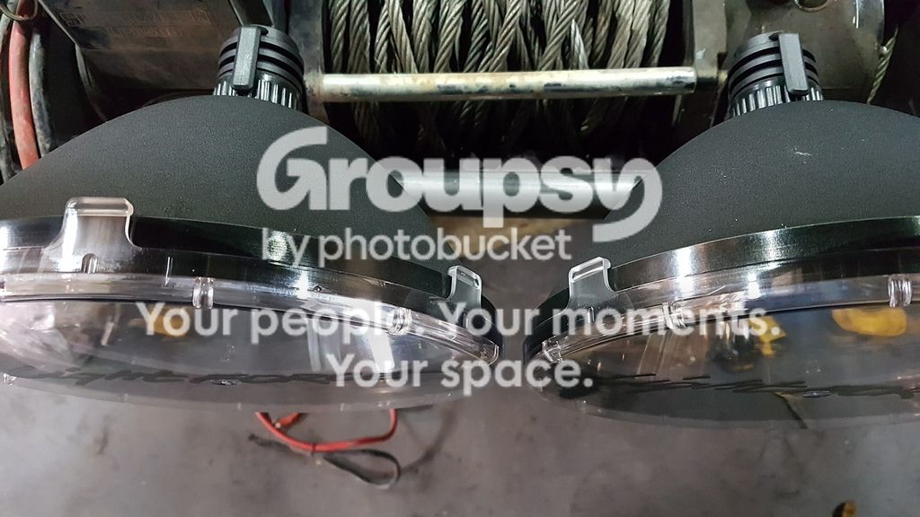

no clearance issues with my winch either, though I did have to bend the brackets for the hard line a bit to make everything fit
Looks good but I'll be surprised if those two lights don't touch due to vibration and beat each other up. If they're a single pedestal base mount its bound to happen...
Possibly, the mount is solid when all the hardware is appropriately tightened. If it becomes an issue I can just aim them slightly outbound, thereby creating a larger gap
