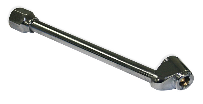

I use one of these things. Fills both ways so you don't have to drop the tire.
Pull vs push as it were.

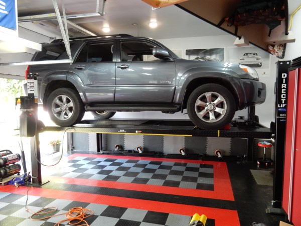

You can do it from underneath without lowering the tire.
But then I have a lift too that makes it easier :bluejump:
OK, now I am officially Jealous..................:wow2:
