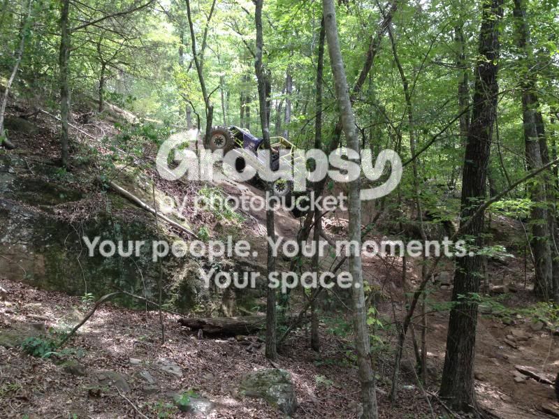

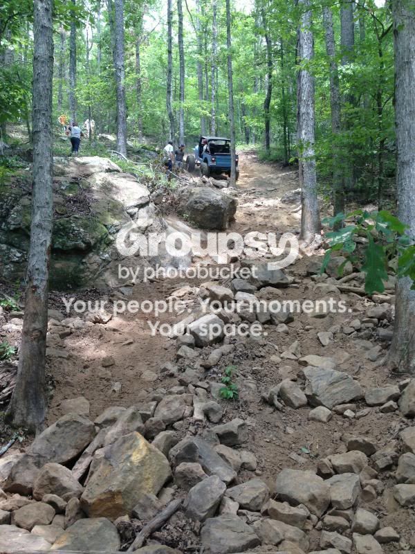

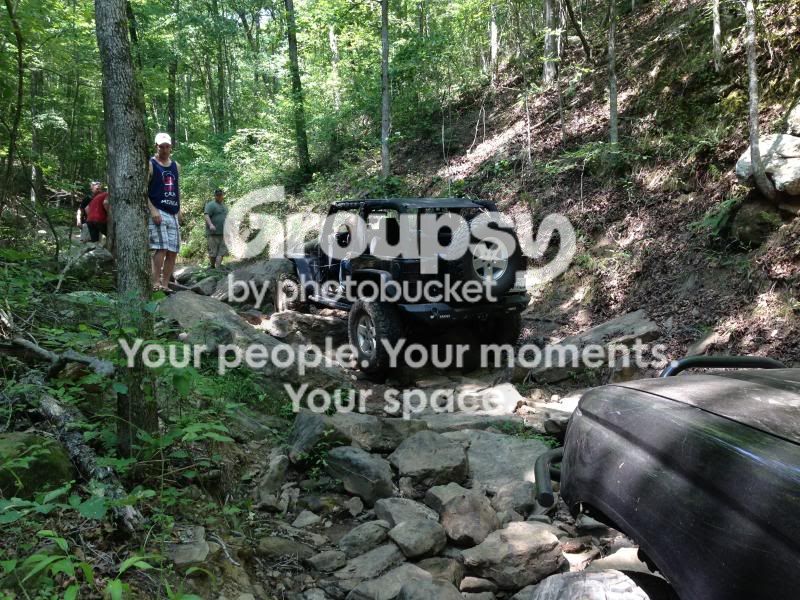

I think that waterfall is one of the more photogenic obstacles I've seen on web... It's sweet to watch.
I'm surprised the km2's didn't hook up on that one obstacle! What psi have you been taking them down to with the beadlocks?? Beadlocks are the one thing I should have put a bit more money into when i bought my wheels.
Yeah it makes for some great pics for sure. Yeah you can't tell in the video but that rock is actually really slick from so many people spinning tires on it over the years. If it was like the rock to the left and right of it than I could have walk up it no problem and with a little more skinny pedal I think I could have made it up even with the slick rock.
In the rocks I've been running somewhere between 8-10 PSI any lower and I'd be concerned about hitting my wheels/rings on rocks. With the 17's there isn't just a ton of sidewall with 35's as you know. Back when I ran 315/75/16's I'd run around 12 PSI and never had any issue with blowing beads but it sure is nice to have reassurance of beadlocks. I figure after I SAS and move to 37's I'll probably run around 8 PSI being that I'll have a little more sidewall to work with.

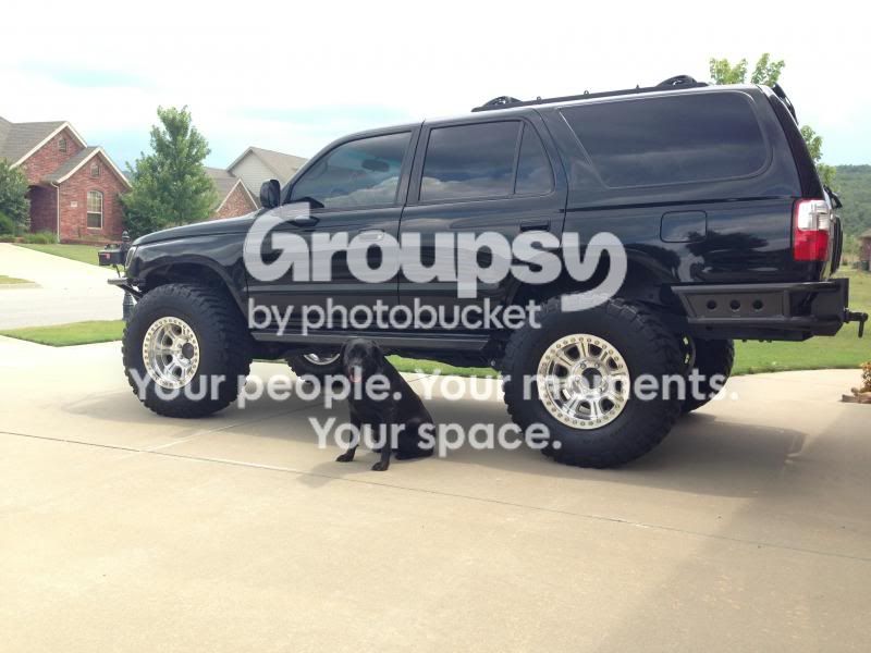

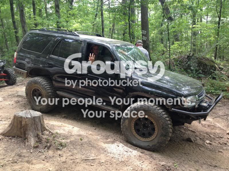

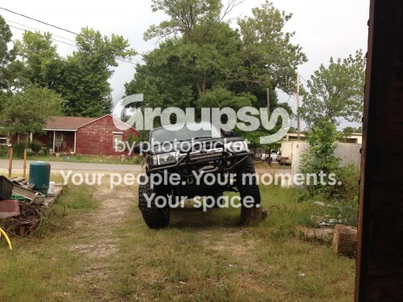

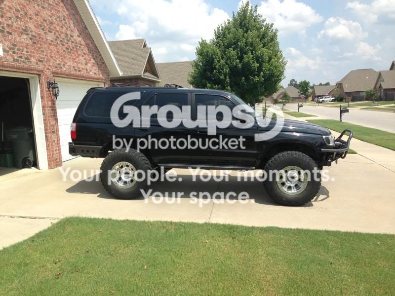

New wheels are on. 17x9.5x6on5.5 Raceline Beadlocks. I was able to remove my front wheel spacers and still no rubbing even at full lock.
I'm tired if seeing your driveway queen.. get this thing out in the woods already and put some scratches on it :D
Those wheels look good! Whats the backspace/offset of them? I'm still getting a bit of a frame rub with mine, but I really don't want to put my spacers back on.

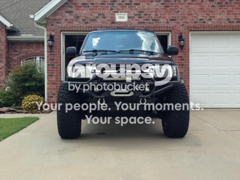

What's it look like from the front? How far do they poke out.
Looks sick!!!:cheers:

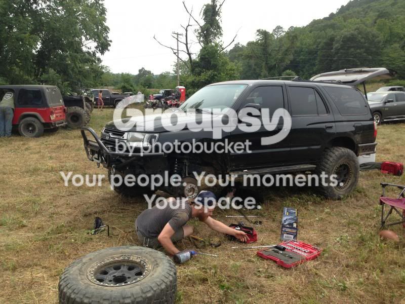

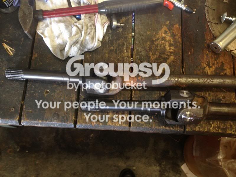

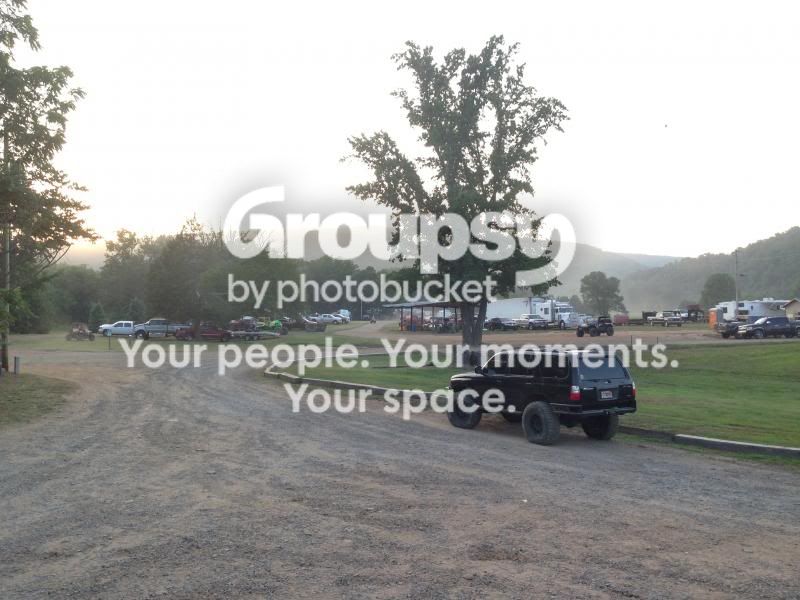

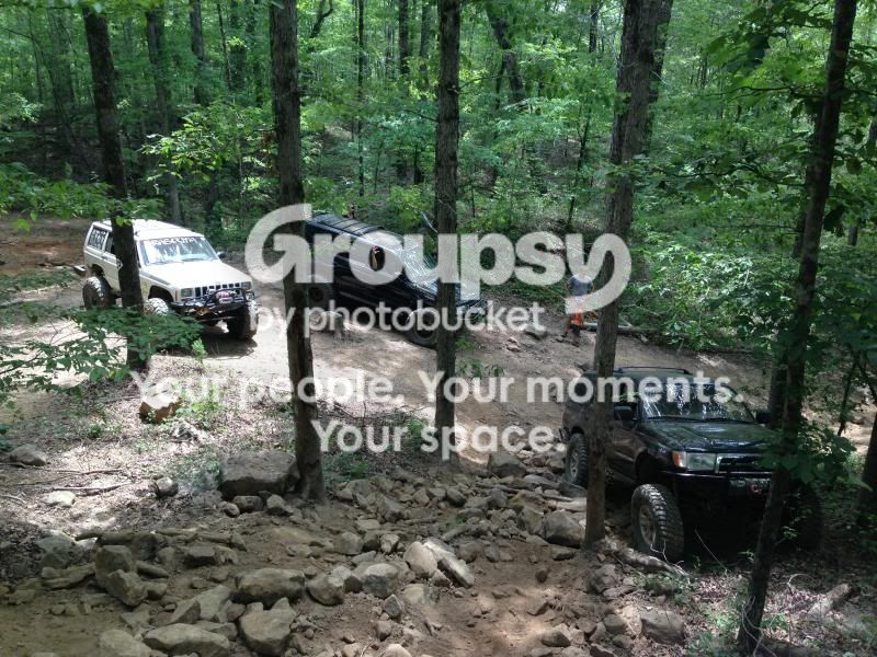

Well I took it out the the weekend of the 12th for 4x4th of July at Byrds adventure center. Mid way through the first day 4 trails in I hear my compressor kick on and just keeps going I knew I had a problem. One of the guys behind me started yelling my gas cap was smoking. I popped the door on the gas cap and was about to crap my self before until I realized it was just the breather tube from my rear diff. Something was wrong with the ARB inside the rear diff but I didn't have any spare parts for it with me so I just said screw it and decided to wheel the rest of the weekend open in the rear and locked up front (even though I knew this would be hard on the front end). Ended up hitting several more trails and ended up busting a front CV have to say I kinda saw it coming but no biggie.
Didn't take much for pictures but here's a couple from the trip and at least one picture of it not sitting in my driveway lol
Thanks man! They are 17x9.5 with 4" Backspacing

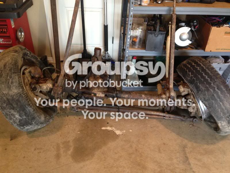

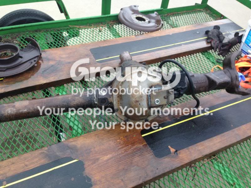

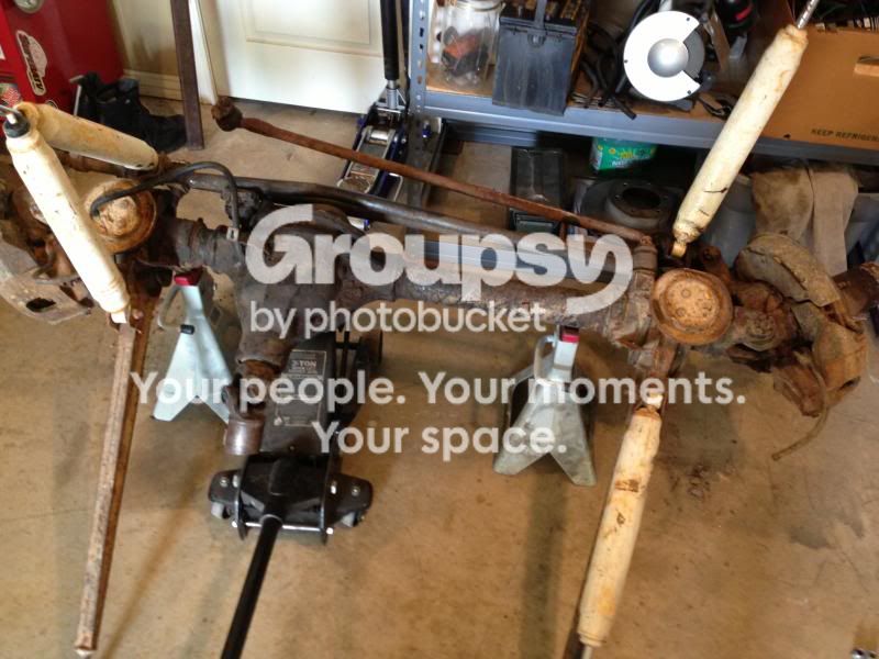

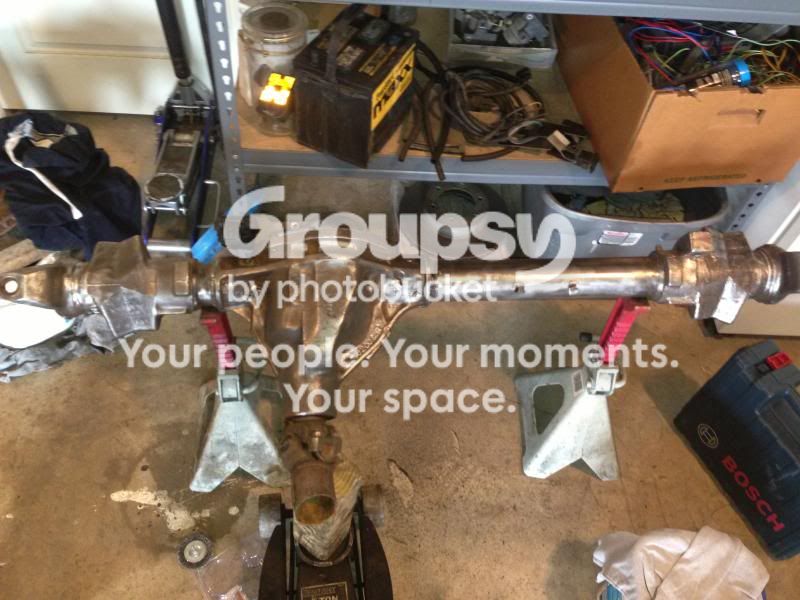

My first purchase was a high pinion 5 lug Dana 44 drivers drop with 4.10's out of a ford Bronco. It came with cromo's inner and outer, warn non-premium lockouts, and a detroit electric locker.

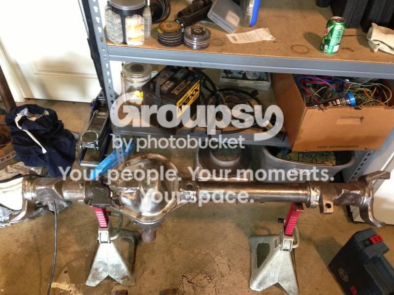

Needless to say I had and still have a lot of work to get this axle stripped down, cleaned up, re-geared, and converted to 6 lug outers. First thing was to take it down to the bare minimum and power wash the crap out of it.
And then a few hours with a wire wheel
Now because this was a 5 lug ford axle I had to change everything knuckles out to chevy 6 lug including the outer stub shaft. So I found a plane jane dana44 on craigslist that had flat top knuckles for $100 so I bought it and took what I needed. And then started ordering parts. Still a few parts to order but getting much closer.

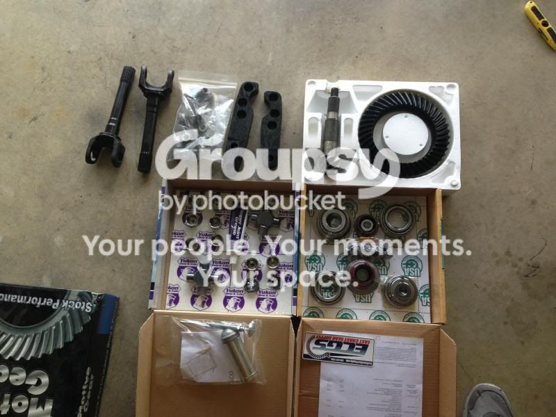

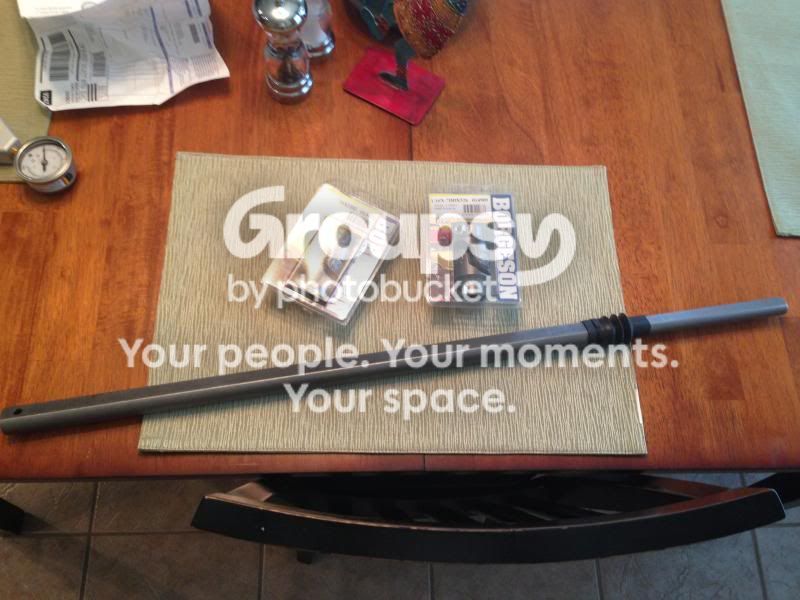

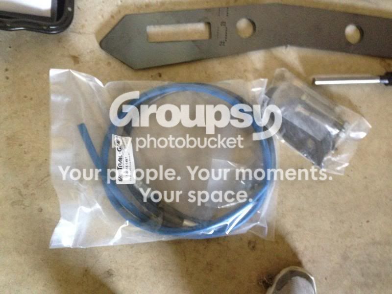

Things I've ordered so far some are still shipping.
-5.38 reverse cut gears
-Master install kit

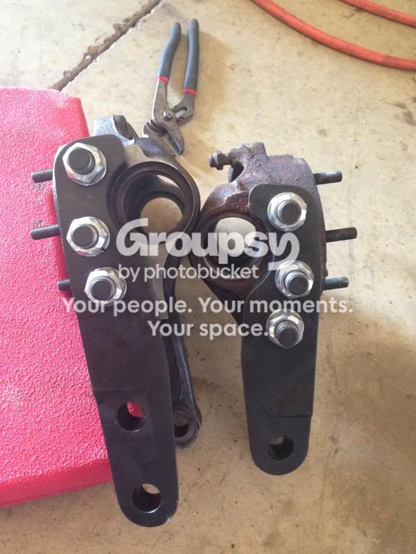

-High steer arms
-New chromo stub shafts (chevy length)
-Yukon super joints

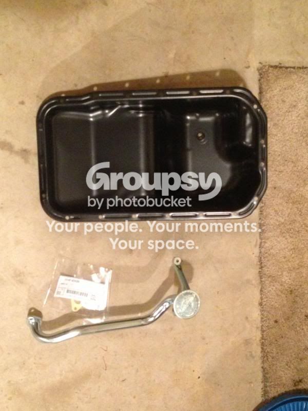

-T-100 Oil pan
-Steering linkage w/borgeson joints
-Frame plates
-power steering hoses
-12" ORI's
-All pro shock/coilover towers
-Warn Premium lockout's
-ORI single fill kit
-Firewall kit
-Tapped IFS steering box
-Drop pitman arm
