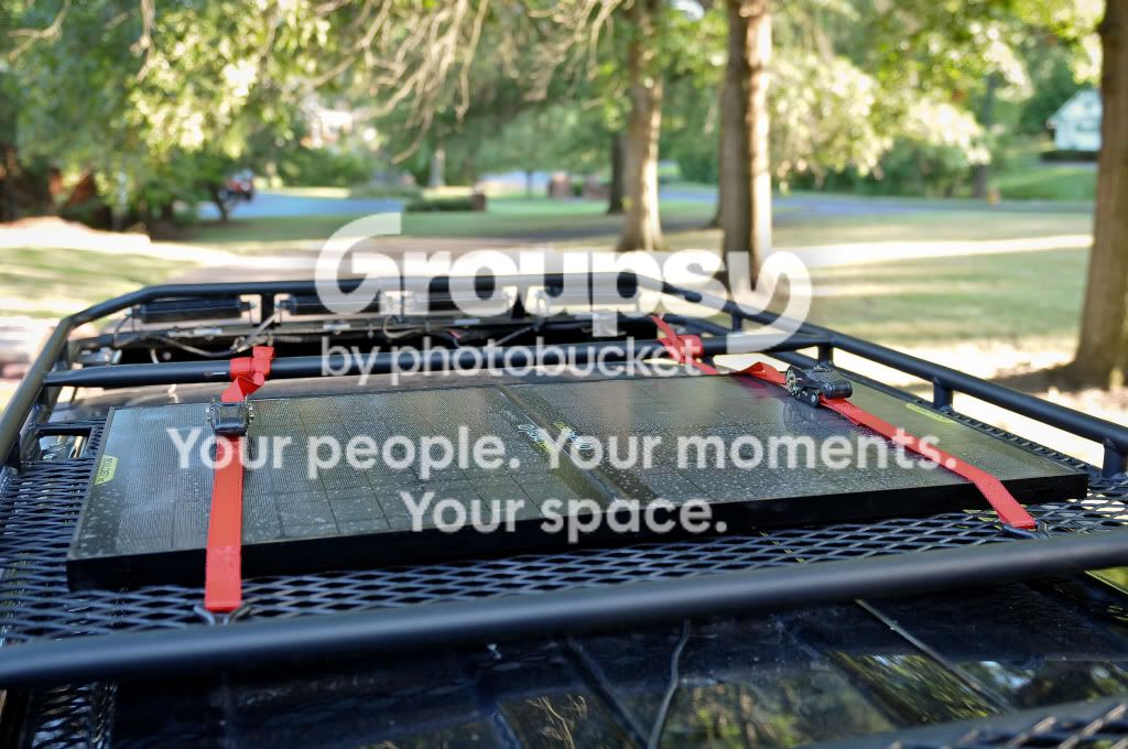

Also got around to installing the GoalZero boulder 30s on my roof. Ran the charging cable to the trunk, down the pillar, and behind the ARB, into the goal zero 350 extreme battery. It does take quite some time to do a full charge. You have to be in direct sunlight for 10-14 hours to charge a full battery. I had this on the go, got about 40% extra battery while on the hwy. The battery only died once at the start, but that was going from 60 degrees to 31 degrees, too much power.
hf7.jpg~original
Zip tie those bad boys down! You're cutting potential energy out of the equation with those ratchet straps (but you knew that). I've had solar panels on the top of my truck for a while and zip ties keep them in place quite nicely.
I'm a little iffy about zip ties holding those down, I've had ties pop off before, I like the added security of the straps. I don't like to think of what would happen to some $600 panels flying off on the hwy lol.
If that one inch of space is so important for extra rays, then why not use some good old high quality woven rope? Keeps a low profile and much stronger than a zip tie...also easy to remove...you just need to know how to tie a good knot.
I'll look into that. I mean these aren't staying on my truck for the rest of the year. I mainly had them on to power my fridge for the trip to Colorado, now that I'm back, I'll probably use it a handful of times before retiring it for the season.

What do you guys think about putting a solar panel UNDER the rack. I know it would reduce sunlight but how much?
I promise they won't go anywhere. The boulder panels have 6ea mounting points. I've had mine zip tied for a couple of thousand miles with no issue whatsoever. Also, they're all not going to fail at one time, so if you start hearing the panels get loose then just pull over!
It's impossible to say unless you actually do it, but I wouldn't bother. At best you're going to get panels with 22% efficiency in direct sunlight. I've had 84 watts worth of panels on the top of my truck at once, and the BEST I got was half of that at any given time because the angle is so poor. Put them under the rack and I bet you'll cut it in half (at least) once again.

I saw somewhere in expo forum where they put it under the roof rack but with a slide tray so they can pull it out only when camping.
