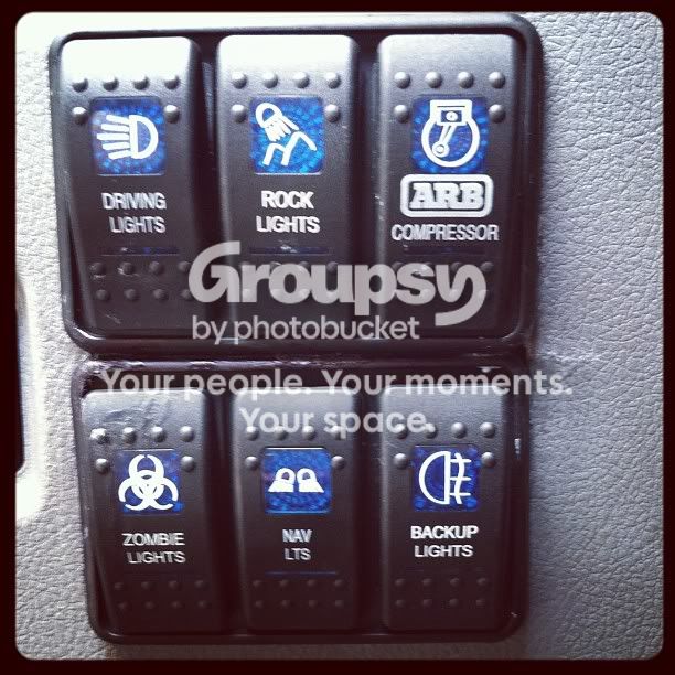

Holy crow that's alot of lights. Where did you mount all the switches at?
Sorry for the crappy iphone pic. But the switches are mounted right under the 4 slot switch bank. The epoxy got kind of sloppy while doing the installation.

all that awesome hard work and you mess up epoxy?? You should be ashamed of yourself, this makes me re-think how much I like you truck, slacker....sheesh.
hahaha
I didn't judge how far the metal bracket was behind it and the glue went everywhere when I pushed the switches in lol.

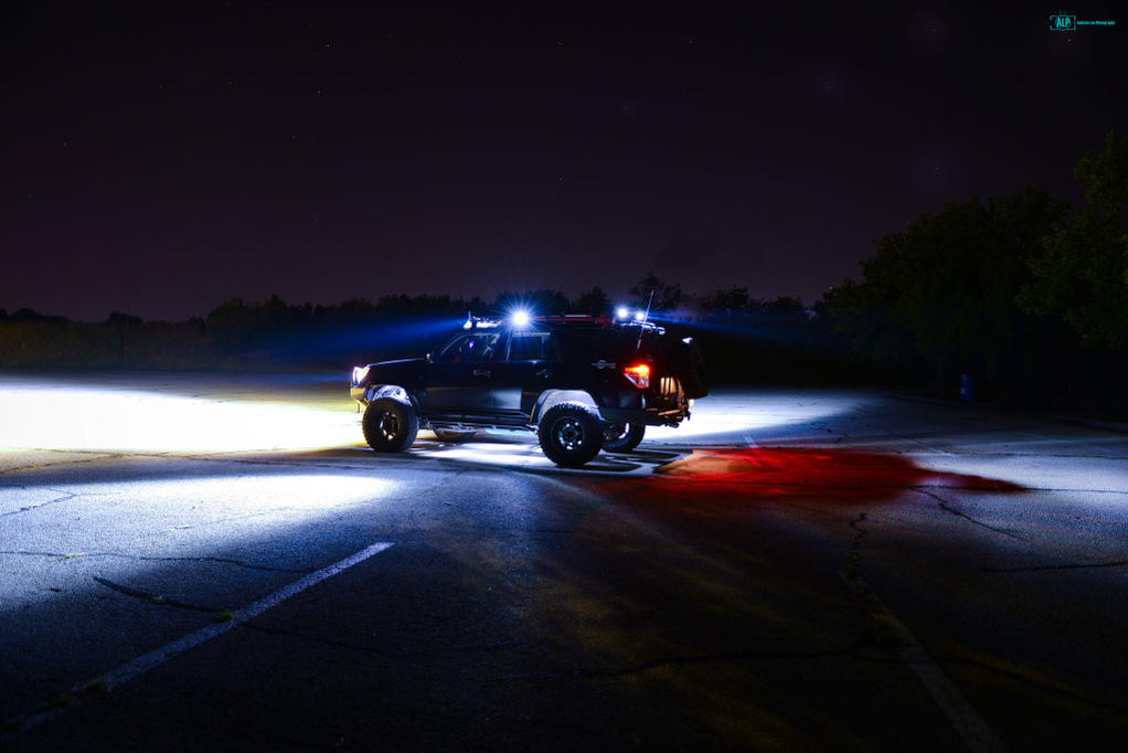

Great truck Andrew. I actually made your light pic my background photo on the computer as well. So awesome. Will PM you soon if you're still doing the Satoshi Grill mod side project you had going but I know you had a backlog. Keep up the great modding and pics
E.T. just phoned home and look what showed up.
Wait...Andrew, were you even born when E.T. came out?
Your spaceship...I mean truck, looks awesome.

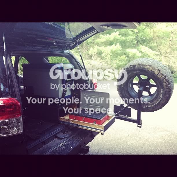

No major updates, just wanted to share my new nifty drawer.
Had one of my buddies help me build a drawer for my fridge and grill. Basically just 3/4's ply with 100lbs slides. Backside has a battery tray to keep the drawer from tipping over when the fridge slides out. The grill is a Primus profile bbq grill, connects straight up to any propane source.

Looks Good! At first glance I thought it was an ARB drawer.
If I may make a couple of suggestions:
If you are going to use the drawer for your grill maybe line it with some sheet metal and also try to keep the grill as far to the front of the drawer as possible. If you don't carry a fire extinguisher then please BUY ONE! If your extinguisher is mounted in the back then take it out before you light the grill, if a fire starts you may not be able to get to it. Let the grill cool before closing the drawer. Lastly keep it clean, build up of crud in the bottom of the grill is the number one cause of grill fires.

It's an older pic, the bottom is now lined with sheet metal. I keep a small extinguisher at the front and the rear, just incase. The primus has a crud tray that pops out for easy cleaning. My biggest tip ontop of everything Qjake has already said is burn what's left in your hose after closing the propane valve.

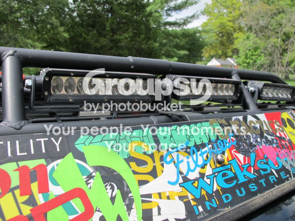

Hey Andrew - would you please do me a favor and post pics of how you mounted the 6" Rigid lights onto the Gobi, especially the center two. I have the two side ones mounted using the cradle by putting the wind deflector mounting arm thingy over the Rigid cradle mount but in hand fitting the two center ones they don't seem like they will fit.
Did your Gobi come with these silver light tab brackets? I haven't seen them on anyone elses rack except for mine. But basically these tabs will raise the cradles up to the level of the fairing mount thingy. We did have to cut down the screw just a bit.
