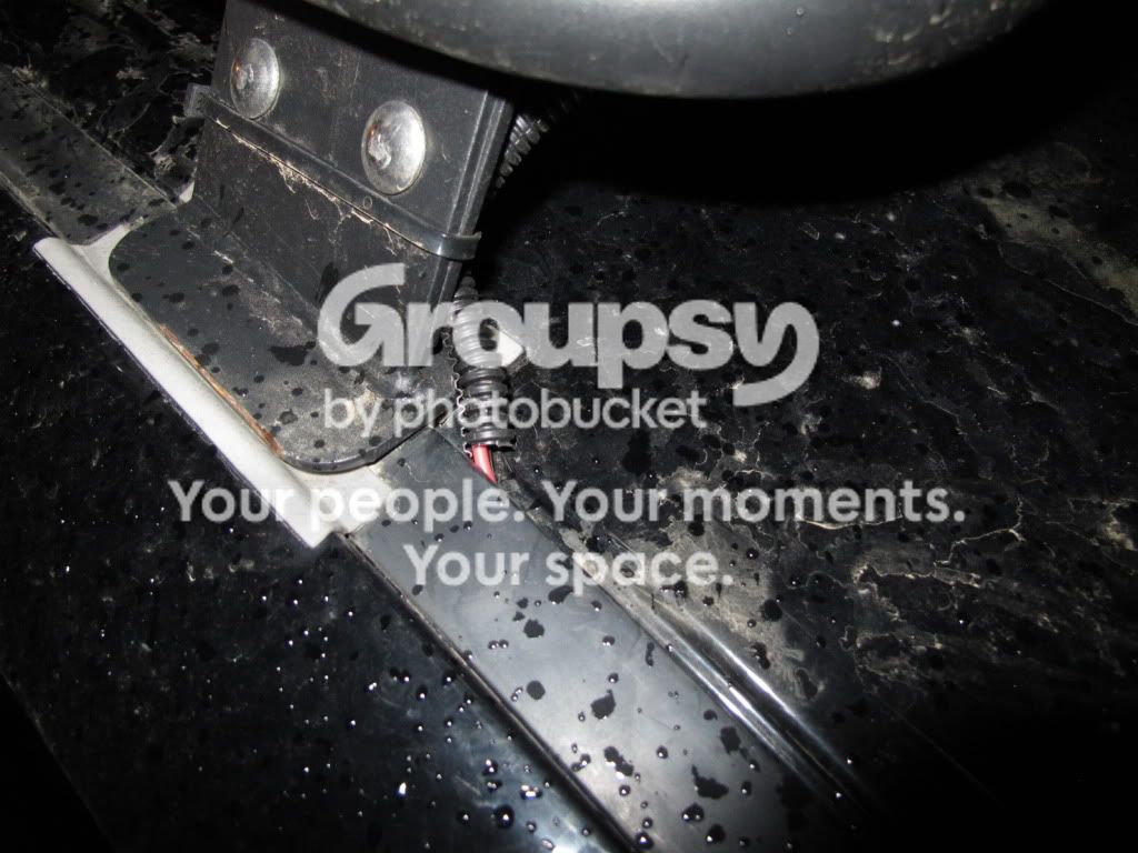

The lighting is really awesome. How did you run your wires from the roof? I am considering doing something similar, and would like some tips on running wires from the roof if you care to share! :)
I didn't do the install myself, but the way the shop did it was through the passenger side weather stripping on the roof, down the pillar, into the firewall.
Can you take a pic of how they went through the roof? Curious cause I ran mine all the way to the back and through the channel on the roof to the rear hatch and through a rubber grommet. I was looking for a way to shorten my wire run up a bit.

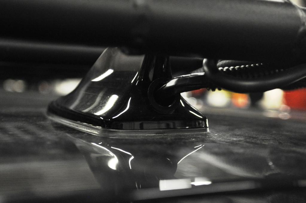

IMO, the best way to keep everything clean is to run it through your shark fin. That is, of course, if you aren't using your sat radio.
Sorry, Andrew. No threadjack! (no homo!)
And the secret is out- I saw your teaser for this in your thread.
GREAT IDEA!!!!! Why didn't I think of that? :redbrick:
More info please= How did you seal that sucker up?:cheers:
