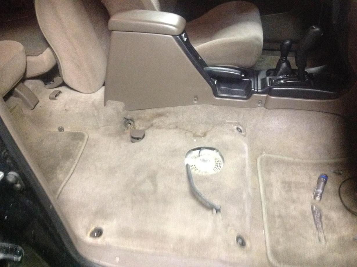

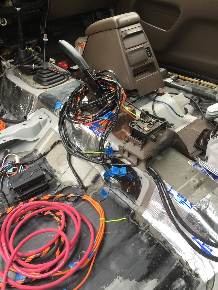

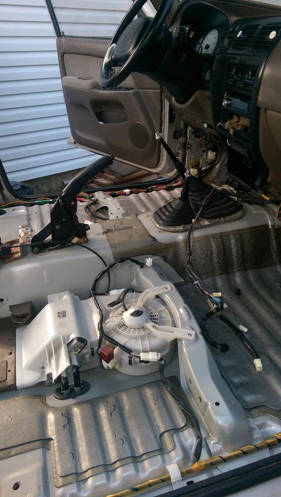

Following up on the rear heat info; it looks like deletion is fairly simple - an oblong plug in the floor pan, and a couple of hoses in the engine compartment, I'm thinking (haven't checked the OEM parts yet, but will.)
Going back and forth between swapping the console and just deleting the rear heat at the moment...
So another forum member has offered to swap consoles with me, thanks mattt4r!
For what it's worth, it looks like deletion would be fairly simple, if someone decided to go that route. Here are some photos I swiped from other threads showing the components and carpet changes (I'm not sure I'm going to be able to get my non-heat replacement carpet to work, though):
