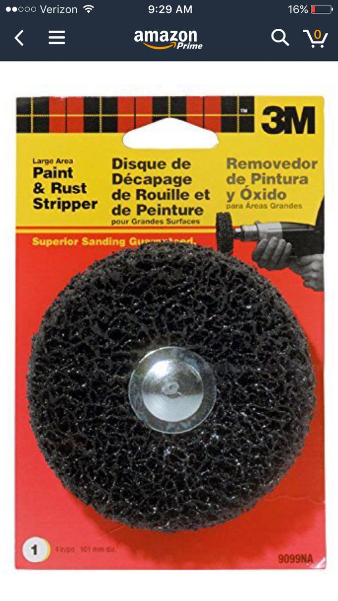

This works really well at getting down to bare metal compared to wire brush
So, i'm in the same boat as the OP, except the dealer I bought my runner from rattle can undercoated over the rust and it wasn't noticed right away when I bought it.. will that actually work with the rubberized undercoating? I bought some of the Mar-Hyde 1 step rust killer and went to work with a grinder wheel and brush cleaning the frame, but that gets gummed up way to quickly.
I don't have any experience removing undercoating with it...it would be worth a try though.
