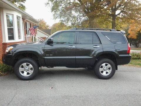

If the $1500.00 is for the suspension. Toytec Boss. I just installed it a couple weeks back and I love it so far. It's about $ 1,200.00. Tires as you can see in my Sig 265/70/17 Terra Grapplers. They have been very nice on and off road, and not noisy at all.
