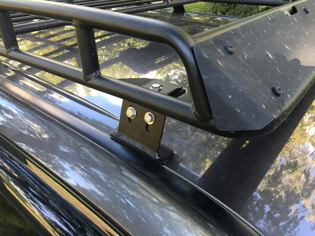

I had some minor denting and some marred paint under the old mounts. Got the new mounts in and installed without removing the entire rack. Anyone have any pics of the new front mounts for the long rack installed? Instructions seemed to indicate (I dont have them in front of me) that the front legs should bear on the gutter insert but mine do not reach the gutter. instead they stop short.

You have to play with that bolt and slide the mount back and fourth until it lines up. Took me awhile of playing to figure

Thanks!
I'll take another look at it. I thought I had that bolt adjusted as far to the outside as possible but maybe not.
I'm kind of thinking about going back to the old front mounts and putting some 3m paint protection film down underneath the feet. The double stick tape on the plastic gutter cover doesnt give me warm fuzzys. atleast the old foot spread the load out a bit.
I installed mine a few weeks ago. For some reason, the middle and rears seem higher than the previous mounts. My fronts, no matter how I had them adjusted, wouldn't touch the gutters. I had to move the entire rack back as far as it would possibly go to get them to touch. previously, they were only adjusted half way for height, and were putting pressure on the gutters. Has anyone else had this issue with the new mounts?
