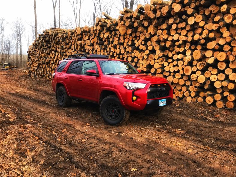

A little adventure I'd like to share. Found a logging road up near my family cabin and played with 4Lo, Crawl, etc. What a blast! The roads were a little frozen, so it wasn't as muddy as I would have hoped...but beggars can't be choosers. :hungry:

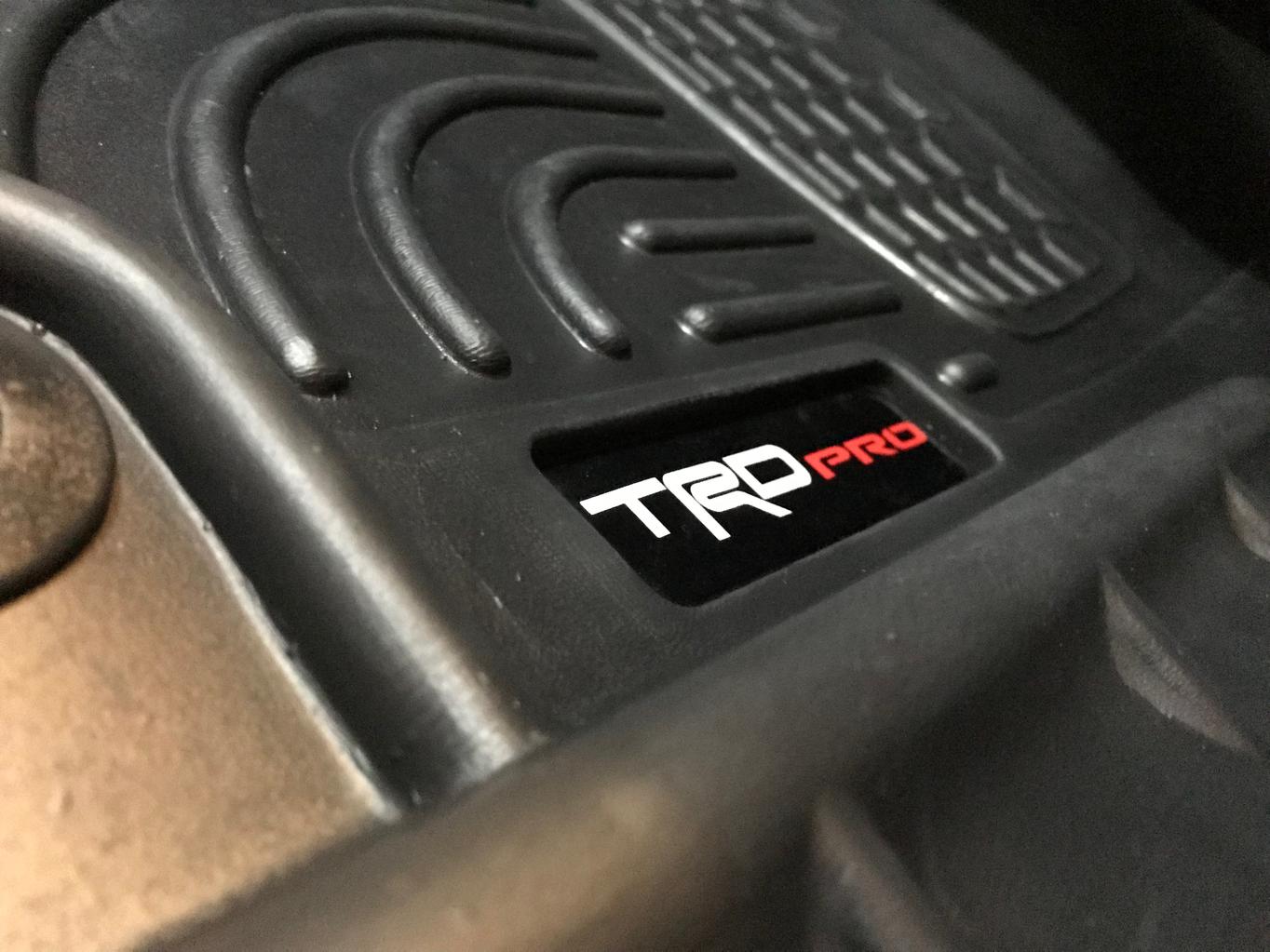

TRD Pro Floor-Mat Stickers
This a a little baby mod, but if you have read any of my thread, you would know that I like less expensive mods that provide a lot of flare (i.e. yellow fog lights, ROLA Roof Rack, shift knobs, Raptor lights, etc, etc).
Anyway, I bought these from a fellow T4R.org member in this thread. He is currently out of emblems, but I think he's planning on another run soon!
Quality and fit is pretty much identical to the Husky Liner sticker that I pulled out. $20 well spent...the devil is in the details ladies and gents :smokin:

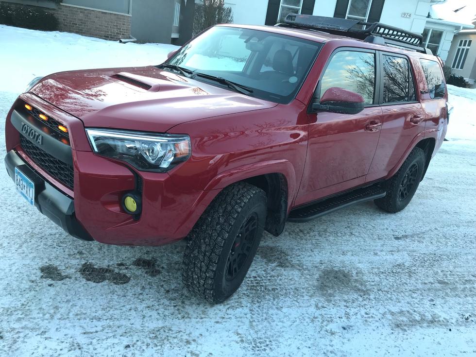

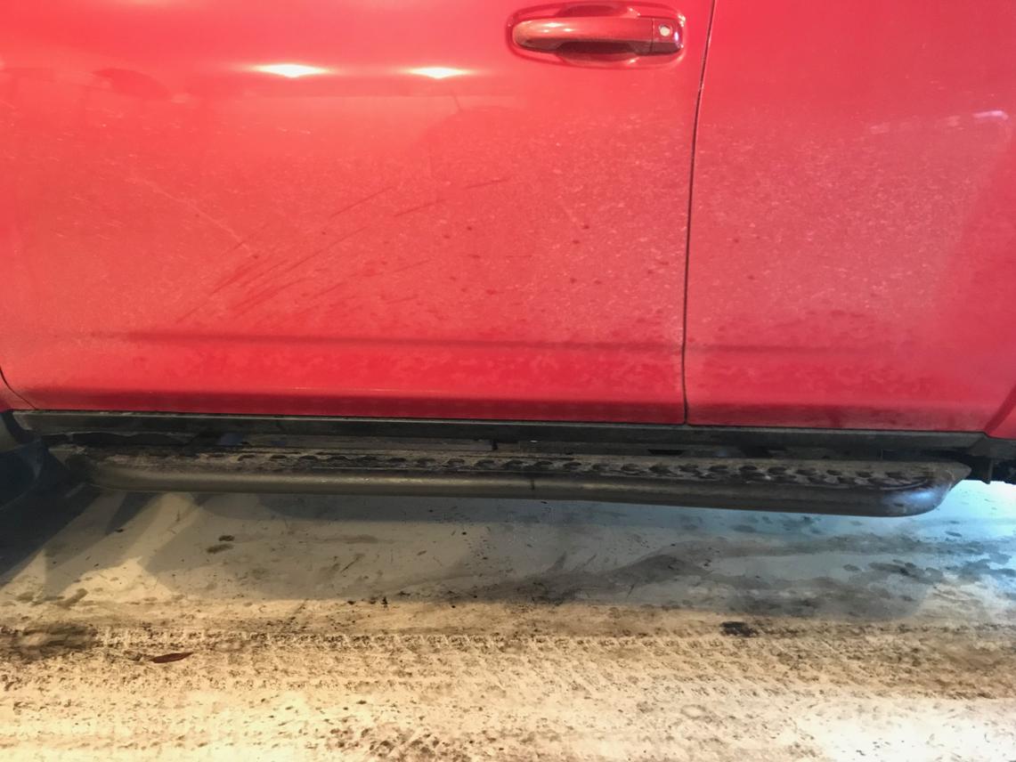

RCI Rock Sliders (Toytec Exclusive 5% Angle) (REMOVED)
Finally got around to getting my rock sliders installed! I need to thank my Dad because he got these as a Christmas gift for me! Thanks Paps!
My ultimate goal was to have a step to get into the truck. I was originally going to get N-Fabs, but I have heard they are awful steps, offer zero protection, and they rust out quickly. So that was a no go for me. I ended up discovering that some rock sliders also function as steps, so I narrowed my options down to Shrockworks, RCI, and Hefty Fab. The Shrockworks weight caught my attention at a low 45lbs, but the install is a pain according to some write-ups in the forums.......pass. The Hefty Fabs were a little heavier at 55-60 lbs, so I skipped those as well.
I ended up going with these Toytec Exclusive 5% angle sliders. Yes, these can only be found on Toytecs website. RCI does not offer these 5% angle sliders on their own site. They look great, the quality is legitimate, and they were at my door step in a week after ordering. Unfortunately, they are way heavier than the 45lbs advertisement. I weighed them in at 57 lbs per side. That was very disappointing....but not worth my time/effort to return them, or deal with crazy Shrockworks install. Not to mention, 8-12 week lead times. No thank you!
So here you go, RCI Sliders!
What I like so far:
-Functions well as a step
-High quality
-Easy install
-Function as a rock slider...obviously
-Offers some door ding protection
-Very fast shipping
-Look very sleek and nice
Install (2 Hours):
-Clean the salty mess off of the frame rails
-Remove clips for the parking brake line running along the frame
-Place slider onto a floor jack
-Move sliders into place accordingly (Height and width)
-Bolt into threaded holes in the frame
-Re-install parking brake clamps over the slider
-Lower jack
-Repeat for opposite side
Very easy/painless install overall!

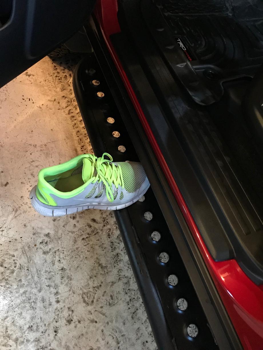

I saw those sliders and wasn’t sure I would like the 5 degree step but it looks much more usable. Does it stick out enough to use it as a step getting out or do you have to step over it and rub it on the back of your pants leg?

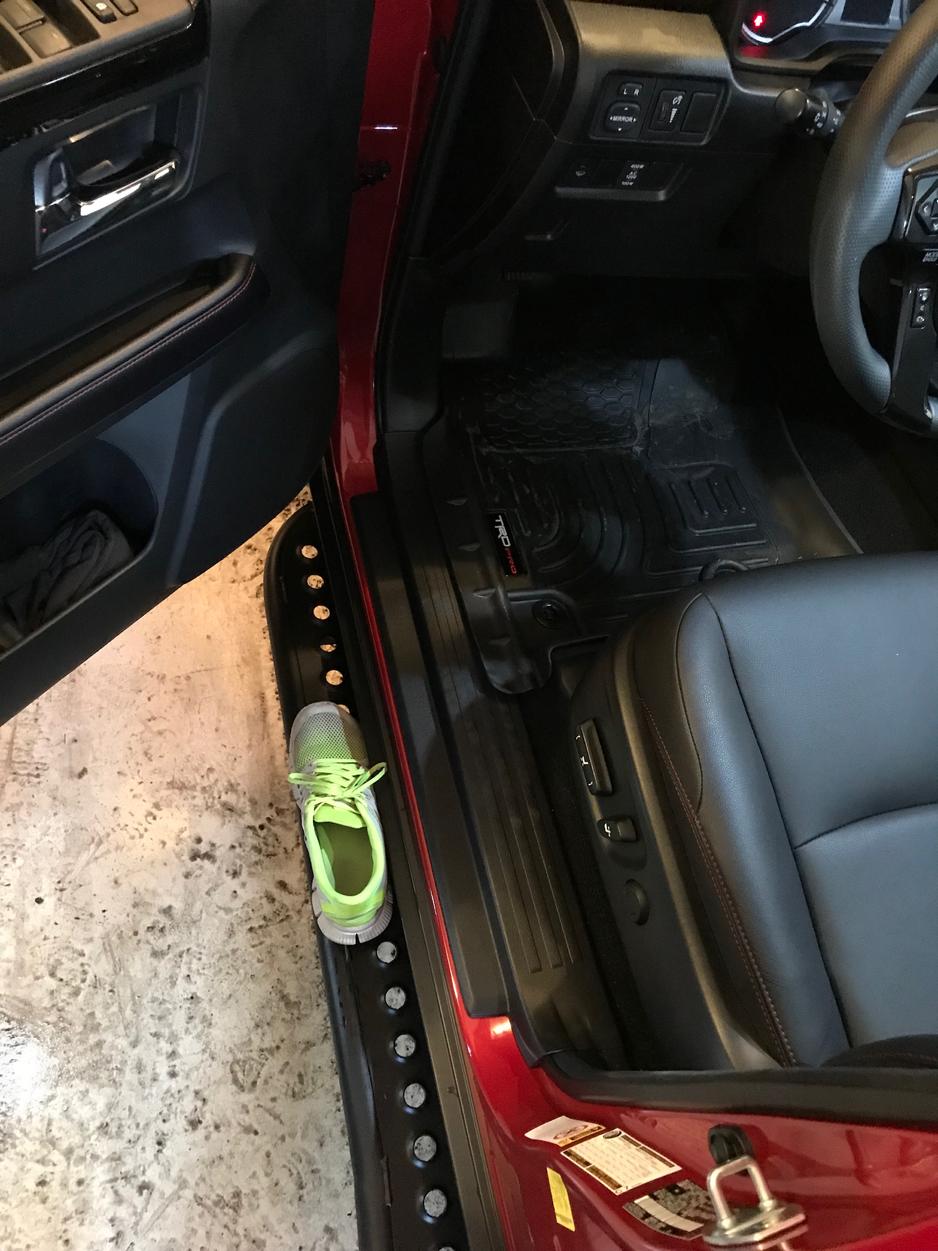

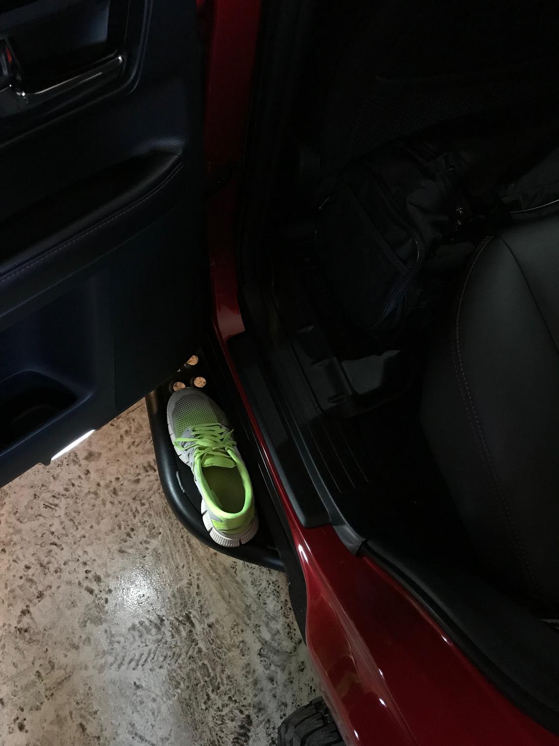

The few times I’ve gotten in and out of the truck, I can tell you that they help, don’t hurt. However, they aren’t big! If you’re looking for just a step, and you don’t off-road, go get OEM running boards.
I’m planning on taking some pictures tomorrow of how wide they are from a birds eye view with the door open!
EDIT: Here are some pictures of the sliders with a size 10 Nike shoe for reference of how big the stepping area is. All of the doors are open. You can see the step space in the front is not huge, but the rear kickoff provides a big surface.

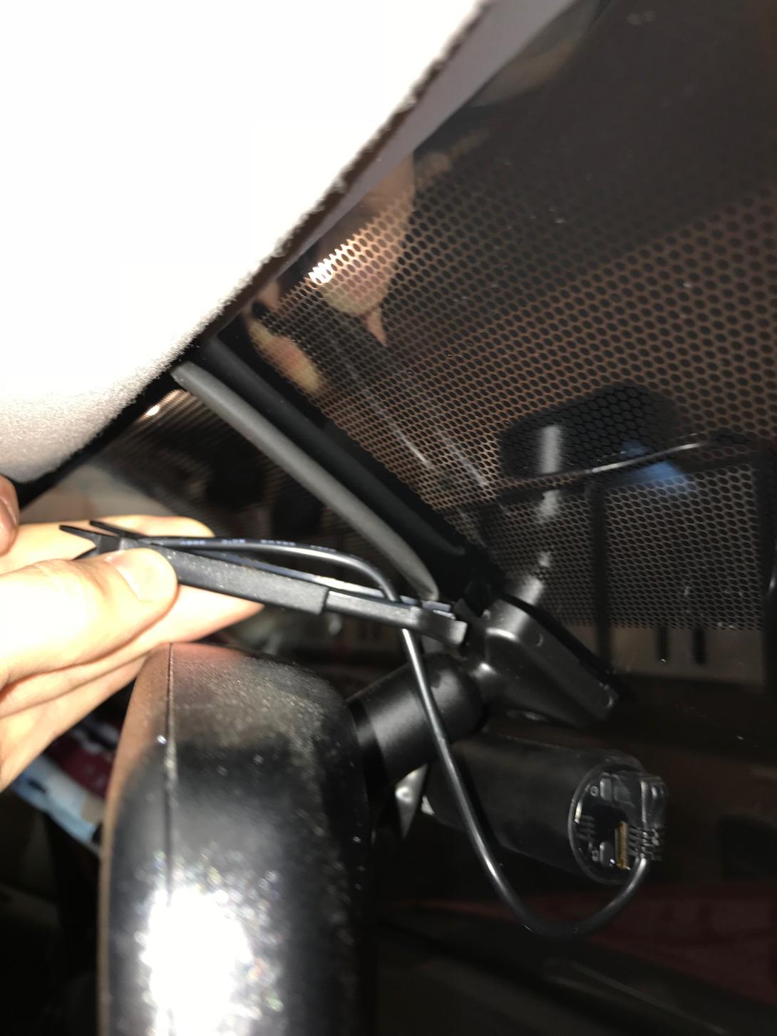

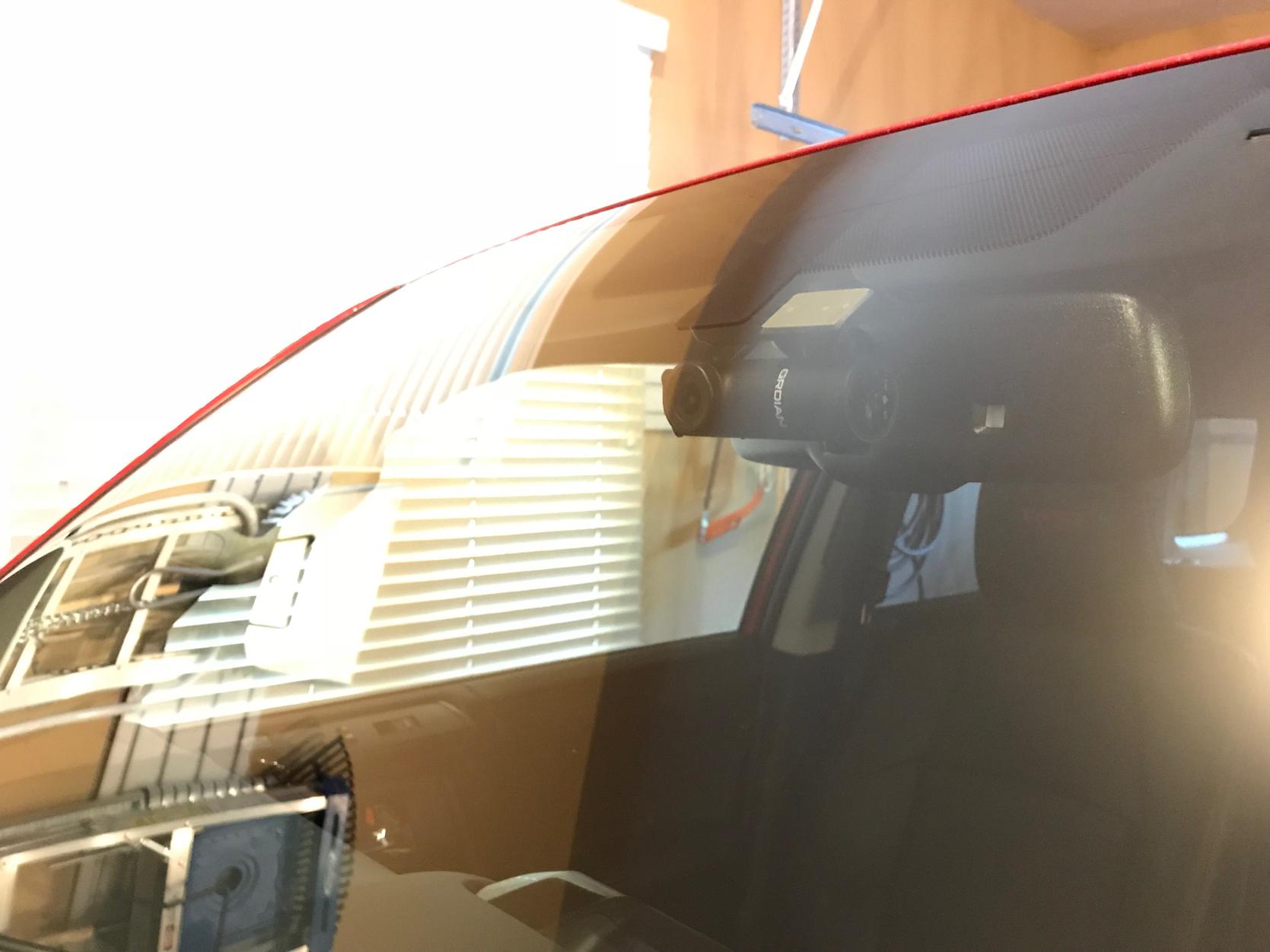

Grdian Dash Cam:
I bought a Grdian Dash Camera after I saw Lawndart posted about it on his Instagram. If he likes the quality, then I am sure its top notch! I have always wanted a dash cam, but just never pulled the trigger on one. After a close encounter with a very dumb pedestrian in a dark parking lot a few nights ago, I decided that it was time. I don't want to be liable for someones stupidity.
Overall, the camera looks great. The way I installed it makes it look factory, and its hardly noticeable. The video quality is pretty solid, but the iPhone app used to download videos is such garbage. I found that plugging the camera into my computer was much faster for downloading. It also blares this annoying jingle every time it turns on and off. It sounds like I'm driving an ice-cream truck! In the end, I am very happy with it, and glad I have another set of eyes always watching the road :wow:
Here are links to the materials I used:
-Dash Cam
-Power Converter to Hardwire Camera

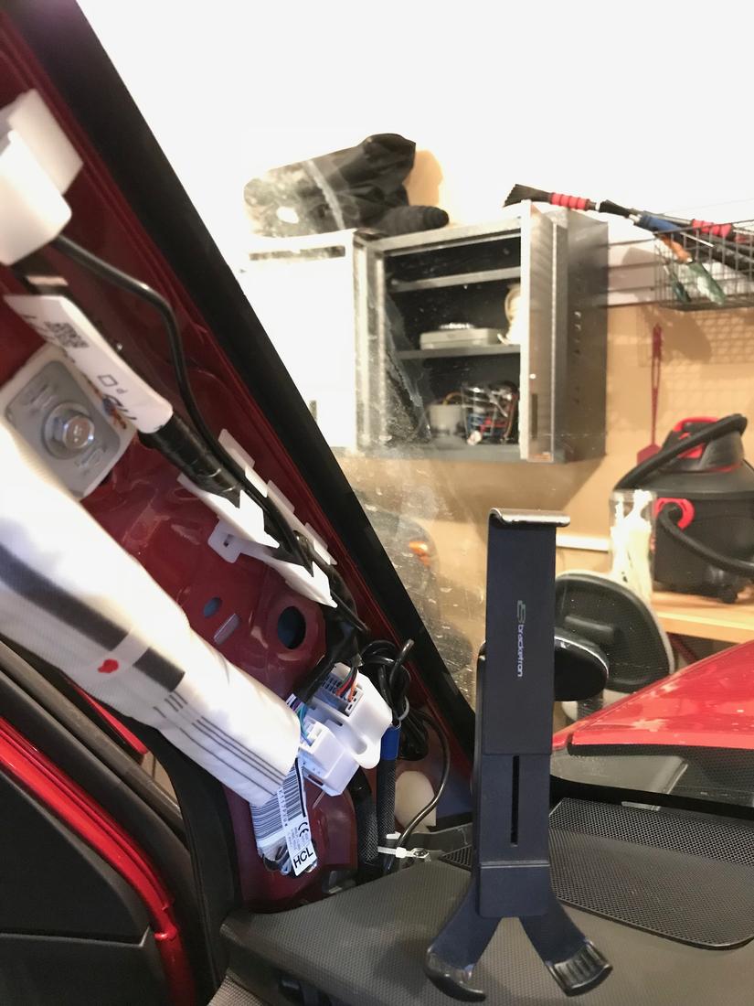

To Install (1-2 Hours):
1) Mount the camera in a position of your liking in the windshield. How it mounts will be dependent on the camera. Grdian uses 3M double sided tape.
2) Remove the small plastic piece that covers the wires running to the mirror.
3) Plug in the hardwire converter into the camera. Run the wire along side of the mirror wiring and reinstall the plastic cover.
4) Run the wire along the headliner towards the driver side A pillar (gently push the wire into the crease of the headliner)
5) Remove the A pillar cover by prying open the air bag sign with a pry tool/flathead screw driver and removing the 10mm bolt. Gently pry the sides of the cover and pop it off.
6) Run the wire from the headliner down the clips for the airbags wiring. This is important so that the airbag deploys properly if you are ever in an accident.
7) There is a small opening in the corner of the windshield and the dash, run the wires down behind the dash towards the interior fuse panel. I taped the end of the wires to a wire hanger and gently ran it down towards the floor.

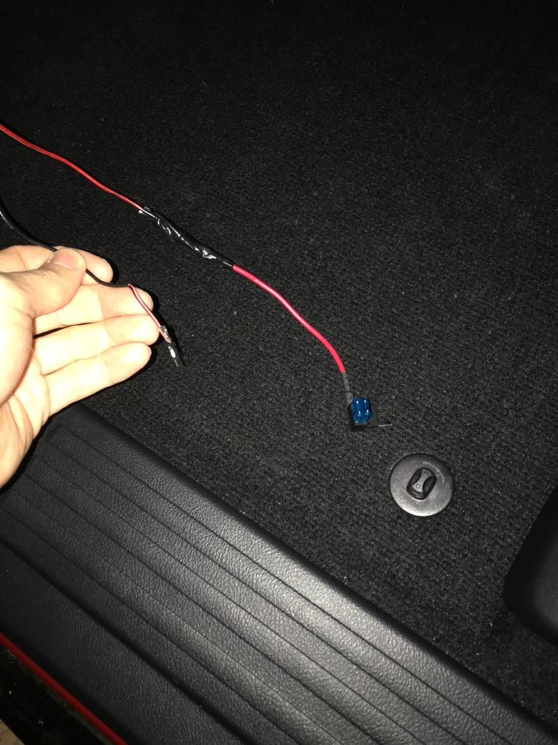

8) Ground the black wire to one of the bolts found under the dash. Crimp an Add-a-fuse to the red wire, heat shrink the connection, and seal it.

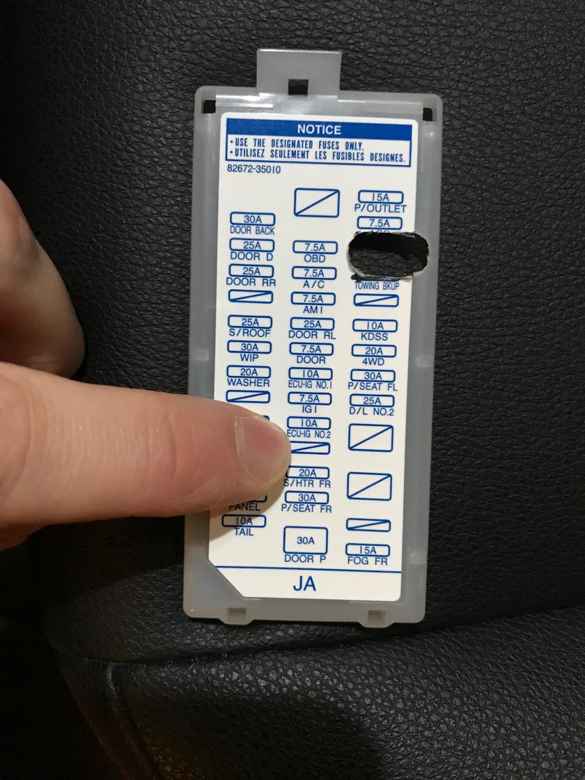

9) Plug in the add a fuse into the fuse (shown below). This is hot only when there is ignition, so the camera will only turn on when the vehicle is on.
10) Clean up all of the wiring, and reassemble the interior pieces.
Notes:
-I dremeled a hole in the fuse panel cover so I can still plug in the add a fuse with the cover on to protect the fuse box from water damage. The new hole looks very similar to the hole I drilled for the raptor light add-a-fuse.
-I mounted the hardwired converter to the side of the fuse box so it doesn't rattle behind the dash.

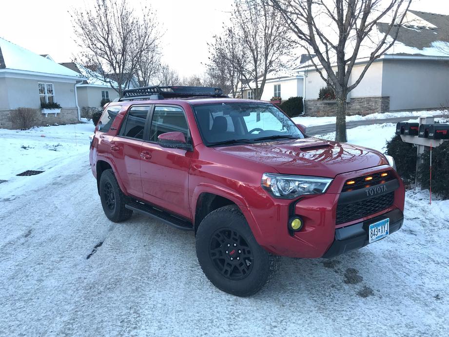

Here's an adventure!
Last night the Minneapolis area got 12 inches of heavy snow. As I expected, there were plenty of idiots out sliding around on bald summer/all season tires. I managed to pull a Prius and a couple other vehicles to freedom.
However, this was the big mama. An empty 18 wheeler was spinning his tires on a flat street. I hooked up, put the TRD in 4 Low and tried to help the best I could. DISCLAIMER: The only reason I tried is because I knew the surface was so slippery that I would never get traction and actually pull anywhere close to the entire weight of the big rig. I doubt that I even pulled to the tow cap. of 5,000 lbs. I would not have tried this on a dry/high traction surface as this is too much weight. Unfortunately, I didn't get him moving. That would have made for a fun story! As expected, I just spun my tires on the heavily snowed in street.
No harm, no foul. Plus, it made for a cool picture. :banana:
