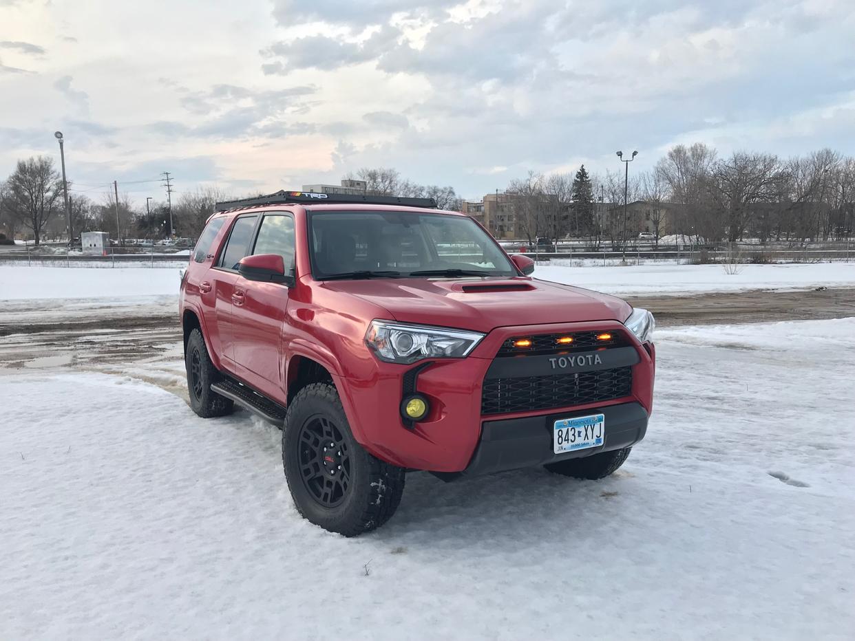

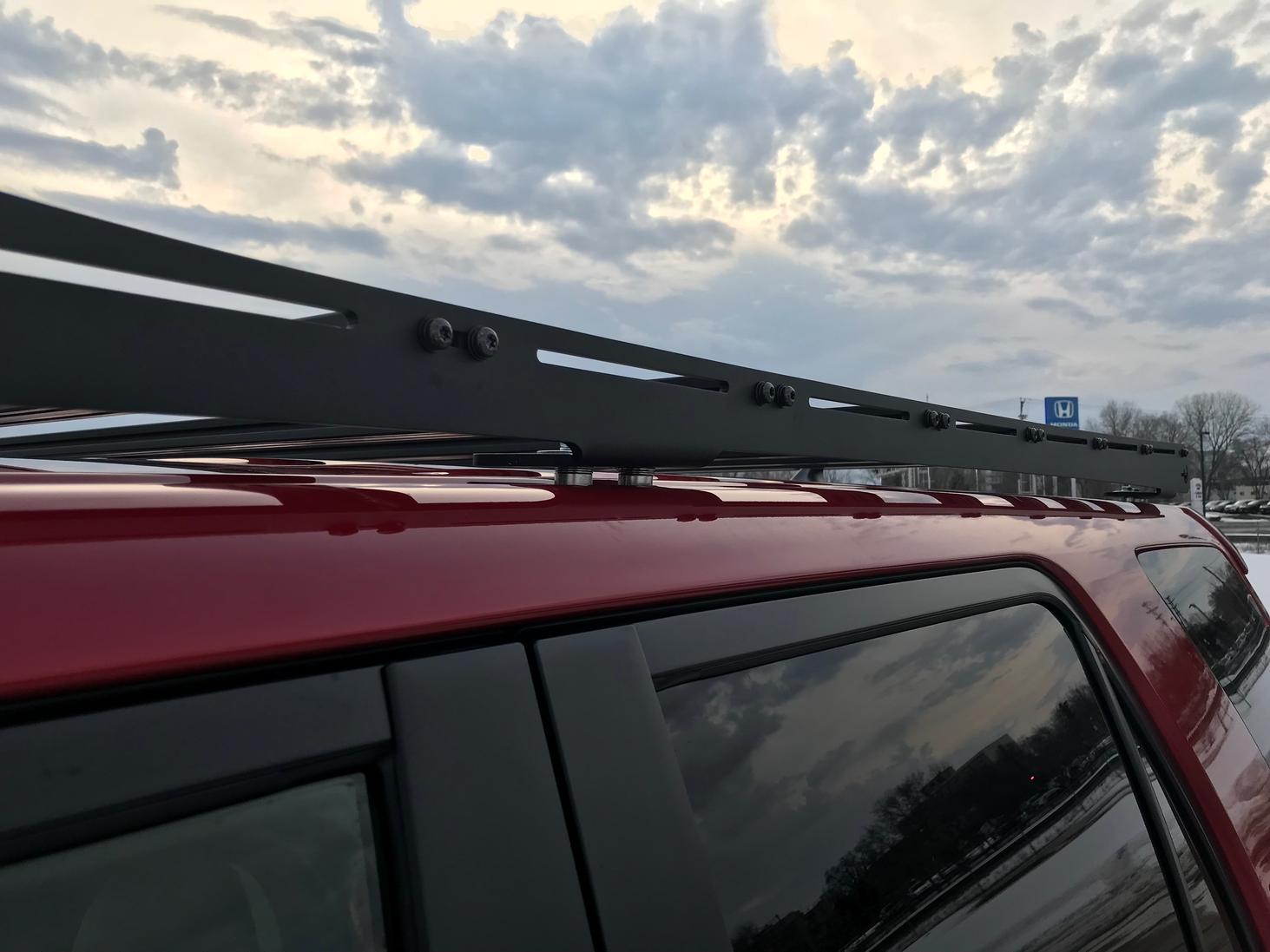

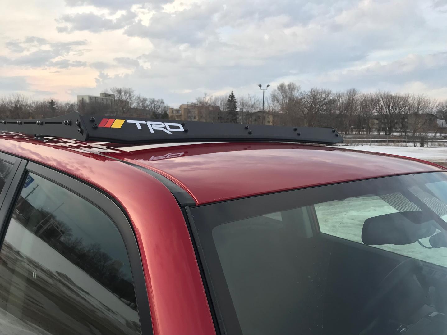

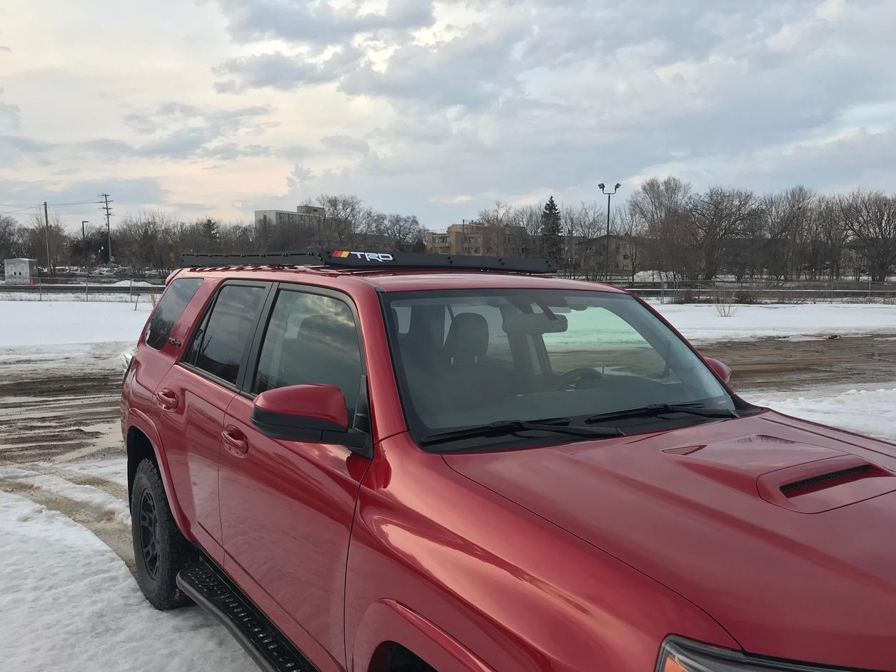

Prinsu 7/8 Roof Rack
This is a little upgrade from my original ROLA basket. While I enjoyed the look of the basket, it made awful wind noise and resonance that would shake everything in the interior. I found out it could be fixed in a thread that I started...but I had already bought the new rack.
I ordered this rack about a month ago and had the whole thing assembled the day it arrived. The shipping only took a week, but the last month has been hectic and crazy so it sat in the living room for a few weeks until I had time this afternoon to get it mounted. My first impressions are this:
1) It is a high quality, sleek aluminum rack. The whole unit is stout and has a great powder coated finish. Its functionality is second to none with the aluminum extrusions, allowing endless possibilities for attaching accessories.
2) The install is not flawless. I had to use many washers to shim the rack so that the front wind deflector followed the body line evenly without the aluminum extrusion hitting the roof. Even if I moved the front wind deflector up to the highest setting, I still would have used washers to shim the rack so it made contact with all of the spacers.
3) The wind deflector does not follow the roof line very well, as you can see in my pictures. This was my biggest disappointment because I purchased a rubber trim piece so the deflector could make contact with the roof so that wind was diverted over the rack, rather than under. I even laid down a piece of 3M clear bra so that it wouldn't scratch the paint.
4) A quick cruise on the highway proved that it is quiet. It makes a little bit of wind noise, which is expected, but it is much quieter than the ROLA basket. No vibrations, minimal noise, that's a win for me.
5) Overall, I like the rack. I like the design and how sleek it is on the roof (for the looks and the wind noise). I like that it is lightweight aluminum, and it uses aluminum extrusions (no rust!). I really liked the shipping time. I ordered, 7 days later it was on my doorstep. Lastly, I liked the price. Much less expensive than a Gobi/Baja rack.
I am not going to write up install instructions because it's self explanatory, and they are on Prinsu's website. Enjoy the pictures of the newest addition!
