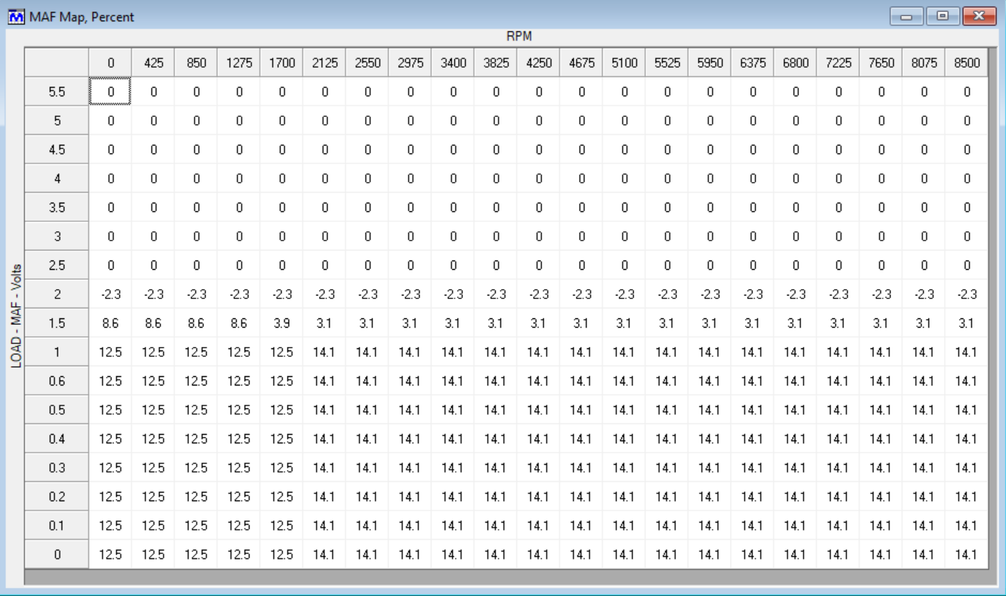

When I asked how they felt it went (when I picked it up) they said that they felt the factory ECU was fighting the tune -- that the fuel trims weren't good. I would agree. In downloading the maps (attached) I think I understand why: there is no O2 map (it's all 0s). I'm also not sure what the MAF map is doing based on the way it's set up.
If I knew the target AFRs for their work I think I could create one now and try and bring the fuel trims under control. I've noticed that when the fuel trims go gonzo after a boosted run that the AFR lingers low (12ish) and meanders back to stoich.

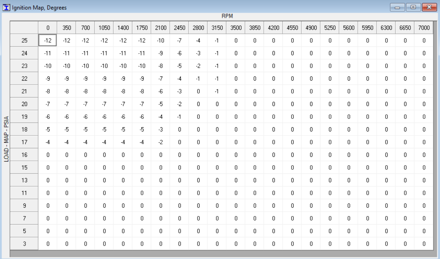

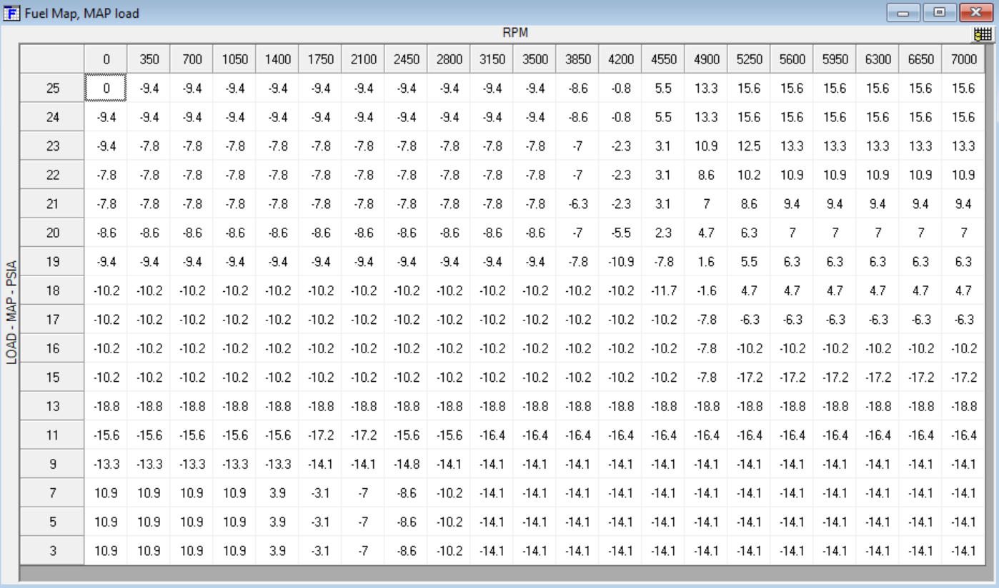

I have no experience with MAF tuning, just isn't needed unless you have a larger intake than stock. The fuel trims are probably just fine, but know that the ECU will tune it all out except for the open loop ones in high boost.
The ECU is most definitely fighting the tune, and will de-tune all but the open loop portions at Wide Open Throttle (WOT).

What are your fuel trims sitting at? I've tuned an Apexi safc piggy back on mitsubishi's back in the day and could get fuel trims pretty close to 0 or 100.
If your on stock injectors and fuel pressure the fuel trims should be fine since the ecu will take care of that. Just make sure lo and mid fuel adjustments are not changed. Only open loop map should be adjusted.

They’re like -20, -15 ... stuff like that. Stock ECU is effectively detuning my professional tune because there is no O2 map. I am running 380cc injectors so these #s aren’t surprising.
Trying to figure out where to start with the O2 map. I suspect since my truck has a wideband O2 sensor (Vs Narrowband), the values I need are in the 0-5V range. Wouldn’t I effectively be trying to tell the truck it’s 14.7 AFR throughout the closed loop? (What am I missing here?)
Yes, you have a Air/Fuel ratio sensor, not the narrowband like I have. Watch this video by AEM: https://www.youtube.com/watch?v=GZNDCT9UjQQ this is exactly what you need to do. Once you've figured out the voltage input for each AFR level, simply just put in the AFR you want in each cell. Voila, perfect AFR trims in closed loop. Done.
I've found my engine responds well with 13's in low boost after say, 2 PSI up to 5 or 6, 12's up to 9 PSI, and 11.8 from there on up. Adjust for whatever boost levels you see. Don't go too rich below 3000 RPM's though, it'll bog down the engine.
There's a bunch of how-to videos put out by AEM on how to use every feature of the FIC 6. I suggest watching as many as you have time for.
Not sure of the exact numbers, but when you want it to run rich, you'll need to trick the computer into thinking it's lean, not stoich. So you'll need it to output voltage at what would normally be something like 15.5-16:1. This will trick it into adding more fuel and thus, your fuel trims will begin to go into the + fuel range (or higher than what it was at). Mine routinely run around +10-15% when I'm in boost and it's working properly.
