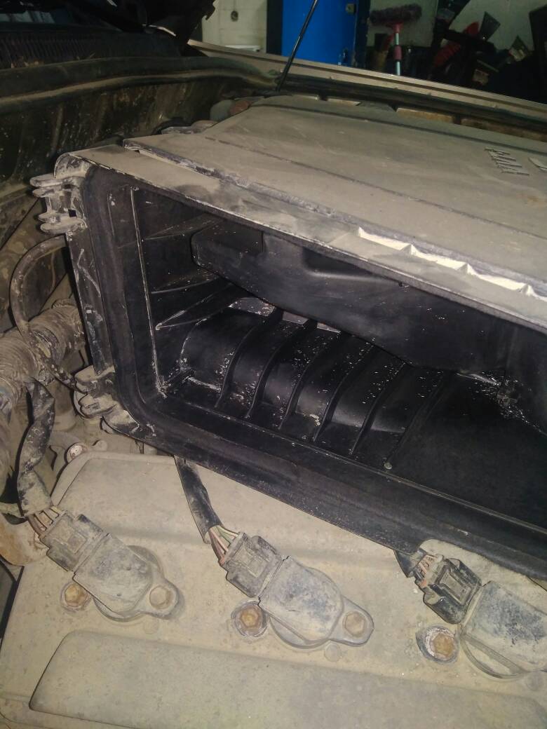

Found somthing disturbing last night while working on my truck. I have a snorkle and therefore I have ram air effect in my intake.
I pulled engine air filter AFE out and noticed a lot of fine dust inside my airfilter box and obviously I wanted to find out why.
So I found that drop in filter is smaller then stock toyota filter and when you insert the housing at the back and use front clips to lock the housing in place that afe filter moves to the front of the housing and thus creating a poor seal at the back of the housing. So I cleaned the housing and applied felt tape between the main housing and filter, hopefully this will stop free sliding of the filter inside the housing when it's being locked during filter installation.
Anyway, this whole thing sucks because I have no idea how much crap was ingested by the motor over 30-40k that this filter was there.

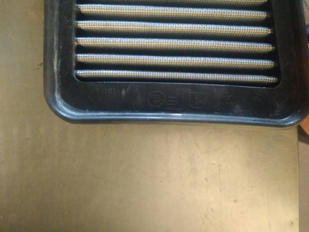

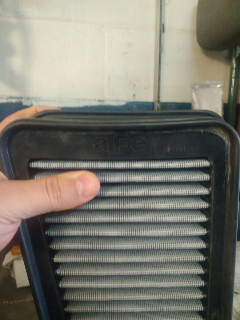

So I have swithed to regular filter and I took time to take pictures to show my inspection results.
So AFE filter was not a tight fit at all and had collapsed side which allowed a free bypass for dirt.
