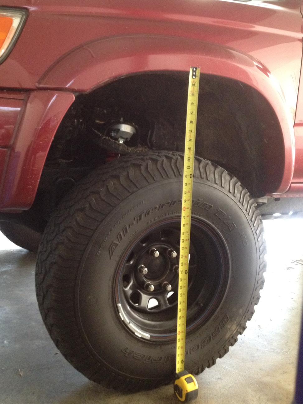

Pic I had from the past will have to measure what the current height is

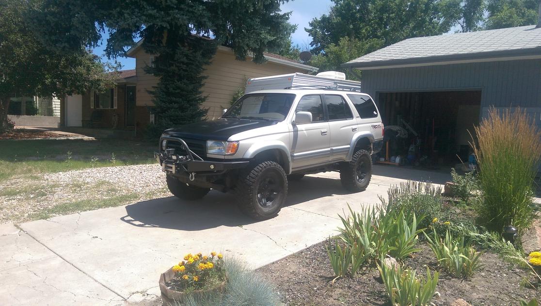

Holy front lift Batman!!!!!!
Here is mine with 3" front and 1/5" buddy lift. Even from far you can tell you have inches on me.

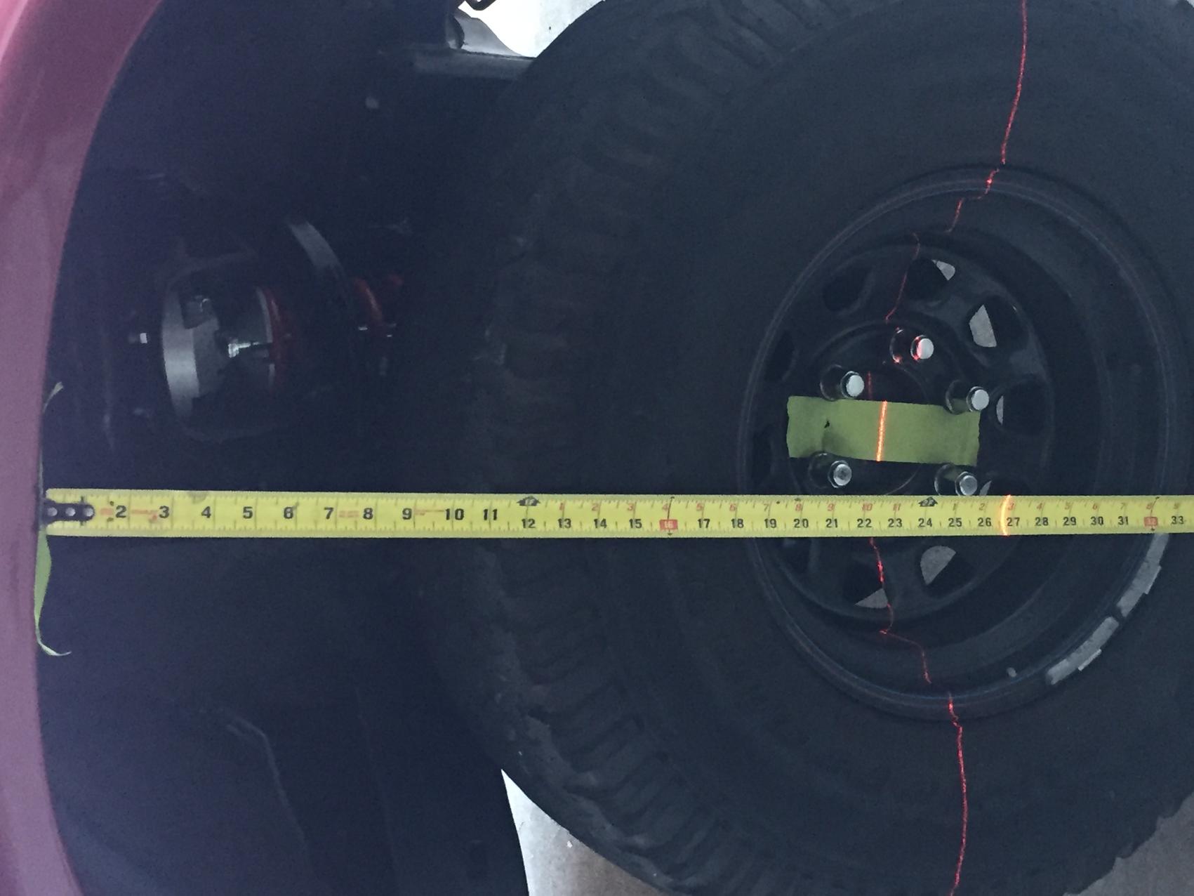

Ok so I got my truck back today. So you said I should be at 25" from the top of the fender to the center of the hub at regular ride height. So looks lik a am a little high! Tell me what should the measurement be at full droop? I'm not working on a lift so finding level ground is sorta of difficult. Can you walk me through the steps on how to level your truck please?
