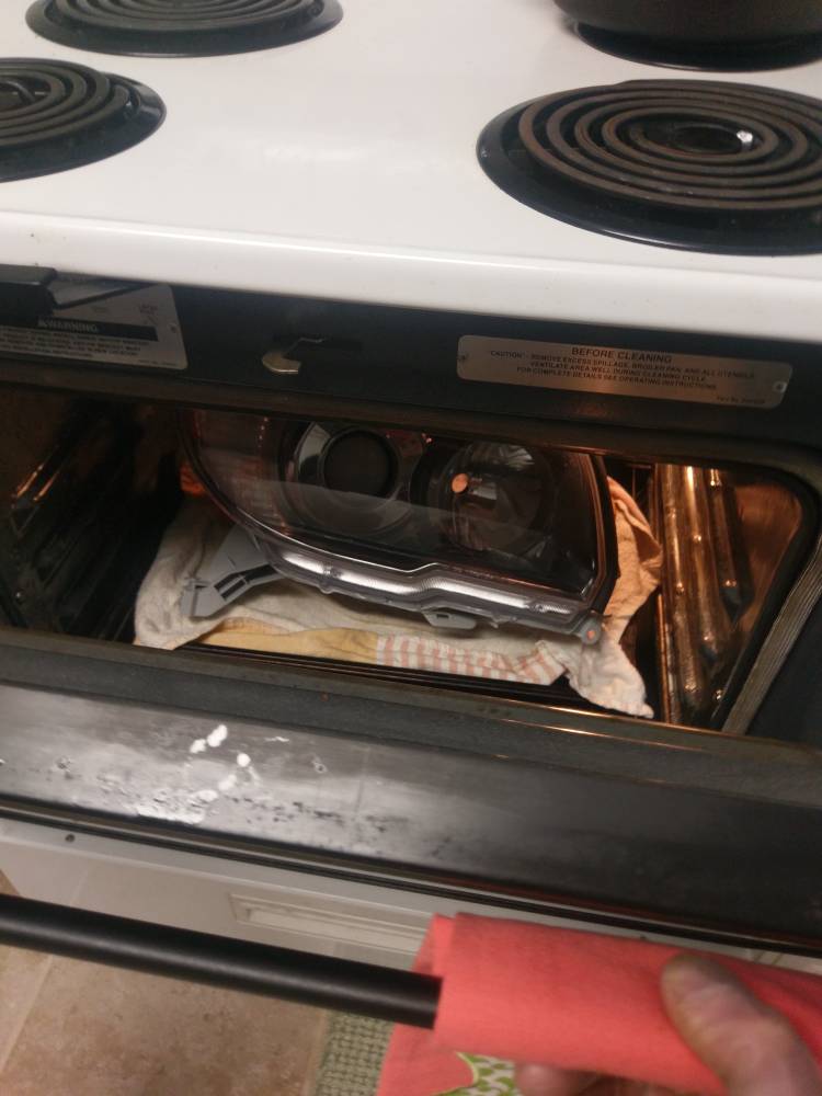

I should have known when the forum retrofit guys said "bolt in" it meant less than 10 hours of dremel work! [emoji23] I ended up attempting this retrofit on the Eagle Eyes brand headlights because I want sport smoked chrome housings, clear lenses, and a non broken tab. So far so good.

Careful with the towel,someone on a Taco forum apparently set the towel he had in the oven on fire while baking a headlight.
if you used oem housing, i dont think there is alot of work involved. towel in the oven is all bad, you can just set the lights on the rack, just make sure its not the lens on the rack. 250 for 10 mins is all you need.
