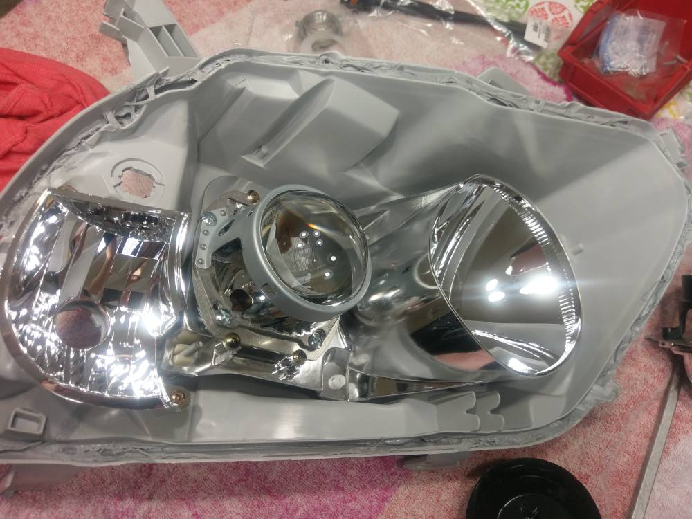

Yes I suspect the casting dimensions might be a little tighter on the Morimoto's so it was some pretty minor shaping of the brackets in 4 places to get it to sit flush on the mounting flange and get 4 bolts through it.
if you used oem housing, i dont think there is alot of work involved. towel in the oven is all bad, you can just set the lights on the rack, just make sure its not the lens on the rack. 250 for 10 mins is all you need.
I'm just picking about the amount of work it is, I never thought I'd do a retrofit due to how complex a full custom one could be. I'm a nut and bolt kinda guy, shaping/fitting and epoxy scare me.

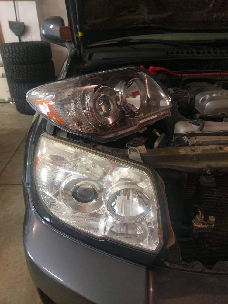

I should be able to reassemble them tonight, figure out the bulb holders, how to seal around the bulbs, then just waiting on d2s-amp adapters for reinstall Thursday! Thanks again for everyone's help!
Thanks for all the input guys! I got G5-R projectors (seemed like a good value on a quick YouTube end review run), morimoto bulbs, brackets, and high beam splitters from lightwerkz on the way. I'm going to do the swap on my OEM housings since they are on the work bench already, just need to fix one tab. Then I'll decide which d2s to amp adapters I need when I get closer to install and reuse my existing ballasts. Oh and clear wrap the lenses. Should put me into this project for around $250 plus the aftermarket sport lights I bought and am running now. I could sell those or do another retro for fun!

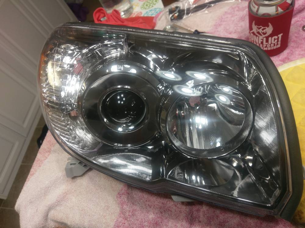

I used "Eagle Eyes" brand housings with only minor fitting issues. I ended up grinding some tabs off the projectors themselves but all the bolt holes lined up to fit g5-r projectors in adapter bracket just fine.
Finished product

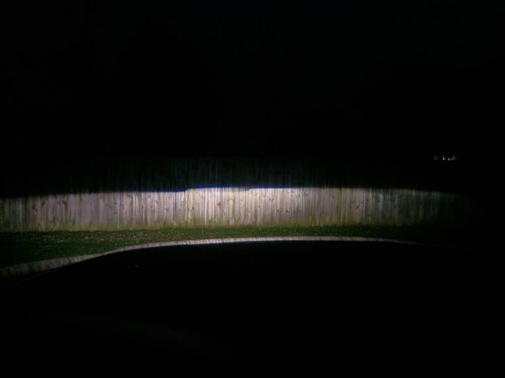

let see how low you can adjust these without the projector touching the shrourd.
3 inch drop at 25 feet
good start since you are lifted that high.
They were adjusted wayyyy low when I installed them. This is a 2" drop at 25 feet on a fairly level surface (wavy back yard) but I'd like to get a more uniform surface to dial them in better, I do think they are slightly too high now but no flashed this morning on the way into work.
do 3 for your lifted truck, if you started at 2, its still too high.
Agreed. My headlight height measured at the projector itself is about 43" (super rough measurement on sod). I set at 41" at the fence at 25 feet, I'll lower them a tad on a better measuring surface.
