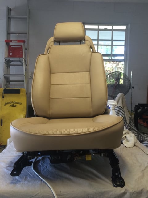

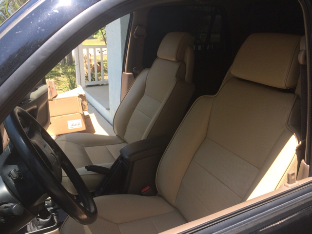

If you don’t mind a little work, is very possible to modify many kine seats to work....I replaced mine in 02runner last year...but usually end up doing most of my vehicles at some point....
Lmk if want tips for the 3rd gen...

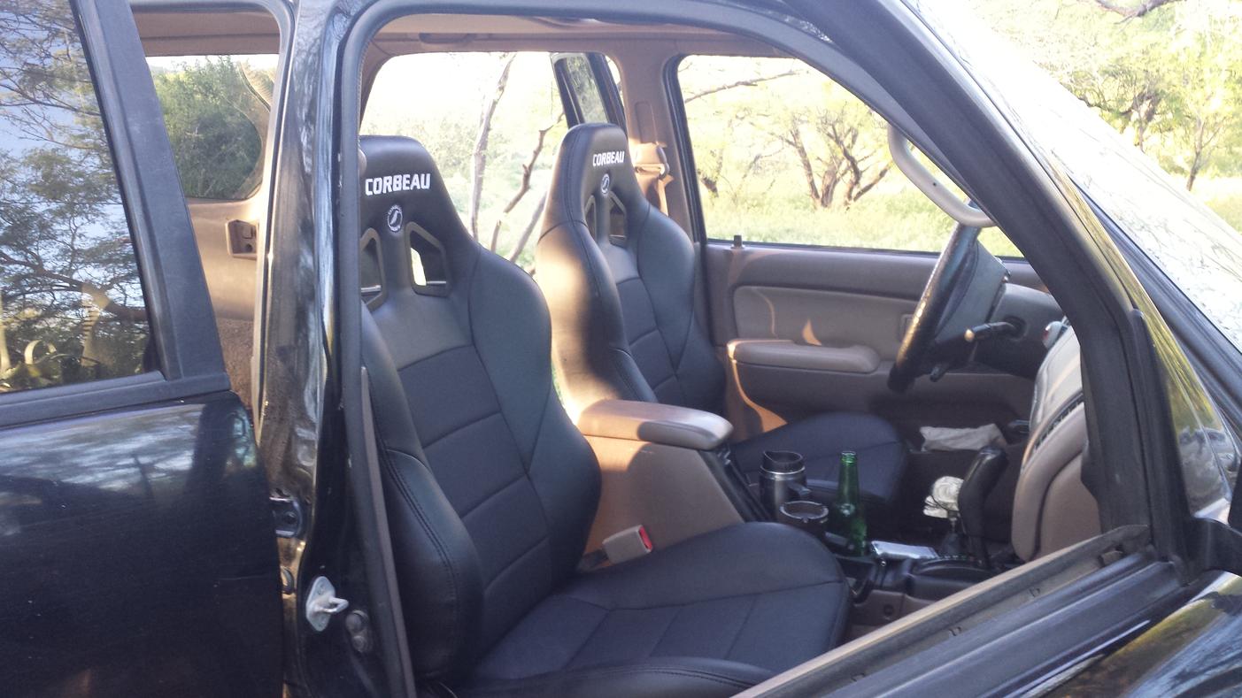

it is very possible to mount "universal" seats. Amazon/ebay.
what i did, was remove the feat from my stock seats and used them for the new ones.
the universal sliding tracks were WAY TOO NARROW.
so i installed just the stock feet, made sure they were level, and bolted a flat steel bar across the front and another across the back. i then drilled and bolted the universal sliding tracks to the flat bar and called it a day.
